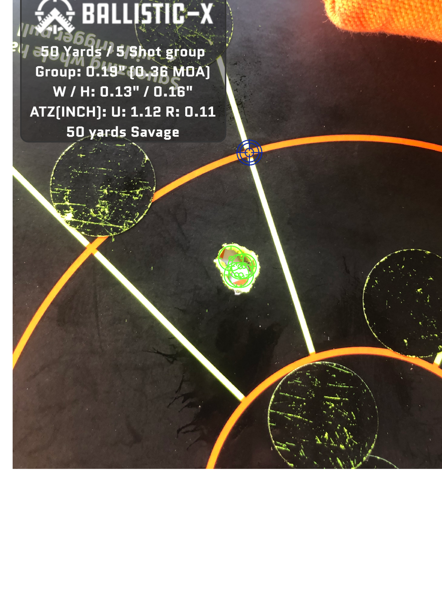

Shot the factory Savage barrel today post Tubb TMS (Throat Maintenance System) treatment. Those huge speed variations are all gone!!!!
Barrel was deep cleaned after TMS treatment, so needed to shoot a few fooling rounds. After deleting the first 5 shots (slow, no copper in the barrel yet), i got an SD of 8.7 fps and an ES of 33 fps. Better than the 105 ES i saw before... when the barrel got retired.
Might need to adjust my load, not inside of the old node anymore... slower than before.
Groups (three shot) were 0.25” to 0.55”. Mostly me aiming poorly i think. The gun shoots!

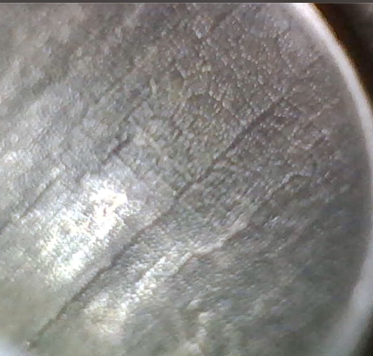

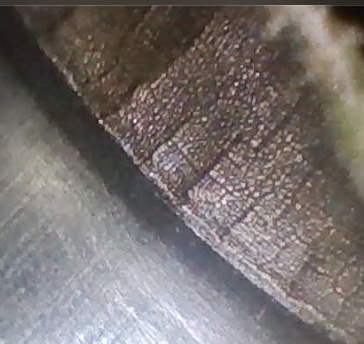

i probably did not clean often enough, which allowed a carbon buildup in the neck area of the chamber. That alone could explain the erratic speed... Cleaned around every 150-250 shots... What is ideal?
First pic is the freebore “before TMS” taken from the chamber side, second pic is “after TMS” taken inside the freebore. Raised areas have been (mostly) removed, and the shine was not there before. Used the Teslong bore scope.
Just an update post carbon ring removal. Factory Savage barrel with 2,800 rounds doen the pipe shot 0.36 MOA and 0.5 MOA five shot groups this weekend. Also SD was below 9 for 35 rounds.
Erratic speed issue (100 fps or more) is completely gone and group size is back where is used to be. I think i retired the barrel too early. Mistook the symptoms of a carbon ring for a worn out barrel.
I realize the barrel might only give me another 200-300 rounds of high accuracy, and so i intend to use it as a long range hunting rifle only. No more plinking duty for this one!
$50 bore scope paid for itself already. I now also clean my chamber differently from before (rotate an oversize bronze brush in the neck of the chamber and a good carbon solvent every time the rifle gets home).
Just an update post carbon ring removal. Factory Savage barrel with 2,800 rounds down the pipe shot 0.36 MOA and 0.5 MOA five shot groups this weekend. Also SD was below 9 for 35 rounds.
Erratic speed issue (100 fps variation or more) is completely gone and group size is back to where is used to be. I think i retired the barrel too early! Mistook the symptoms of a carbon ring for a worn out barrel.
Very happy camper!

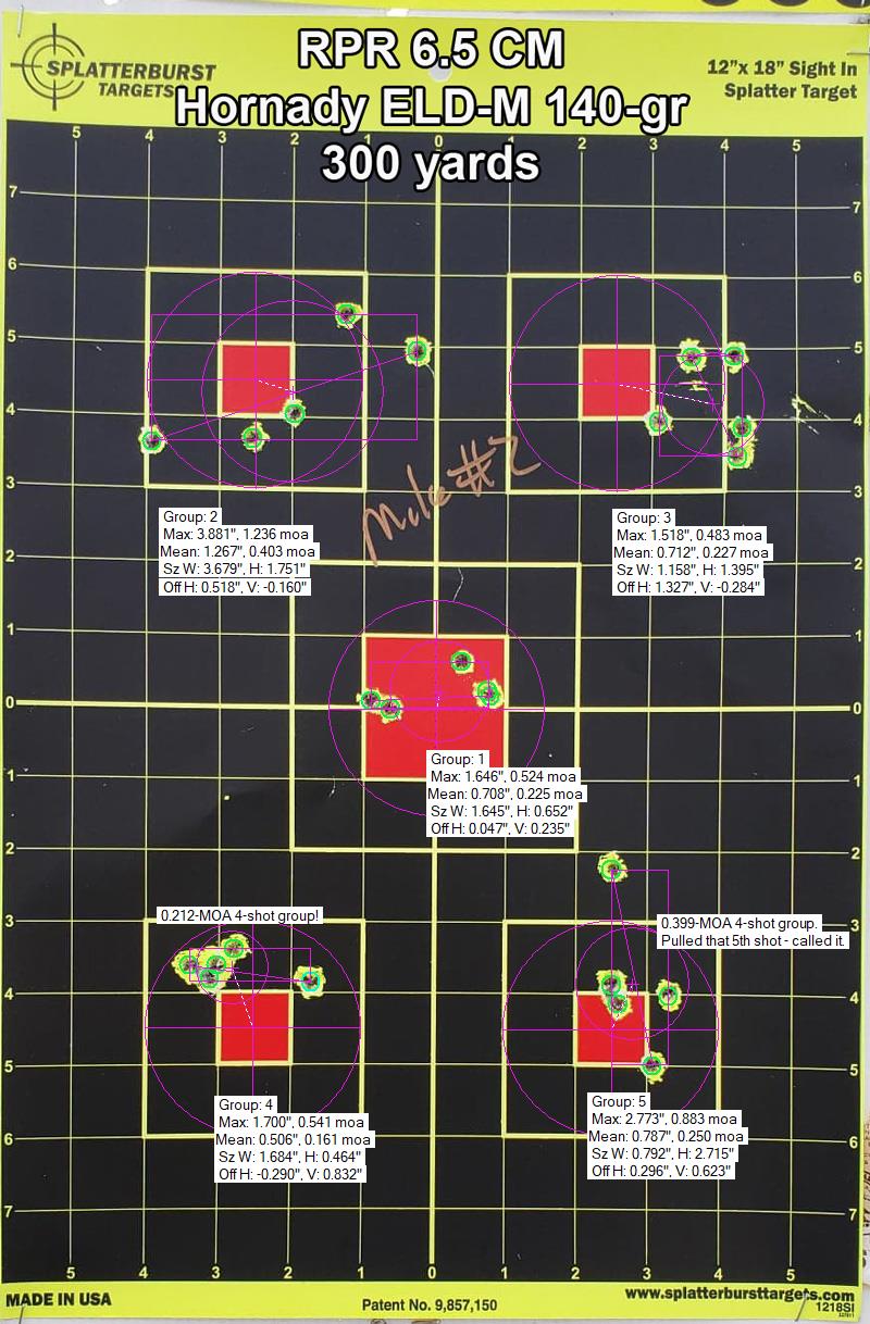

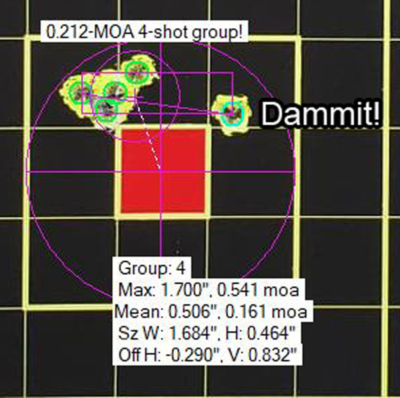

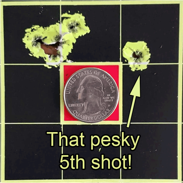

3800 documented rounds through my RPR 6.5. I've done light cleanings every 500 rounds, or so.
I shot this group at 300 yards last Sunday.
Another way to look at it. :-D
Admittedly, not all my groups looked like that. :) Here's the whole target:
But, it shows what the rifle can do, when I do "my part."

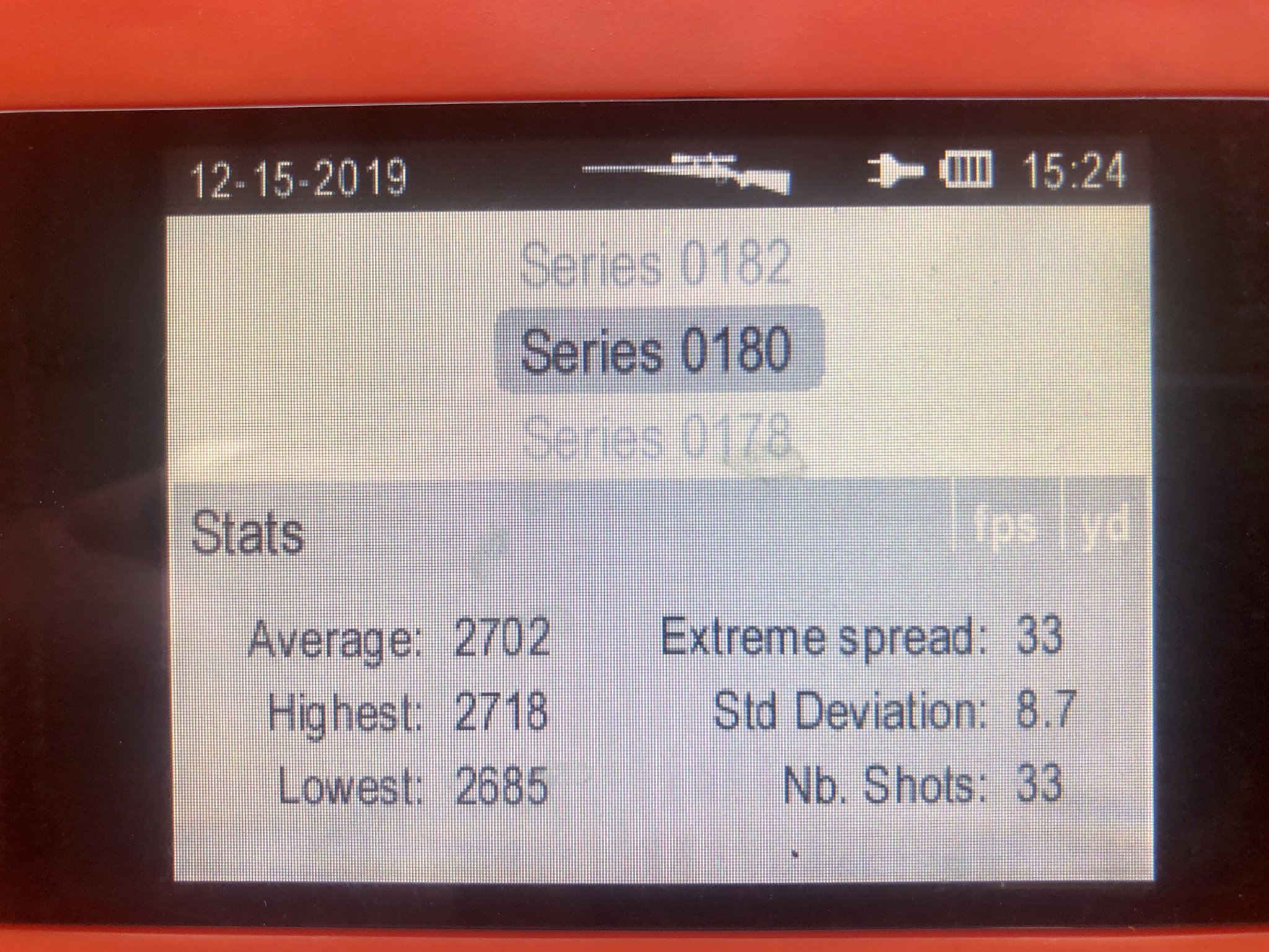

I don't have a specific idea of when I'll retire the barrel. I guess when it's obvious that something isn't right with it, and my groups are not consistently decent. That, or it may just be when I'm ready to see what a Krieger barrel will do for me. :)
I'm not a competitive shooter (nor a hunter). I'm pretty much a recreational shooter that enjoys testing myself, seeing how accurate and precise I can get. I generally shoot prone at paper targets.
I've shot all factory ammo. Mostly Hornady ELD-M and Federal Gold Match Berger. I occasionally chrono the ammo, and I've seen a drop in velocity. But, I haven't really seen a drop in precision... My groups are still pretty good. If I do my part, I can shoot sub-1/2-MOA. I think that's still "crazy good," considering the "budget rig" I have and that I'm not a "pro" or "expert" shooter.... and mostly self-taught. So, I really haven't seen a drop in accuracy or precision.
I don't make any special effort to keep the barrel cool. I shoot "at will," pretty much. I shoot when I'm ready. I don't intentionally slow down. I like shooting. When I get a chance to go to the range, I want to shoot... a lot. :) So I go as fast as I can while maintaining the fundamentals and group nicely. So, sometimes the barrel can get pretty hot, especially when you add the Florida sun.
Edit to add some numbers.... For what it's worth....
Back in August 2018 (round count ???) my chrono numbers:
Hornady ELD-M 140-gr
AVG: 2662
SD: 9.6
ES: 27
September 2019
AVG: 2590
SD: 22.9
ES: 80
But then, also September 2019....
Berger Target Hybrid 140-gr
AVG: 2703
SD: 15.6
ES: 59
I've got just shy of 2700 rounds through my barrel. The vast majority of those have been loaded with 40.5 grains of H4350 and topped with a 140 ELD-M. Haven't lost any velocity since I first worked the load up at about 100 rounds through the barrel. Still easily sub-1/2 moa. Was shooting over the weekend and could still consistently break clay birds on the 600 yard berm while fighting some varying winds.

Here’s a situation. I have 3 matches left this season that I’d like to get through. Two local 1-day, and one 2-day. So let’s say 400 rounds worth of matches shooting. I’m running a custom Tikka T3 with a Rock Creek 6.5 Creedmoor that has 2,200 rounds on it as of now - but it’s still hammering and velocity is excellent.
I ordered a Benchmark to replace my Rock Creek, but I don’t think I’ll get it in time for any of the upcoming matches due to backlog. Do I just bring a .308 gas gun as a back up? It’s all I have 🤔
Just run it and worry about barrrel life when the matches are over. Get the round count out of your head or you won’t enjoy the matches because every miss you’ll start to think the barrel is crapping out on you. Go shoot, enjoy talking to other, and have fun.
Reactions: Billiam1211
Yeah shoot it. My last barrel I was in a similar spot and just kept shooting it and it’s around 2800 rounds now and still doing well as all I shot through it is factory ammo and the velocities were lower in the mid 2700s.
Reactions: NamibHunter
Do different barrels have significantly different life? I understand cold hammer forged barrels are considered to be more durable than others. Would we expect more rounds out of them before they loose fps and accuracy?
I have now exceeded 3,000 rounds last weekend.
I think the Tubb TMS treatment helped, but it could also be the deep clean and removing the carbon ring...
Most sites claim 6.5CM barrels will last about 2,500 rounds. Glad to see some folks are getting more.
With a 6.5 Creedmoor, perhaps a frequent enough cleaning to hold down carbon build up in the first place might help barrel life? Not necessarily talking about vigorous bronze brush scrubbing either.
