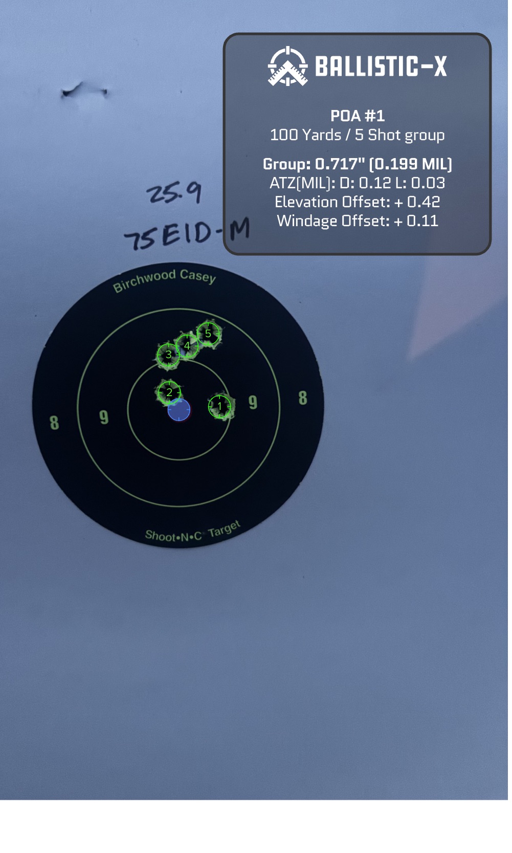

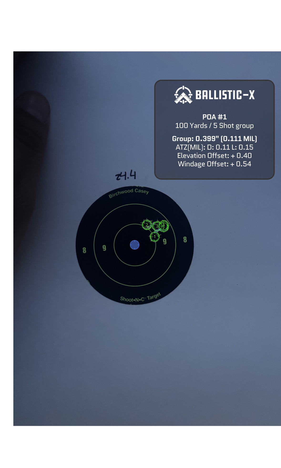

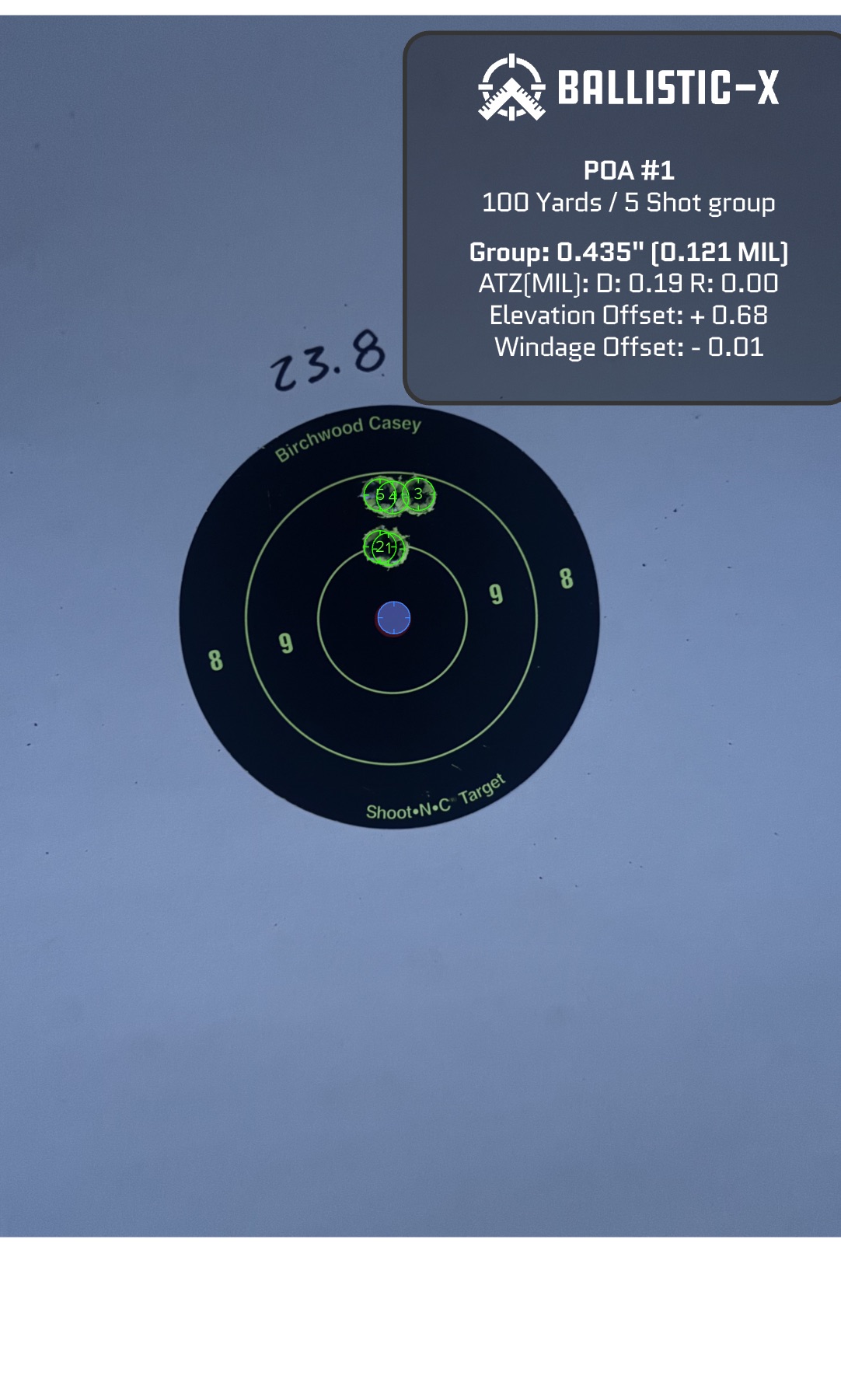

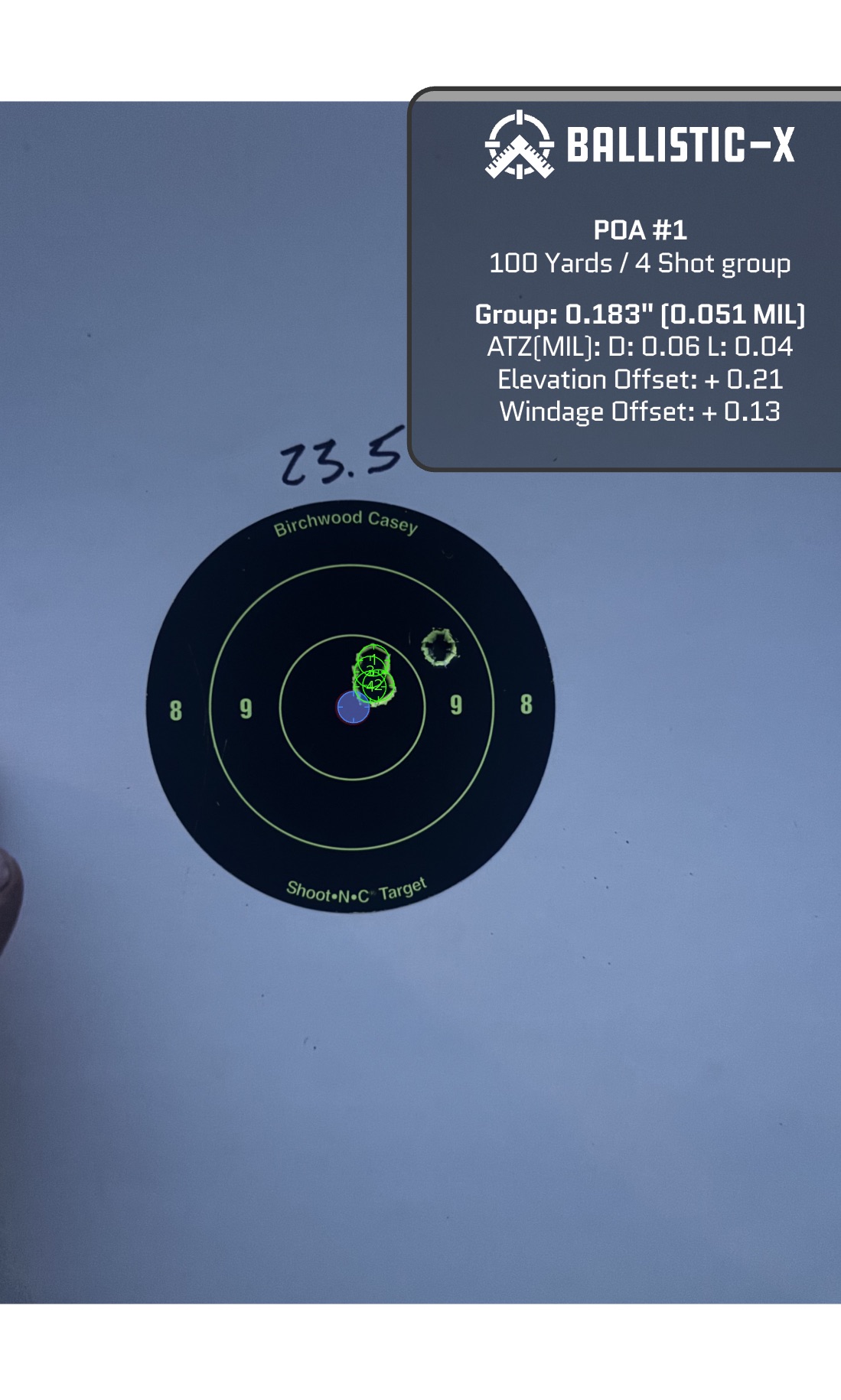

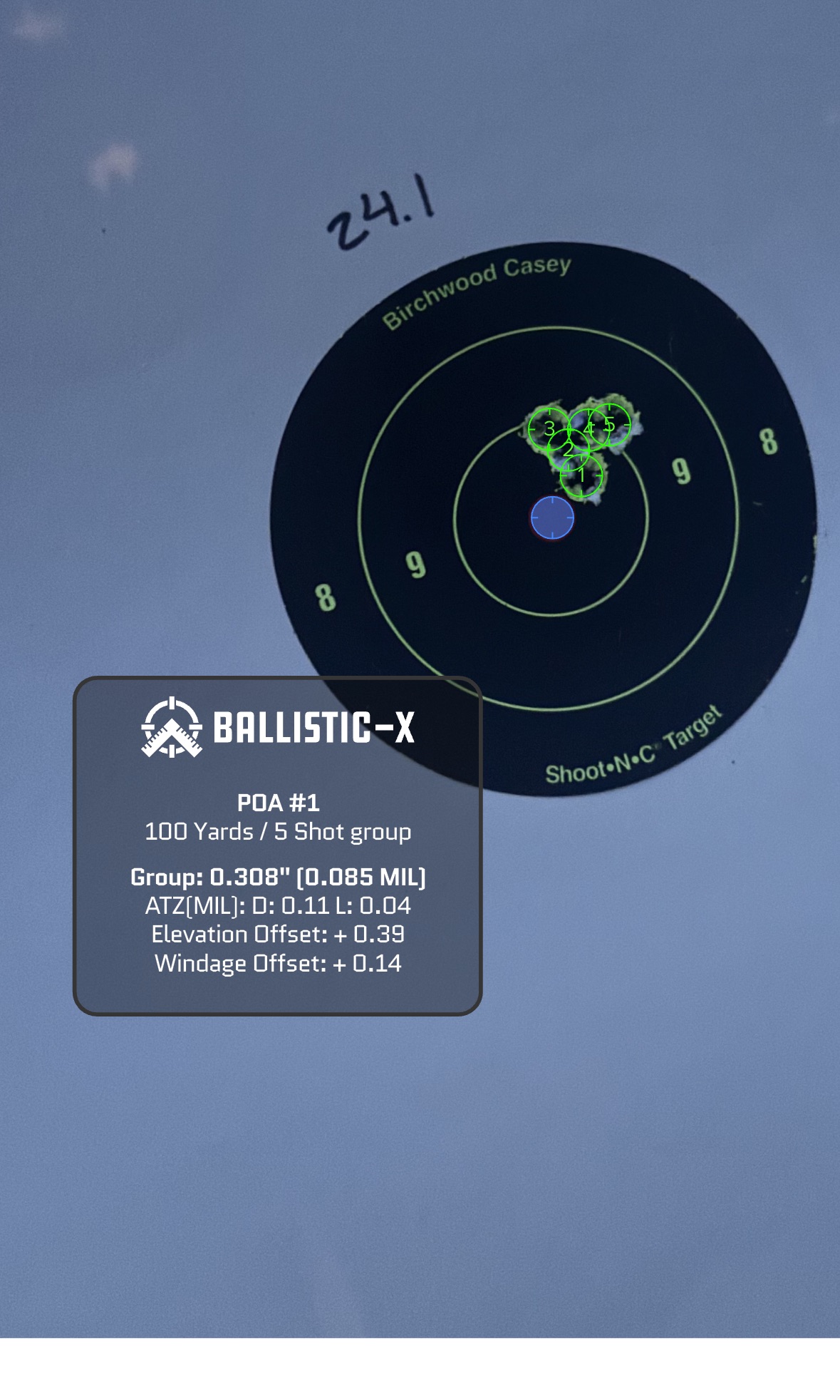

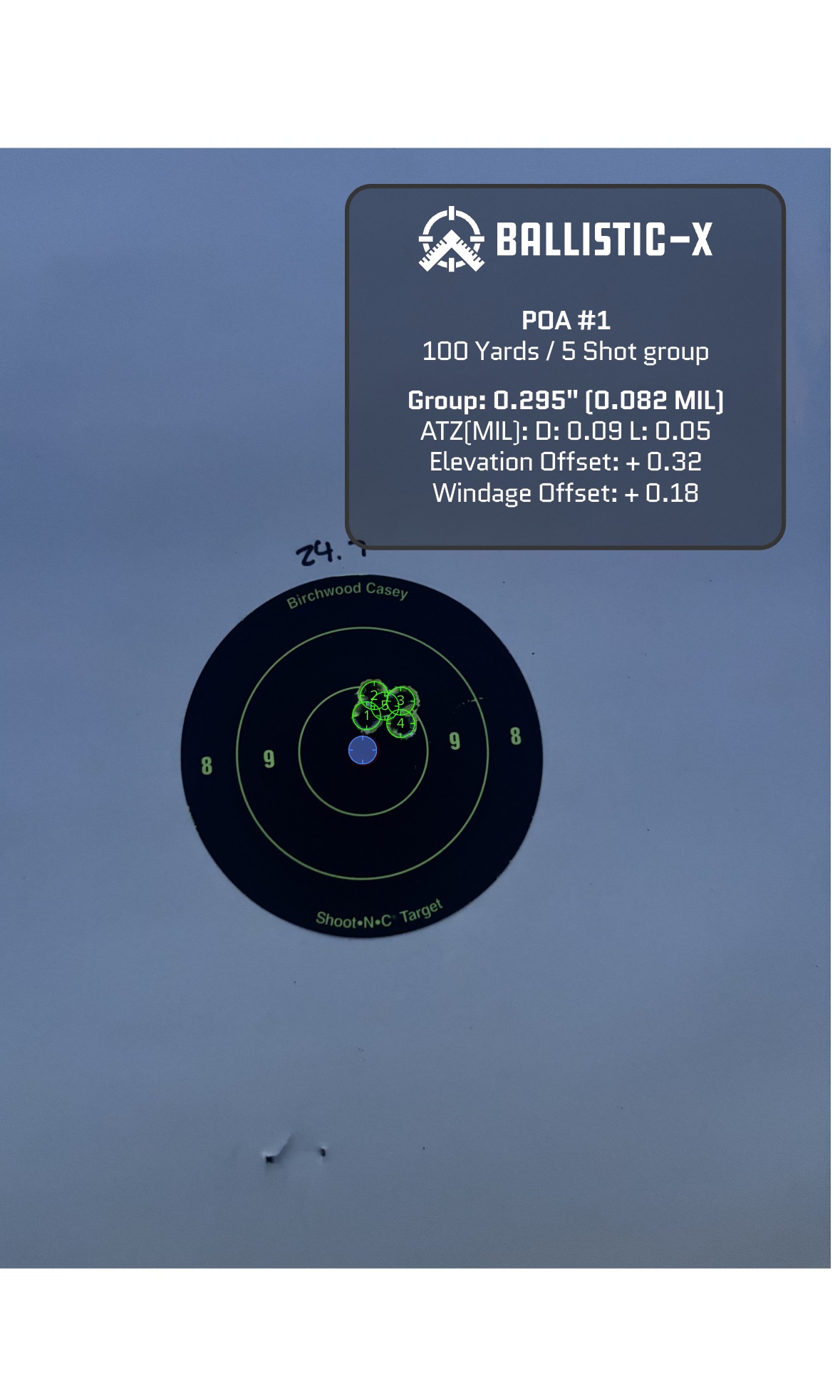

I was able to actually shoot slow groups today and pull my target for measurements and I’ll say the match chamber with 80SMK’s definitely impressed me and even the 75ELD-M did pretty good. I’ll have to load some more to confirm the groups but for roughly 100 rounds through the tube it’s a strong start and yes the first group flyer was all me because I got overly excited.
image_cropper_573295C0-E804-4EA3-A6C0-B65B0C63C63B-55171-00001658064F6FF7.jpegimage_cropper_FCE90AB4-317F-4EBA-9FD5-21AA685550E5-55171-00001658915468B3.jpegimage_cropper_F2D0BADD-D9D3-4E84-8C27-9B9D371B7E4C-55171-00001659139FC0A8.jpegimage_cropper_74D15ED9-5667-40B3-A314-DE88357CF7FE-55171-000016597EE8ABD8.jpegimage_cropper_61DB6BC6-373F-4B89-AA4C-ABBCAF0A02D2-55171-0000165A013DBEC7.jpeg
Reactions: EODsniper
View attachment 8743998View attachment 8743999View attachment 8744000View attachment 8744001View attachment 8744002
Great shooting. What’s the load and measurement? Mag fed?
It’s a 80SMK over Staball match, CCI450 in Starline 223 brass, BTO is 2.46 and its mag feed after I opened up some accurate mags. I need to actually look at the powder charges since the weights written above the targets isn’t correct since I sorta mixed up the loads and shot them out of order, but they all will work just need to see which had the smallest SD/ES.
The 75ELD-M is what shot best out of the barrel I was having trouble with and is currently headed to see the boys at criterion for a little checkup. That being said, I’d still run that for PRS if needed maybe play around with it a little more to see if I can tighten it up.
