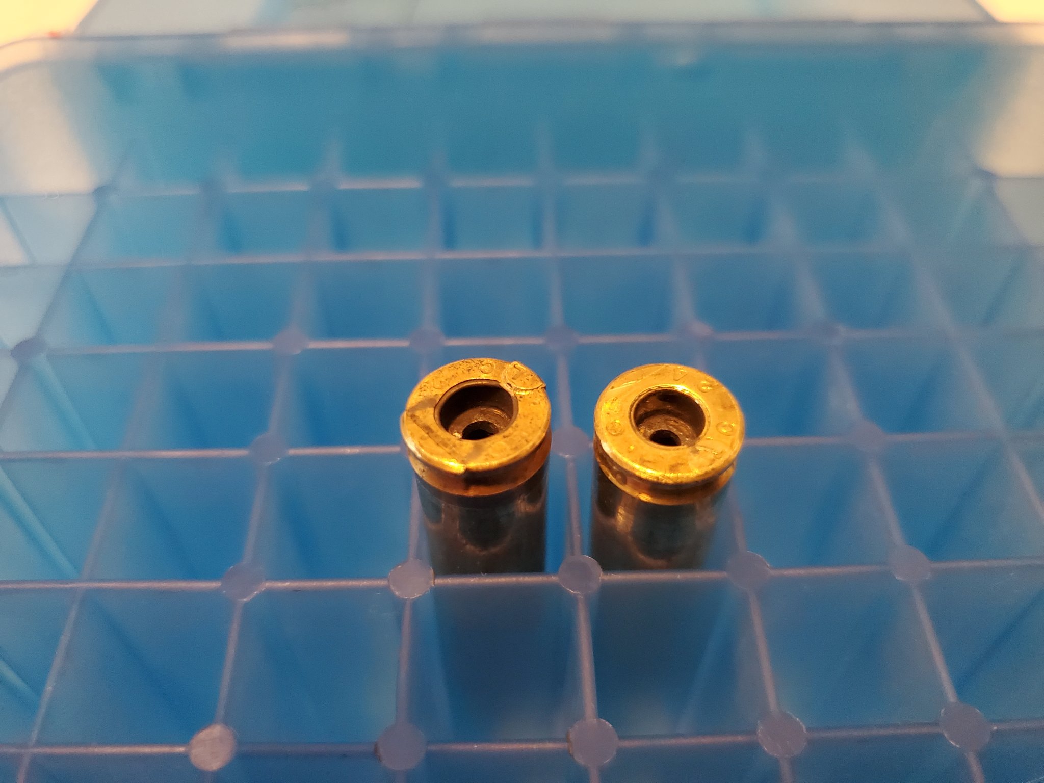

I recent did a build with a criterion pencil 16" mid gas 223w chrome lined. Initial impressions were good, a quick borescope through the bore reviled no obvious defects. It has been shooting factory ammo noticeably better than some of my BA barrels.
The second range day out, I ended up popping several primers causing the FCG to get jammed up. Upon recovering the brass, I found 5 pieces without the primer (out of ~200 rounds), and almost all had ejector swipes. This was winchester/lake city m193. I also tried some pmc x-tac m193 and still got aggressive ejector swipes, but no popped primers (out of 50 rounds). Historically I have found the pmc x-tac to be on the lighter side (chrono 2950 out of a 16", 3120 out of a 20"). I tried this factory ammo in several other know good guns and zero issues with ejector swipes or pressure signs.
I had some really light reloads with virgin starline 556 brass that I used for the first shots in order to start burnishing out the reamer marks in the throat/lands area before making any accuracy assessments. No pressure signs using that ammo. "break in" process and zero pressure signs with that stuff. By "break in" I just mean getting a few hundred round down the barrel before making any accuracy assessments or starting load development.

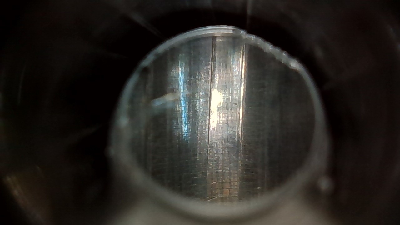

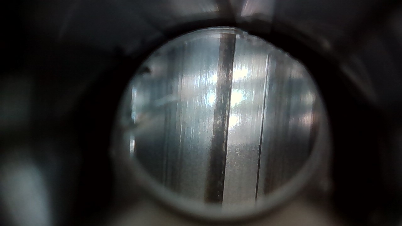

I would start by, Making sure the chamber and bore are thoroughly clean of any packing / shipping oils.
All my Criterion barrels have come soaked in oil.
Check , with your borescope, the chambers leade area. If possible post a video or pics here.
And your 223 Wylde chamber should be fine with 5.56 NATO ammo... if it is still popping primers , then I wouldcontact Criterion.

Have you checked headspace? The ejector swipes could be caused by a few different things, but before chasing that down, id check the headspace.
I did not check headspace, but I have been checking the spent brass in a L.E Wilson and Whidden Gunworks case gauge I use for reloading, the spent cases headspace is shorter than 223 rem no-go. I will dig up my headspace gauges, disassemble the bolt, check, and report back.
While I am 99% sure that headspace is within spec, the only thing I can think of with excessive headspace is case-head separation. But even that shouldn't be an issue on the first firing with lake city brass. I did make the mistake one time of buying machine gun fired 7.62x51 brass, and I was getting hard sizing and case-head separation on the first re-load. But that didn't appear to have any effect on whether the loads were over-pressure.

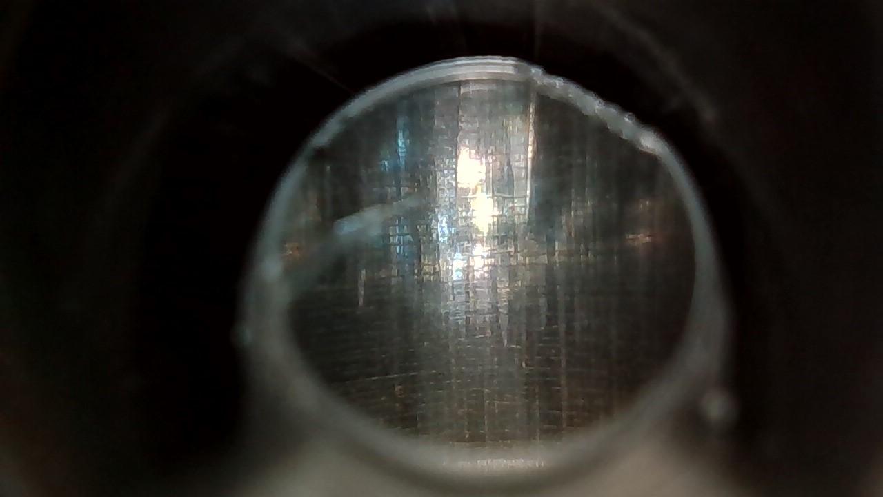

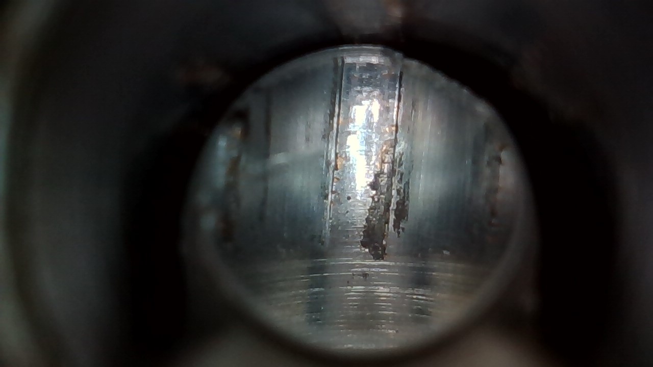

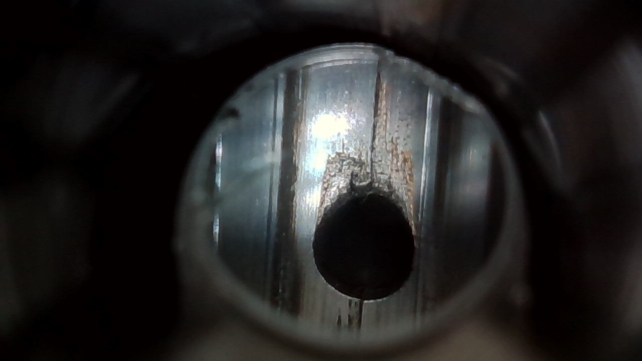

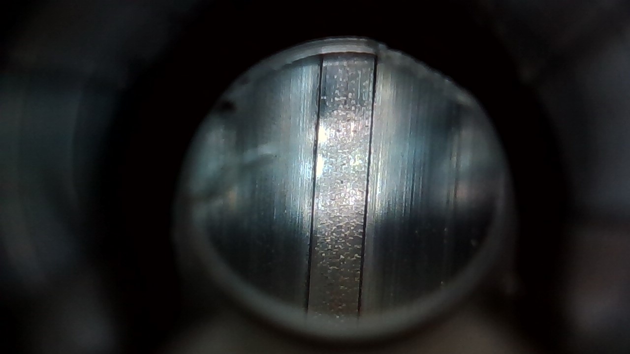

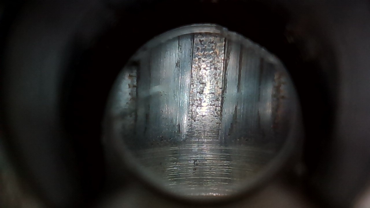

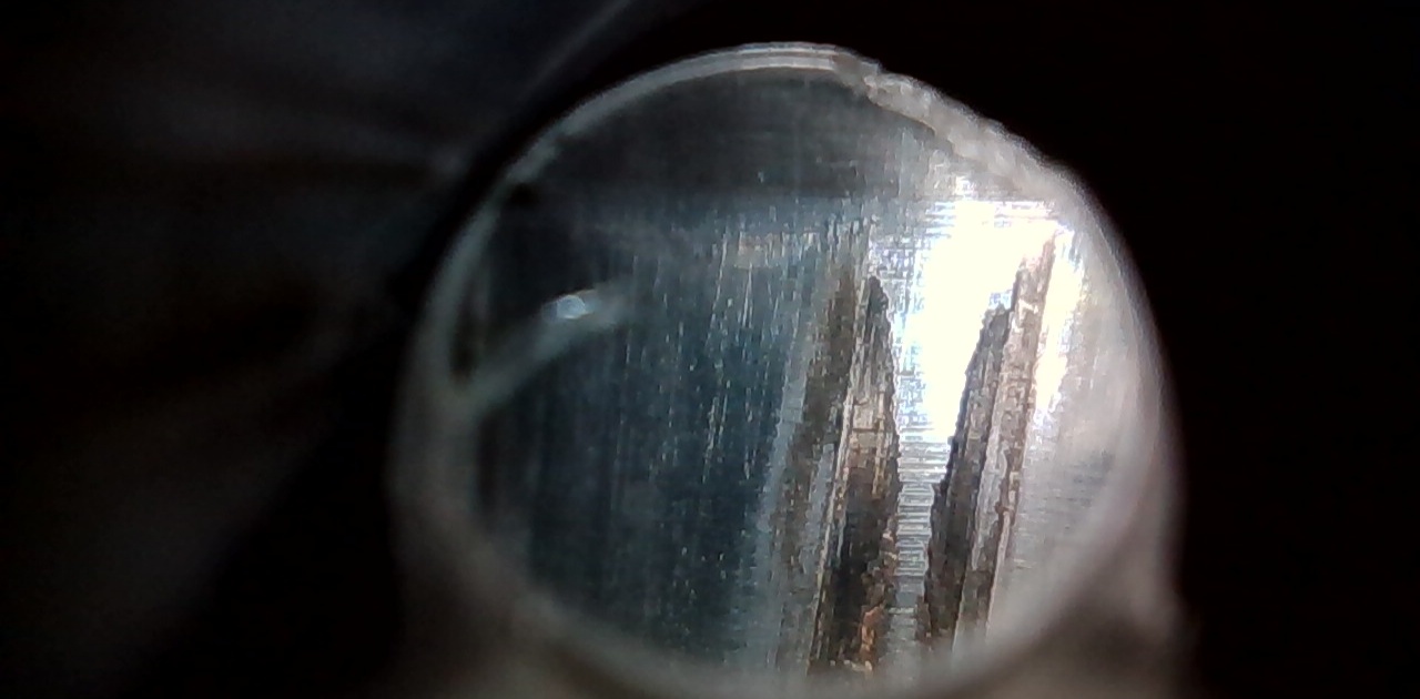

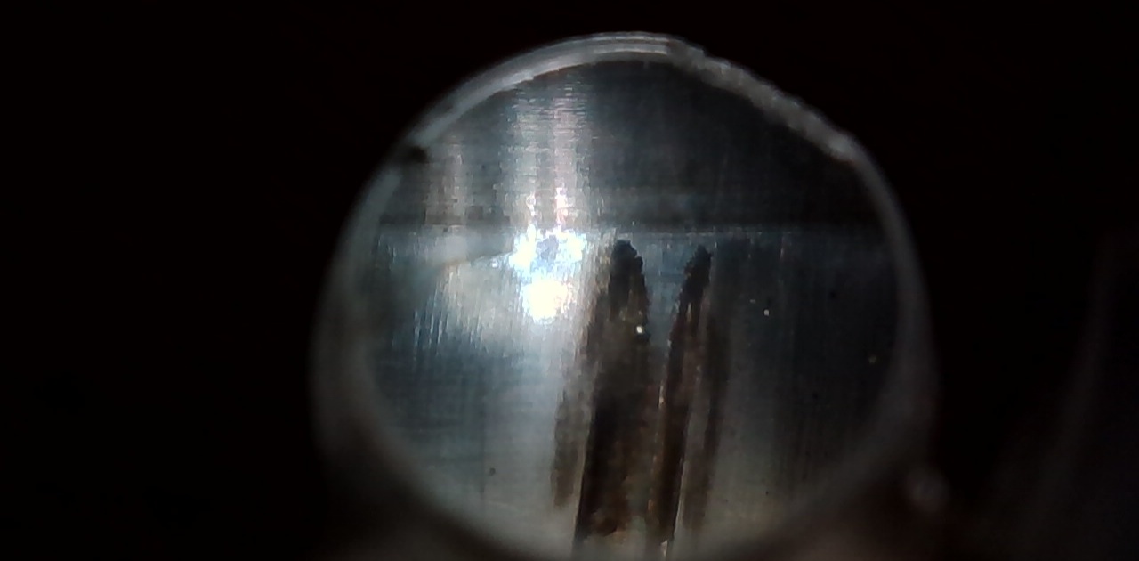

The borescope indicates otherwise. Luckily, I bought 2 of these barrels so I can compare a new one against one with ~800 rounds (the one in which this thread was started for).

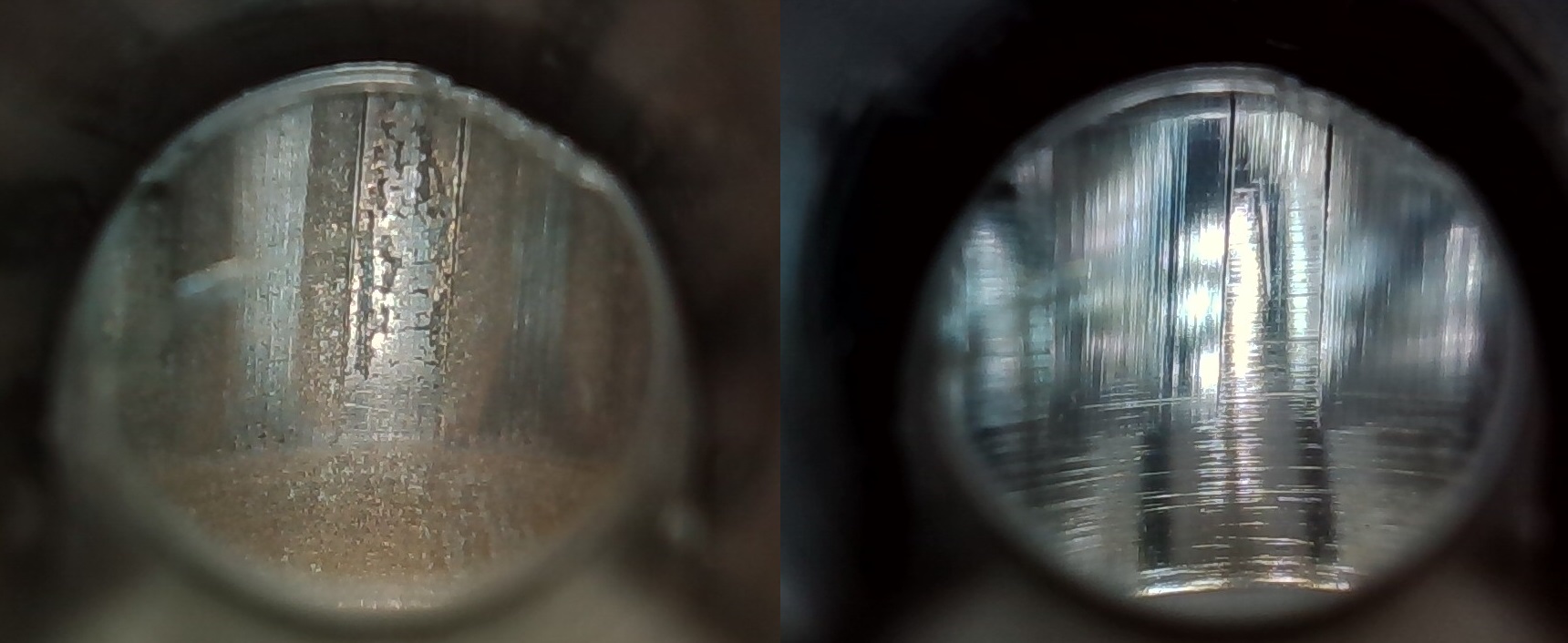

The left is an uncleaned barrel after ~800 rounds, the right is a new one with the packing oil cleaned out. IMO, this is a clear indication that the sharp edges of the lands are being "burnished" away.

That is quite a bit of fire cracking for a chrome lined barrel with 800 rounds, are you doing a lot of mag dumps.
Almost looks like rust.
Maybe you should try cleaning the barrel and see.
To be honest, I was thinking the same thing regarding the fire cracking. I didn't express that thought due to my lack of experience with chrome lined barrels. I doubt its rust, I live in a pretty dry climate and the only range days have been good weather.
I have cleaned the barrel 4-5 time since new.
No literal mag dumps, but medium to high cadence training drills on the shot timer. 3 mags in ~10 min followed by a long cool down period before starting a new set of drills. I did one 30 round string from a bench at medium cadence (60-90 sec total) to gauge accuracy of factory ammo compared to my existing ballistic advantage, it was noticeably better. This was done with winchester/lake city '24 headstamp m193. This was done prior to the popped primer incident that sparked this thread.

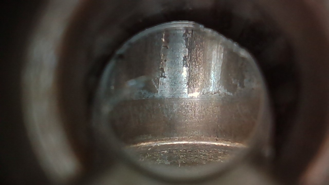

I'll post some more borescope shots:
1st and 2nd are the cleaned criterion barrel that thread references, the 3rd image is 1.5" from the lands. 4th image is the gas port, 5th is the land opposite the gas port.

I've spent half a lifetime working with electroplated chromium & other types of coatings as well...........just not on gun barrels.
And that's a schitty chrome job; the underlying chrome in the areas shown was plated as abnormally nodular/rough.
And the beginnings of the chrome peeling is indicative of poor adhesion.............won't be long until you have some significant coating failure.
I would return that barrel with your photos & get a replacement of a refund & not waste another minute on it.
But I still don't think that accounts for the high pressure, not really sure what that cause could be; your ejector swipes are indicative of unlocking too soon so it's either over gassed or your buffer / spring combo is allowing too quick of a bolt unlock & movement with no delay.

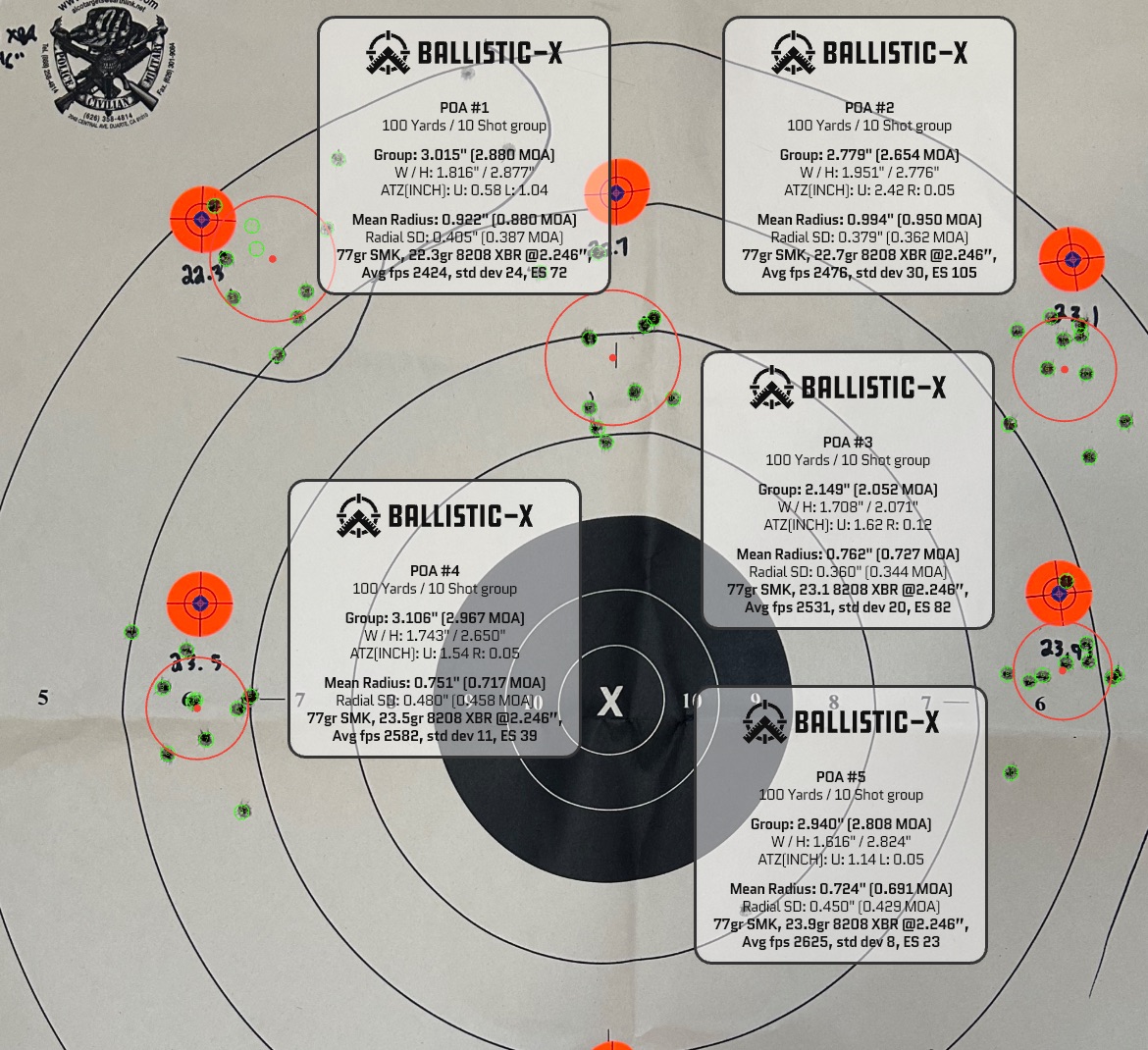

Im curious if the OP sent the barrel in and what Criterion said. I just installed a 16” mid gas criterion core 223 wylde barrel (with a headspaced bcm bolt) on a bcm blem upper and KAK handguard (with a non adjustable badger ordinance gas block). When I checked headspace with the stripped bolt it was really tight (didn’t close on 1.4646 and barely closed on 1.4636).
I only have about 140 rounds through it (mainly BH 77 OTM factory ammo and various handloads with 77smk’s) and the accuracy at 100 yds has been disappointing. Getting 2-3” 10 round groups while my 5.56 nato 14.5” super duty will easily get me sub moa 10 shot groups. Not sure what is causing the issues but I removed and reinstalled the barrel nut to make sure it has clearance for the gas tube, the way it was timed in my initial install the nut had some contact with the tube. I will try different COAL on my handloads due to the slightly different freebore length in 223 wylde vs 556 chambers to see if that helps. I also removed the yhm phantom flash hider to get rid of as many variables on the barrel as possible. Working on another batch of 50 rds of handloads to see if these changes helped.
Im open to any other suggestions and ideas to troubleshoot accuracy issues. Could be that the barrel doesn’t like this combo of powder and bullet so im not ready to pull the barrel until I get more data with other powders and COAL.
Below is my target from my last range trip to test loads with 8208 xbr.
That's disappointing for sure. I have a Criterion 16" Hybrid that is factory nitrided 416R stainless and it does really well with 23.3 - 23.5 grains of 8208 XBR and 77 SMK's. My COL is around or just under 2.250", this load shoots very consistently well 10 round groups for me in both the Criterion and a 16" Bartlein/LMT, my URGI is a little larger, but still good 1.1 - 1.4 MOA for 10 rounds.
Berger 73's are a little more accurate for me, those might be worth a shot.
Thanks for the feedback. I should be able to get to the range within the next few days to try out some loads with different COALs.
If you click on my profile and search threads I posts, there are some with load data and range results for my Criterion. I haven't strayed much from IMR 8208 with handloads in this rifle, but 77 SMK's, 73 Bergers, 77 Bergers, and 60 grain Hornady Vmax's shot tight groups without much fuss. I did get a few weird fliers in the first 100-200 rounds, but those are gone now.
I also tried some old 69 SMK's with 25.5 grains of Varget I loaded years ago. I keep a few hundred just to serve as "reference ammo" as I've found they shoot well in everything.

Thanks! I’ll def check out some of your threads. It does seem to be putting out less and less flyers as the round counts goes up.
