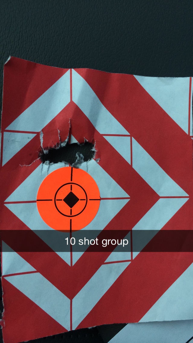

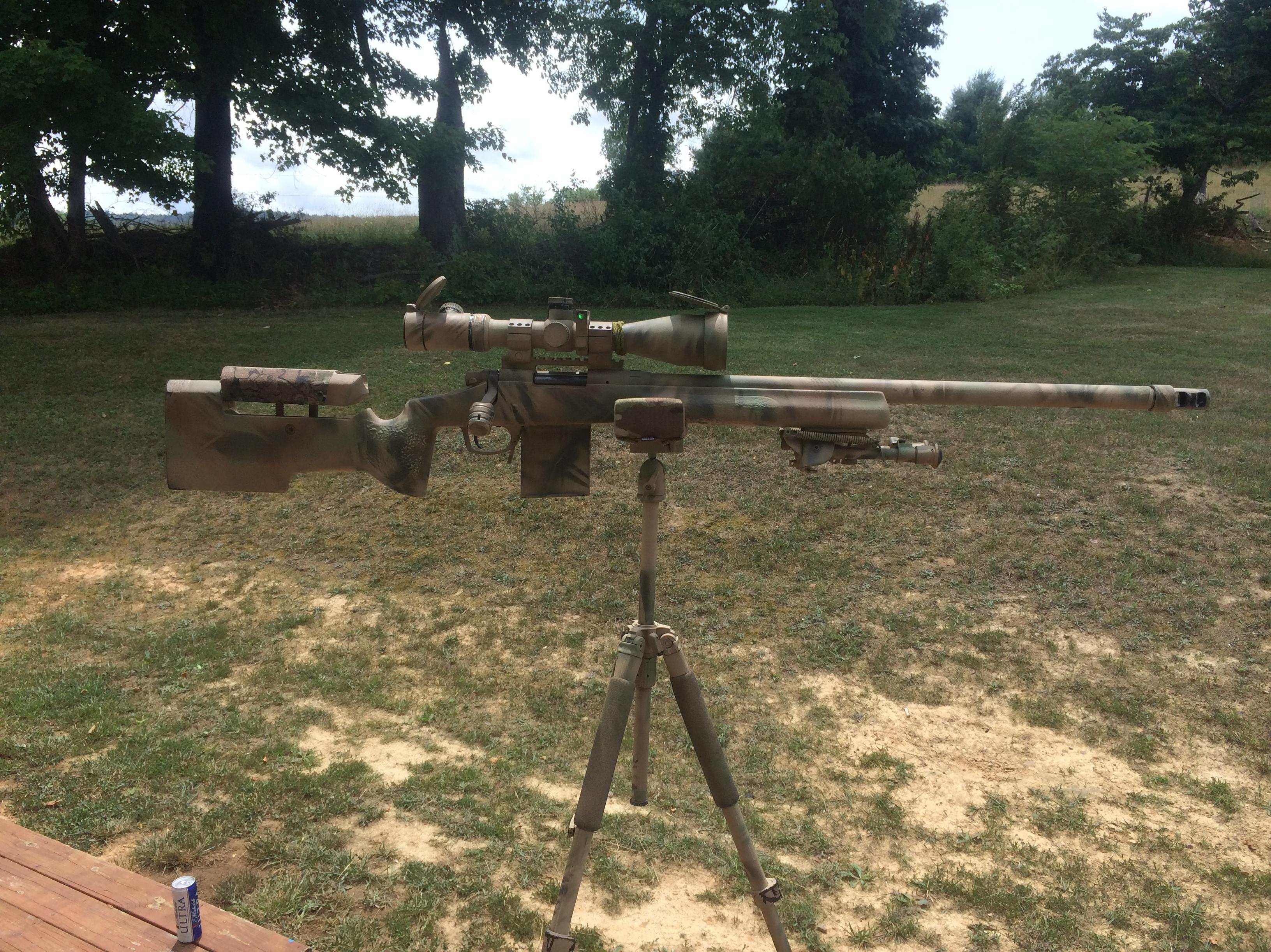

I love my .308 Criterion Re-mage! Had it cut down to 24" and threaded. Seemed like it needed no break-in at all. Grabbed some 175 7.62 NATO stamped FGMM just for a quick test. I would highly recommend these. Thanks to Jim at Northland Shooter Supply for being extremely easy to work with and extremely quick shipping.
Barrel absolutely loves hornady 178 BTHP my go to long range load:
Hornady 178 BTHP
Federal Brass trimmed to 2.010
IMR 4064- 42.8gr
COAL- 2.815
FGMM primers
MV-2704
Remington 700
Re-mage Criterion 1in bull @ 24"
Griffin Muzzle Brake
Manners T4A
Timney 510
KRG Bolt Lift
Vortex PST 4-16 FFP
PRS Tripod
