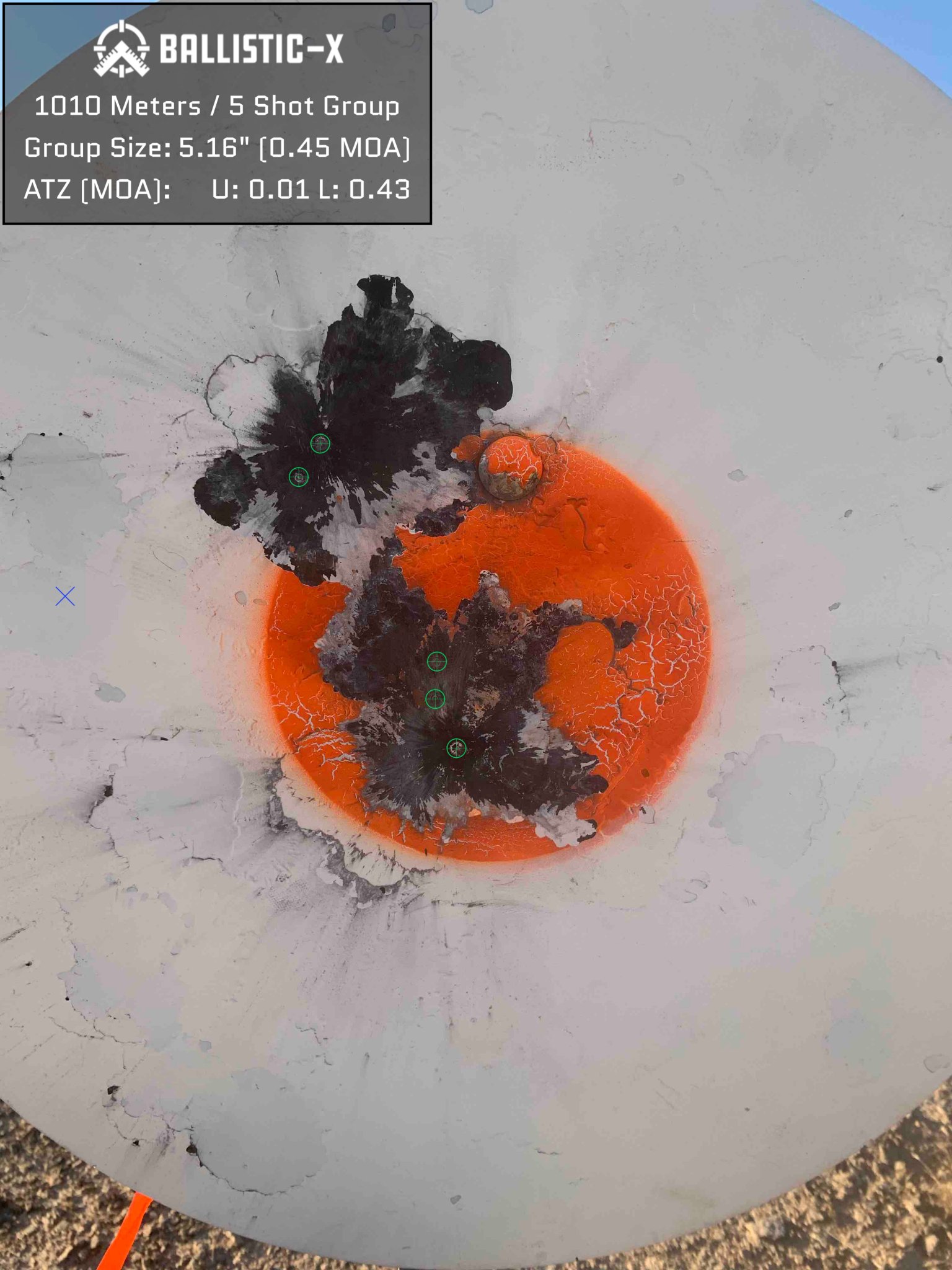

Criterion in 6br and I ain't that good...
