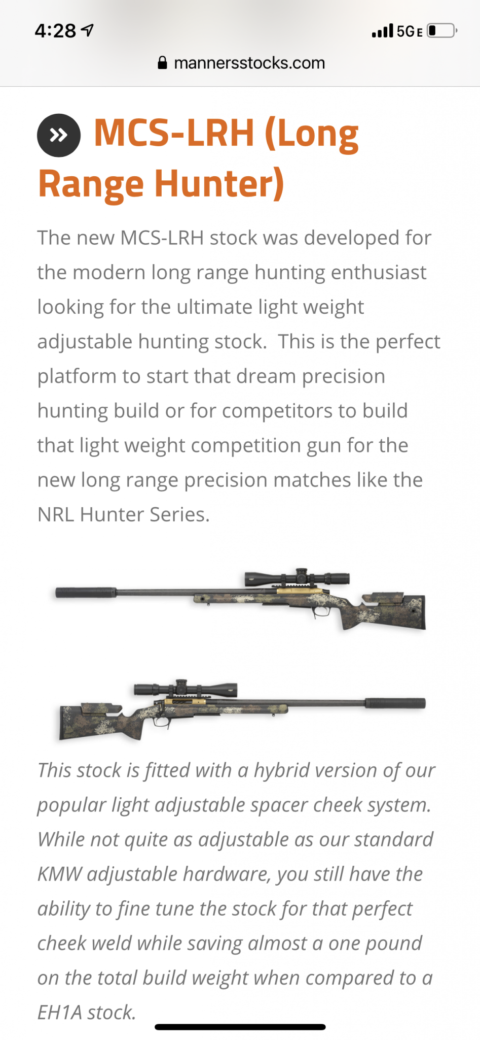

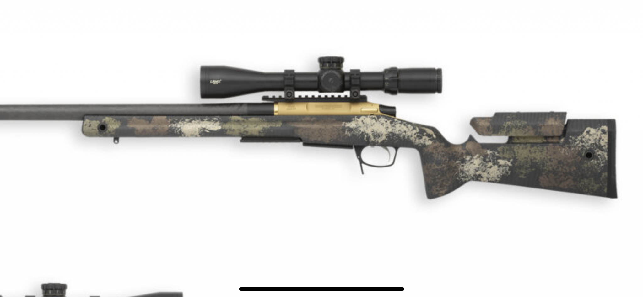

    I think the BB would be better spent in a barrel burner. Let us know how you like CF BB, bound to be a winner. Faster TR would give you more options. Enjoy.
    I’d lose the bravo and use an EH-4 (#1), MCS-CS, or MCS-T from Manners or an A1-3 (#1), HTG, or Sako Varmint from McMillan.
    Every component you’ve selected follows your theme, the stock is a bit out of place. Also, I would use a blind mag or bdl bottom metal. But that’s just my opinion
    I read that the weight savings isn’t much for the manners. And the bravo fits me very very well.
    If I had money and wanted to wait 8 months this looks awesome.
    ^ that arca rail tho.
    Oh and I want a nv rail too. Soo $$$$$$$$$ to add to manners

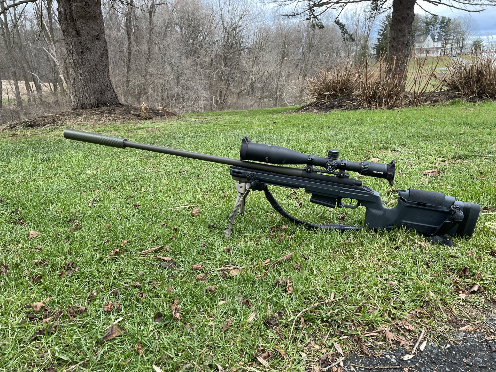

    Here’s some things that pushed me to build this.
    *Long Boi Pic*
    Reasonably light. But lonnnnggg. And don’t need 65 for a lot of stuff
    *Short Pig Pic*
    Heavy AF. But short.

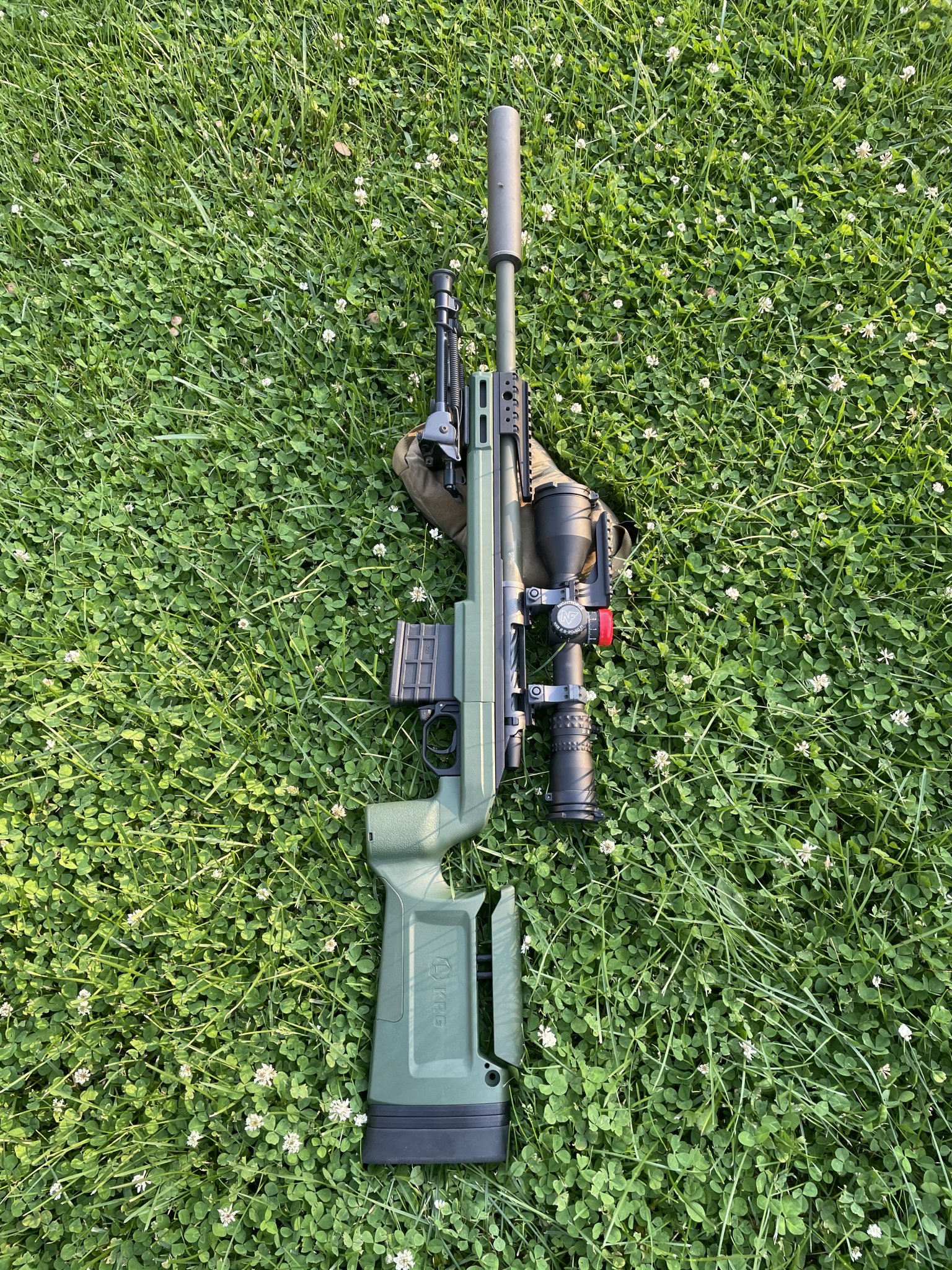

    Almost done.
    It’s not done yet still need sling , arca PAINT etc
    -16” 223 wylde benchmark from ts customs
    -Ti Gemtech sandstorm. (May put the 338 ultra on just because ). Plan on running a Dominus when it clears
    -KRG Bravo
    -KRG NV rail
    -Terminus Apollo lite action
    -Mk13 surplus trigger
    -1.375” NF ultra lite rings plus Raptar mount
    -Nx8 2.5-20 mil xt
    -Harris 9-13. Will put a Atlas or TBAC on it probably. The Harris is skinnier folded though.
    You might consider going with a 1:7 twist with a 223 Wylde chamber so you can shoot both .223 and 5.56. I have had really good performance on both projectiles from 62, 75, and 77 grains. The 5.56 shoots much faster FPS, but otherwise both are very accurate.
