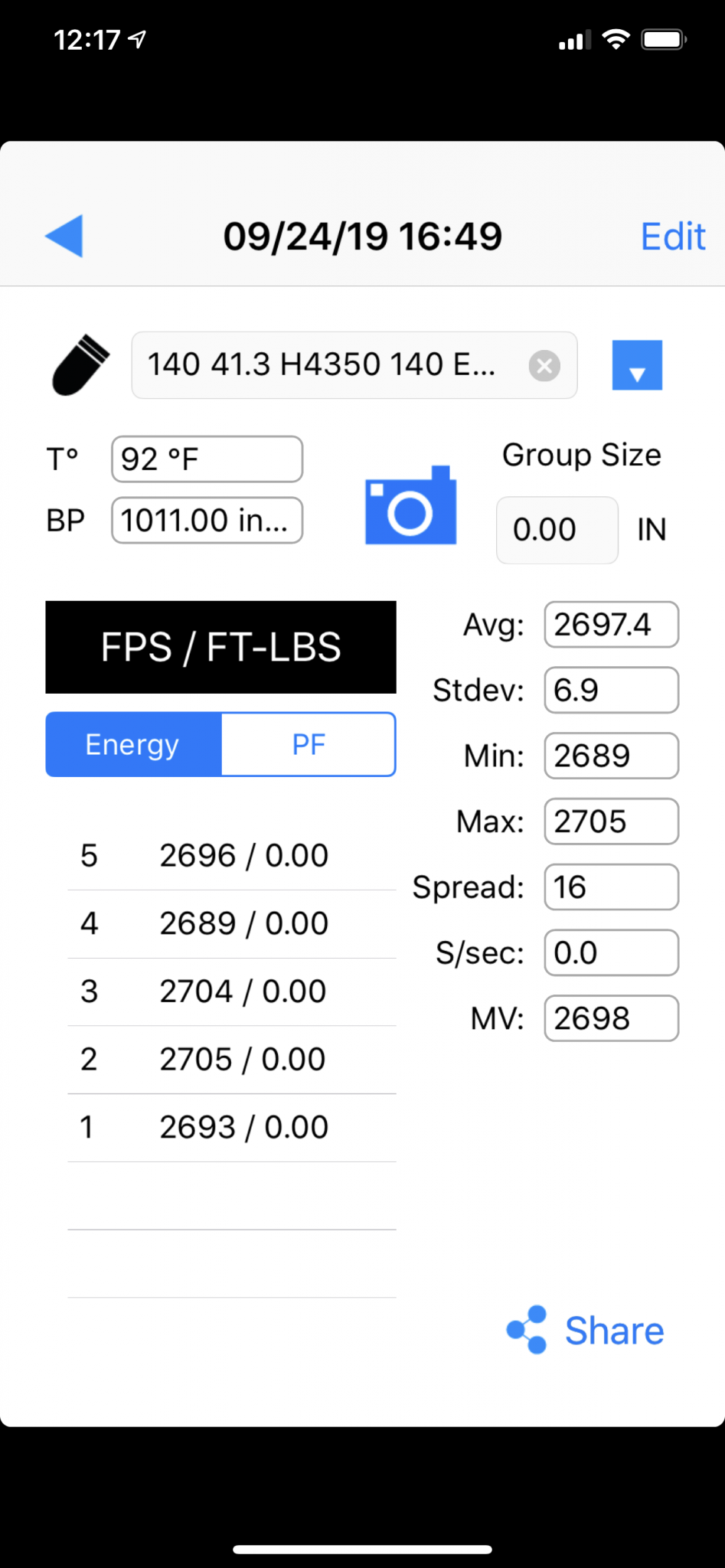

Single digit SD and low ES are doable, I have found my loads with 140 ELD Match, H4350 and 15 thousand off the lands in my Ruger PR. Both play very well, my OCW test @ 400 yds gave me great results between the 2 load ranges below. Hornady Brass, trim to 1.910, .288 bushing for neck tension using Hornady Match Grade Dies using the Chargemaster 1500 scales. I’m headed out today with 30 rounds, 6 sets of 5 rds each.
41.3 gr @ 15, 20 and 25 thousands and 41.9 gr @ 15, 20 and 25 thousands off lands.
Taking these out to 400 yds as well..
ES and SD from last 2 outings below.
