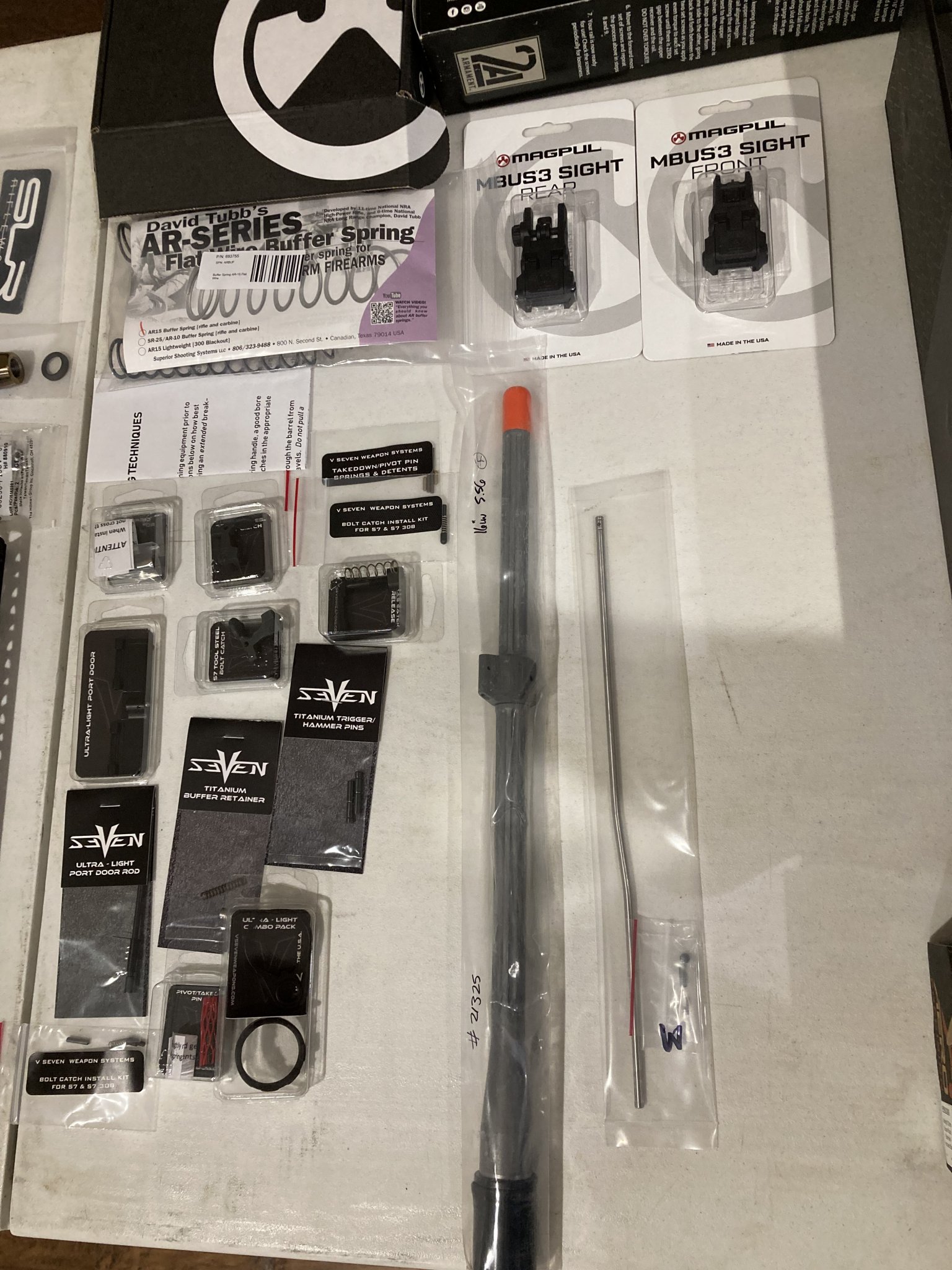

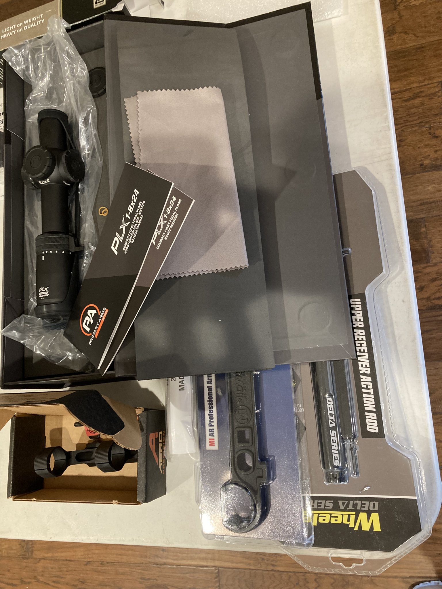

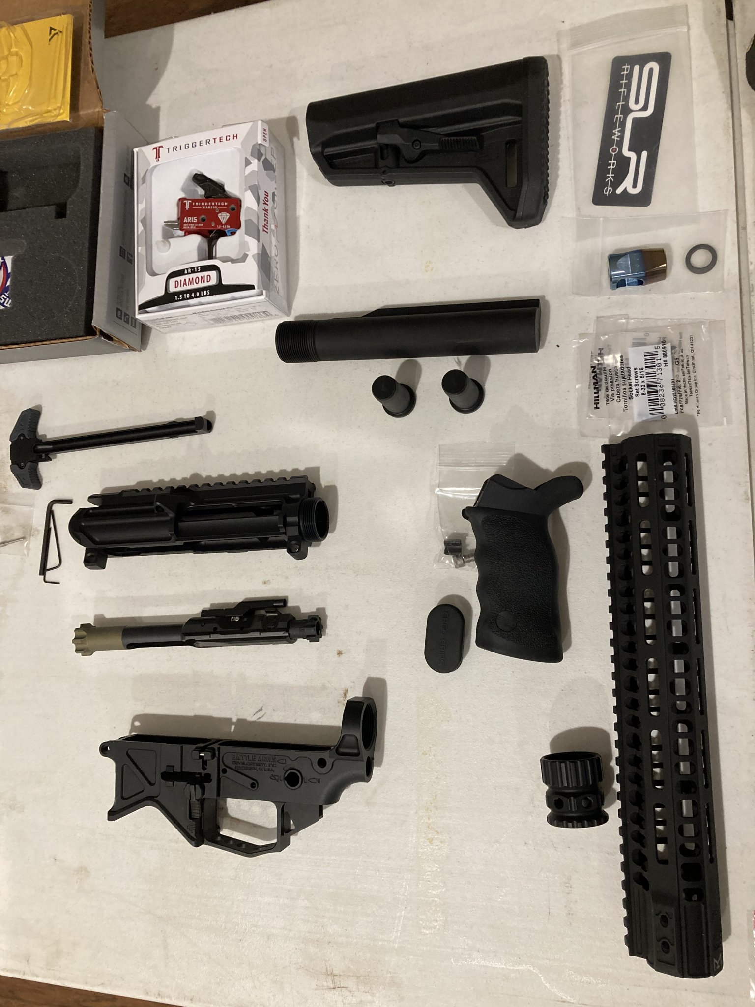

Building my first gasser since moving to a free state. Was going to buy one from MSTN or get a JP or V7, but decided to build - and learn from my mistakes.
Here's what I have incoming:
BAD556 Ambi set
V7 controls and dust cover
2A Ti Adjustable BCG
V7 Lightweight Fluted 16" barrel (comes w/ Ti gas block and stainless tube)
BAD LW Carbine Buffer Tube
Taccom Ultralight carbine buffers and Tubb Flatwire spring
Magpul SL-K
Raptor LT
TT Diamond
2A Balios G2 12" rail and Ti barrel nut - had thought about 15", but wanted to have the option of a 12.5" barrel later.
Ergo 0 degree grip w/ beavertail
Lancer Mags
Aero Ultralight mount
PLX Compact 1-8 Griffin Mil
Brake: wavering between SLR Synergy Minicomp and the SR22, both in Ti.
Hoping the system can be tuned without a weighted buffer, and hoping I didn't make any glaring mistakes otherwise.
Uses: fun, learn to shoot faster, target and steel, stand, kneel, prone, mostly inside 600, and if accurate enough, maybe some varminting. Going to try 55 blitzkings, 75 eldm's, and 69 & 77 smk's / tmk's. My bolt 223 is 26" and dialed with 80's, so I have a bunch of lighter components around to try.
^Sounds like this journey may end up being long and expensive :ROFLMAO: - I didn't mean to build a who's who, just looked at performance/weight along with availability, and went from there. With bolt guns, and especially with optics, I've learned the hard way that it's cheaper to buy once - so thought it would cross over, but expect I will learn what I wasted money on once I get more experience with the parts.
I do have chassis bolt guns that I could swap the grip with if vertical is weird... Hopefully not a biggie with the rail for now - I would prefer to run a bipod further forward, but don't expect to put one on this rifle, so thought less weight forward, and the option to swap. Trigger was difficult since I couldn't try many - pulled a component 2 stage and single stage (unsure of brands) in the gun shop, but both felt creepy, long overtravel, and heavy. I keep my bolt guns around ~6oz, so this is going to be a different animal for sure.

Those 75 ELD's are gonna be a no go.
Interesting choice on the Taccom plastic buffers. Not necessarily a bad choice, but they're best suited to race guns with super light carriers and springs and possibly even low powered ammo. I have a few and they work fine but are kinda niche.
Interesting choice on the Taccom plastic buffers. Not necessarily a bad choice, but they're best suited to race guns with super light carriers and springs and possible even low powered ammo. I have a few and they work fine but are kinda niche.
75 ELD's due to length or V7 barrels tend to not like them?
Plasti-buffers - yes, I'm interested to see how the whole reciprocating mass balances... hoping the ti adj block will allow me to smooth it out for different loads. Maybe the Blitzkings or some 50 or 60 VMAX's will do better with the lightweight build? I have a feeling I'm going to end up with 1 pistol and 2 rifles, each wearing some of these parts...
More or less what Tony said, with a couple of other comments.
I do like all thinks V7 for the most part.
Having had both, the Radian Talon is far better than the BAD ambi safety.................not even close.
For sure, drop the plastic buffer idea, at least in the beginning for the reasons mentioned; if you don't want to start with a full mass BCG, then use a reduced weight one from Young or JP or RCA, short of titanium, as is will be much easier to get the gun tuned initially & you won't need low recoil handloads.
I also match handguard length to the gun, but have more or less settled on a 13.7" Geiselle MK-14 or SLR Ion Lite for 14.7" - 18" barrels...............personal preference depending on the intended use, some like the rail right to the end of the barrel or very close on everything.......I don't.
69 & 77 SMK's tipped or not, 70 -77 RDF's, & 75 Hornady's will do all that needs doing within the capabilities of 223W /5.56 IMHO.
LaRue grips fit my hand really well, otherwise mostly it's a Magpul K2+, not a big fan of zero angle stuff yet.
Never used any of SLR's brake's....................but there are some good reviews available on effectiveness of various brakes if you search hard; if not suppressed or if not a flash hider, I like VG6's.
YYMV
MM

You mean the ADAC-15 receiver or just the Talon controls? V7 told me I bought a flimsy receiver set... so much conflicting info online I just said f-it, I'll put one together and by the time I shoot a few K rounds, and probably swap out all the parts, I'll be intimately familiar with the platform, what I like, and how part changes affect (or don't affect) all aspects of the system.
Was hoping to run full power loads with the current build - figured worst case I could add a weighted buffer, or even swap to A5 length buffer tube plus weight - but then the super lightweight bolt makes less sense... Circular arguments will be the norm until I can use it and decide with more info and first-hand experience. Worst case is some of the parts might end up in the PX.
I'll probably exchange the Zero grip - looked at my bolt chassis' and neither have room for a beavertail.
Watched and read exhausting reviews about muzzle devices. For now, wanted to stick with Ti (given the lightweight build), and didn't want any holes on the bottom in case I was shooting prone. I have a radial brake on a 300RUM and the brake needs its own shooting mat :ROFLMAO:. V7 Furion as well as their Competition brake both look interesting, but the SLR's are smaller.

The 73gr ELD's are designed with AR mag constraints in mind. The 75's are way too long, to get them to mag length the ogive will be well inside the case neck. And they like to be closer to the lands. I once extensively modified an AR to make it work and it was cool but now we're getting really niche.
You can certainly get the low mass stuff to work with both heavy or light loads, problem is with setups like that you narrow your operational window considerably, so it becomes a one trick pony and will require gas adjustment to be optimized for one or the other. It's unlikely it'll be happy running both on the same tune.

^Cool, thanks - since I don't plan to run factory ammo, set and forget might be OK. Also, the 2A bcg doesn't need to be removed to adjust (unlike the RCA), so, in theory, fine tuning each load shouldn't be a huge PITA. 7 twist barrel, so hoping I can get a light projectile to work as well - assume the 69-77's will be easier though - and better BC anyway, but the light bullets seem to have 1/2 the recoil - which is nice if trying to stay on at longer range and higher magnification. Can't wait for the trial and error!
^Very nice. And agree on all points - I found myself not choosing a part, or spending extra money on V7 lower parts, for example, so as not to nullify a prior chosen lightweight part. Will see how much I enjoy the light weight - I had a CZ527 youth carbine a while back and do miss it - this should be even lighter, and semi. Just hoping it isn't difficult to shoot/finicky with regard to hold/pressure.

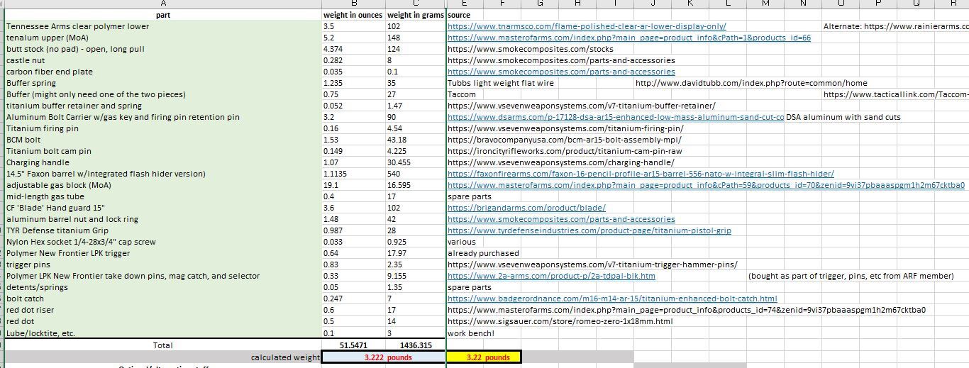

Here’s a couple of my builds:
4#, 9 oz with no tax stamp…including red dot and mount + BUIS; based on 2A Arms Balios lite set, Smoke Composite stock, etc. with tons of V7 guts and a Boomfab Titane titanium bolt carrier.
And the one I went nuts with to see how light I could get with an AR (again no tax stamp or pistol brace to cut weight with a shorter barrel). 3#, 4.4oz including a 10-rd magazine:
Parts list with weights/sources:
edit; and yes, both are actually used…albeit pretty much range use only For the ultralight build.

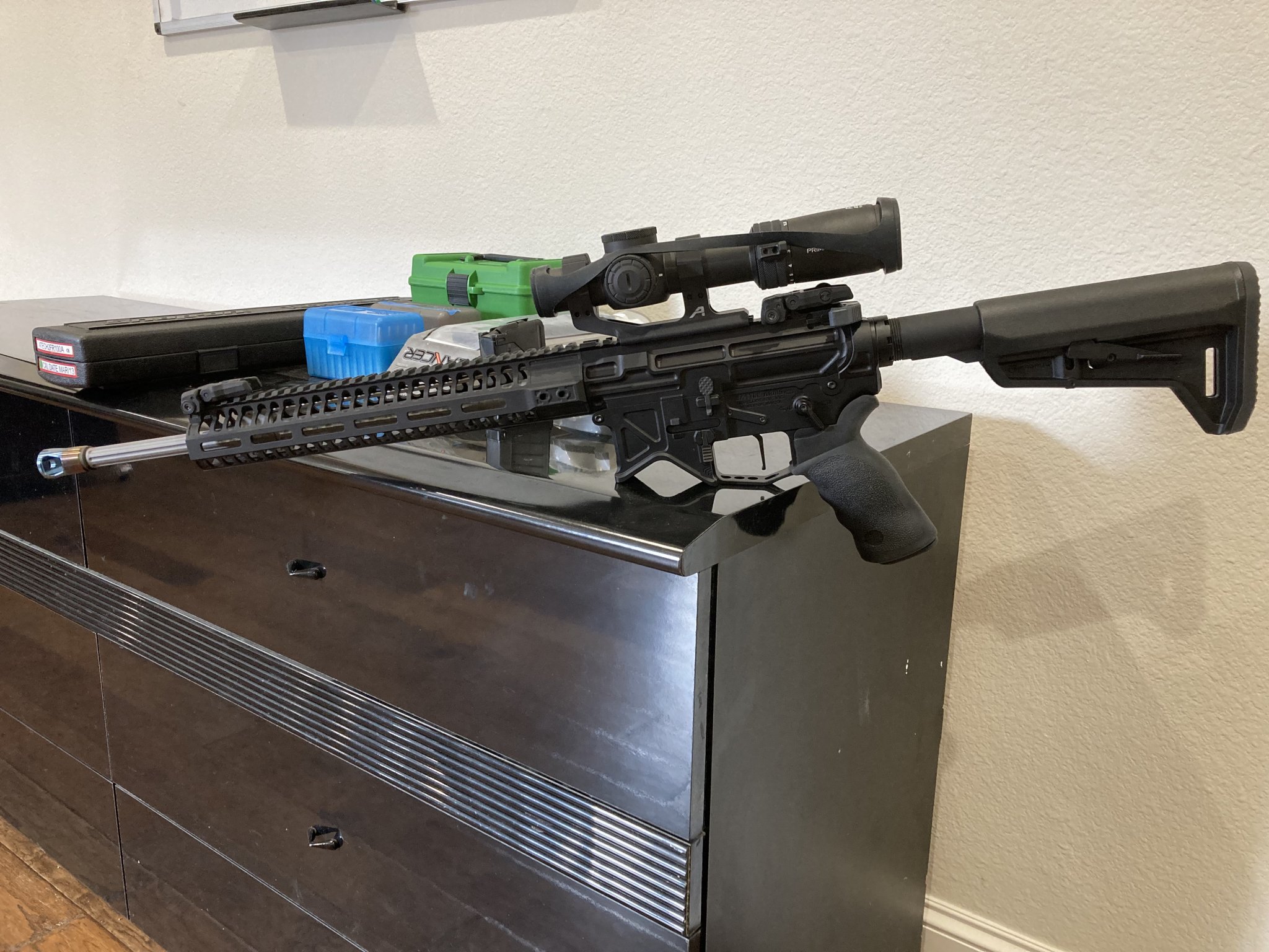

First shots today! Started with gas off and slowly turned it up, putting just one round in the mag until I had enough gas to lock her back. Then put 2 rounds in the mag to see if she would cycle.
Cycled fine, but trigger was already released when the bolt closed on the 2nd round - round didn't go off, but did mildly dent the primer. Put the round back in and fired as a single to make sure it wasn't an ammo issue, no problem. Did that 3 more times before putting her away for the day.
Got her back home and checked the trigger - might have an issue... if rifle is on safe, and I pull the trigger (safety works), then as I click off the safety, the trigger releases, without touching the blade, i.e. the safety lever essentially becomes the trigger shoe. This happens whether it's set very light or very heavy.
Also, re: the 2 round tests, I'm thinking the sear either never caught, or had released when the bolt was cycling, and was following the bolt back as it was closing. This slowed the hammer down enough to not double fire.
So, before I send it back to Triggertech, any other thoughts?

And weighed her... 4lbs 14oz with no mag no scope.
I think I enjoy shooting her with the magpul flip-ups more than with the scope! So light and handy... Aero mount held zero after I re-installed and checked it, so sticking with it for now.
Will hopefully get out to 200 yds this weekend with it - just have to build some more ammo.
Also picked up a 16" Proof in 308 to start a large frame build - thinking the 2A Xanthos for another lightweight, but all ears about other options.
200 yards finally - New Win brass, 53 v-max, CCI 400's, 24gr Benchmark, 2.255 COAL.
First 2 groups to get on...
1 more a little faster...
Finally a 10-rounder and 5-rounder slow, concentrating... flyer in the 10-rd group I pulled as a dude next to me pulled up with an 8.5" SBR with a brake :ROFLMAO:
Very impressed with the V7 barrel and the build - can't believe it's under 6lbs scoped and shoots like a decent bolt gun.
Would've gotten out again this weekend, but like this gasser so much I bought stuff for an AR10 and built it today instead - might put a bolt gun or 2 up in the PX soon, since these 2 builds create some redundancy.
AR10 Build:
2A Xanthos set
V7 Hyper light 13.5" handguard and Titanium barrel nut
Proof 16" 308
Toolcraft Titanium BCG
Triggertech Diamond
SLR Synergy Ti mini-comp
SLR Ti Adjustable gas block
Taccom 3-stage buffer and Tubb Spring
Magpul SL-K
Ergo grip
Magpul flip ups
Unsure on optic, but, will try the PLxC on this as well - might also try an LHT 4.5-22 that I have on a different rifle.
