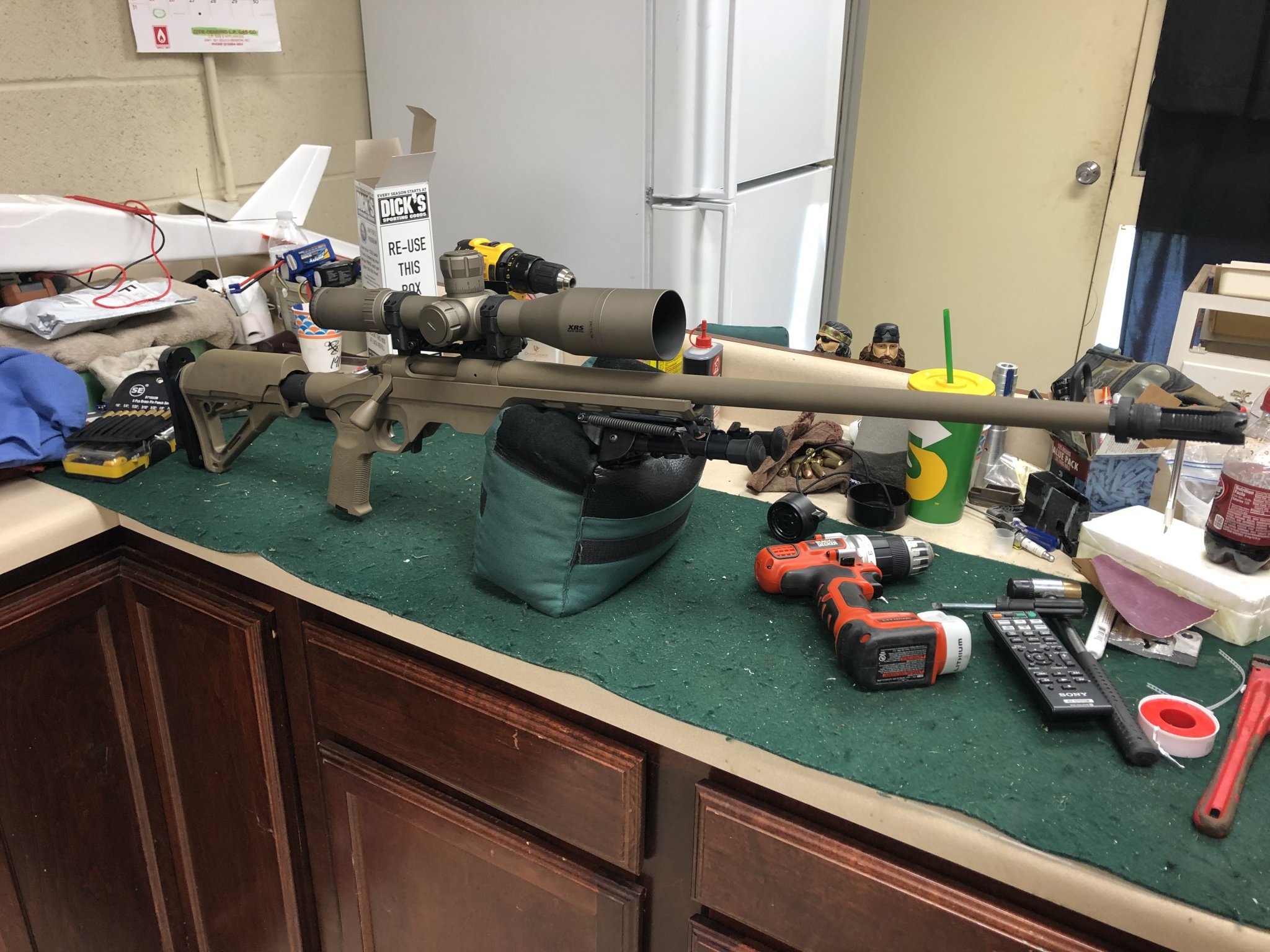

Another one here to vote against the LSS. I had mine fully kitted up similar to the last photo...
Area 419 arca rail was required to remove the fore-end flex.
You may just want to look at picking up a used other model chassis instead?
