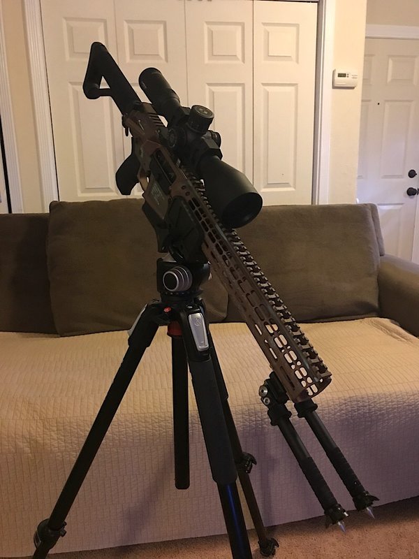

Received mine on Wednesday and was able to get it mounted on my 6.5 semi. Very solid scope for the money, so far looking great.
Only issue was was trying to get it zeroed...... oh wait .......
