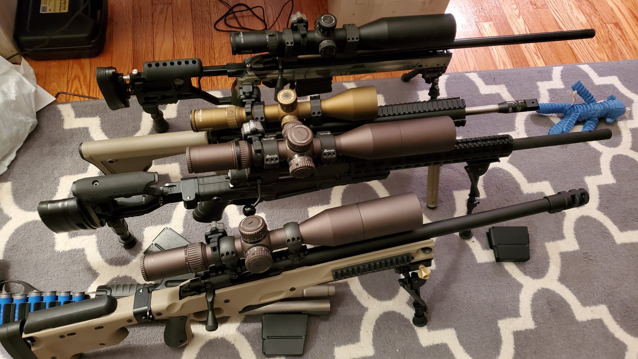

I have two of each, besides the locking turrets (which are no big deal to me) I'd call them equals...btw I am thinking of selling the GA Precision in the fore (.308 with less than 200 rfd fired).
