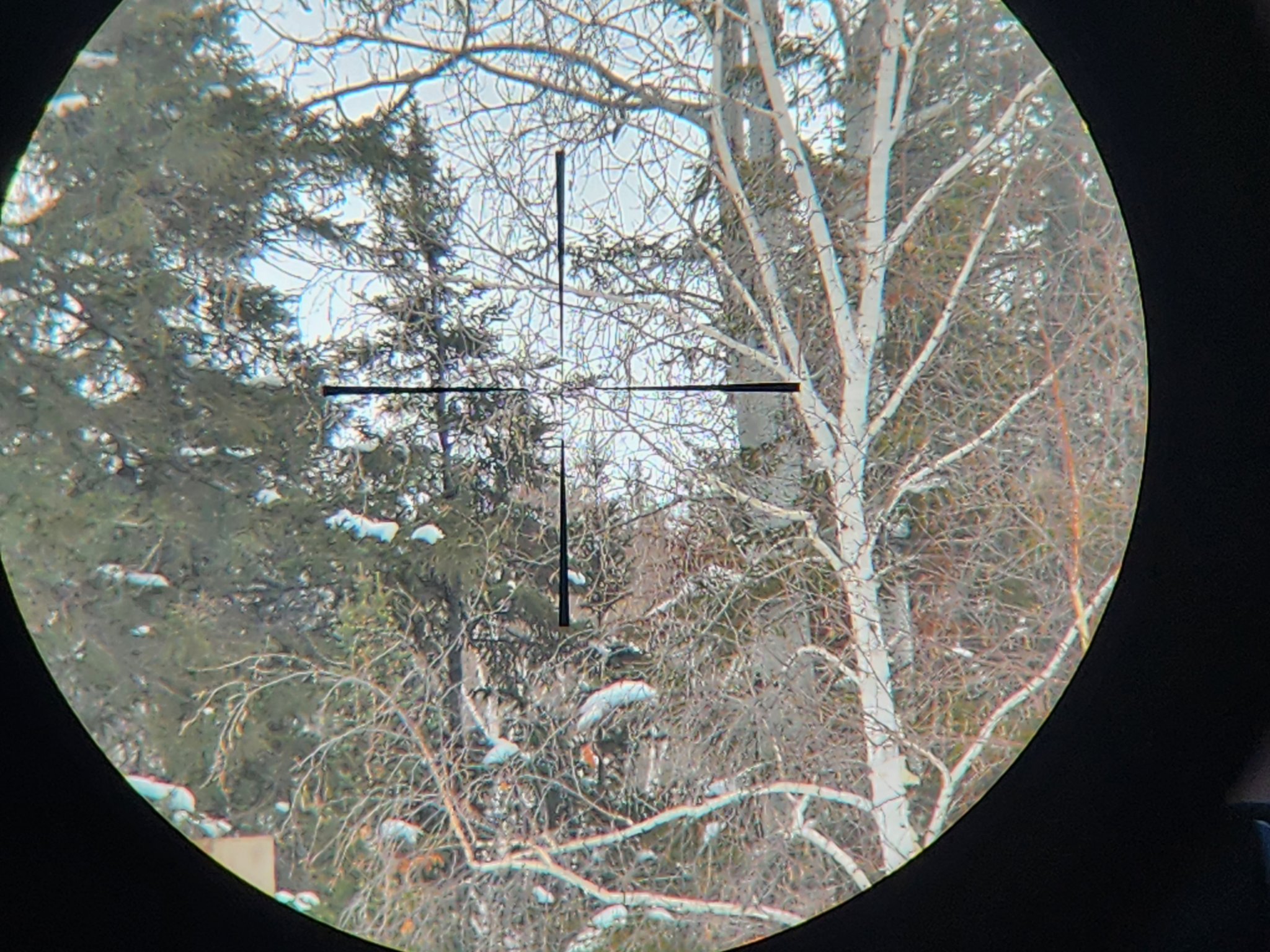

I have similar use criteria as what you listed. USO B17 with H102 reticle has worked great for me. I’m sure it’ll get all kinds of hate on here, but it flat works for me. Thick circle and posts make it easy to see on low end FFP, even in low light without illum on, at high end makes it easy to use tree out to 800. This is on a 20 inch 6.5 Creedmoor AR 10 build. Have killed animals with it from 25m out to 400, steel out to 800.
I haven’t looked into USO in a long time, just had a peak at their site and I see what you mean. That circle of death style is very appealing, I think they’ll be next to impossible to source where I’m at without just ordering blind.
Can you comment and how and when you’ve the tree in a big game scenario?
For hunting, it is really hard to beat a Burris Veracity with the E1 FFP reticle. It is a FFP BDC reticle with 5 and 10 MPH wind holds, that is thin in the middle and gets progressively wider the further you go to the edge. so when you zoom way in, it is still thin in the middle and still wide enough to see at low power at the limits of legal shooting times with a wooded background. (no illumination needed)
A lot of people don't like BDC's, but for hunting i think they are super useful for fast reaction shooting 400 yards and less, and the Veracity dials beautiful for those shots that are farther with the optional "MAD knob"
They are a smart design despite being a little dated. I’m so used to “tactical” reticles it feels very foreign and coarse going back to hunting style thickness.
Here is a pic of the 3-15 on 4 power.
I understand that as my brother uses target scopes for hunting... but to me it just feels like the wrong tool for the job. I can't imagine using a Mil C or Mil XT for hunting. Good luck in your search.
