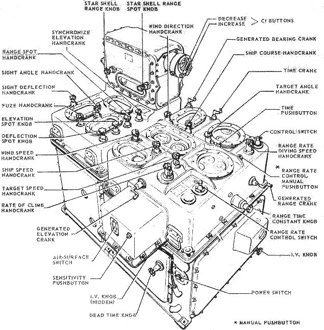

BTW if for anyone interested in ballistics, you could spend a lifetime studying the IOWA class battleship 16in guns that Frank mentioned. The analog fire control system is, in one word, awesome. The ballistic solution had to consider the relative motion of the ship and target, pitch and roll of the ship, and the usual external ballistic factors discussed here including air density, muzzle velocity, coriolis and spin drift (although this was less of a factor since the RPM of these rounds was only a fraction of our bullets, a twist of 1 in 400 for a 16in shell gave a little over 4000RPM, a 180 berger in a 9 twist at 2900 is about 232,000RPM) Just imagine wind corrections for a relatively low BC projectile at 80sec TOF. The engineering problems they solved to even get close in the days of slide rules are incredible. I attached a picture of their SUV sized iphone ballistic computer, and that doesnt even show a room full of other adjustments:
I think it fair to say we are living in a golden age of long range shooting. We are the beneficiaries of amazingly consistent manufacturing techniques for barrels and actions, the most uniform high BC bullets and consistent powder ever, trajectory calculating tools that can fit in the palm of a hand, the availability of excellent instruction in shooter fundamentals, all at a price enabling almost anyone to participate.
It is a good time to be a shooter, even considering the external pressures on the scene. Lets all enjoy it while we can!!
Here, I had this saved,
It does have an effect, but...
