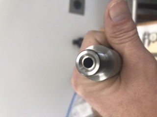

Guys I’ve used lathe tools for crowning and the floating pilot cutters also do i nice clean cut. Do any of you leave the crown sharp at the land and groove with a sharp edge or do you go back and put a chamfer into the land ang grooves ?
Either will work as long as you're getting a clean cut and not leaving a bur in the muzzle. The sharp corner may give better accuracy, but is also at somewhat higher risk to damage than the more obtuse angle of a chamfer.

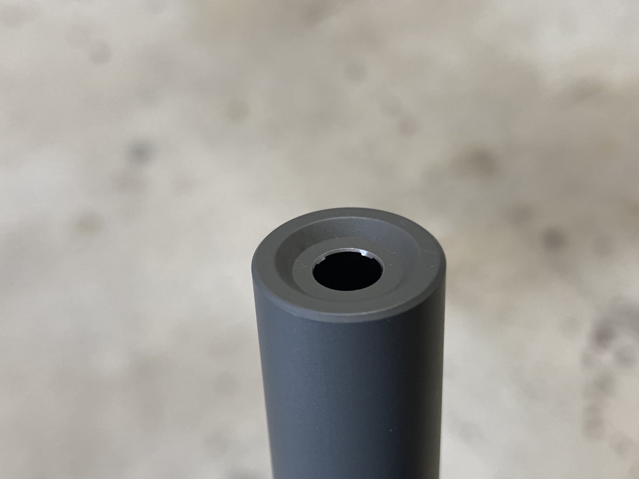

As @Praeger said. I usually do rebated "hunting" crown, with 11deg internal. Use cotton tip (q-tip) after to draw it in and out and see if any whispy bits get stuck on a burr. If it doesn't snag or catch, you are good to go. By request I have put a 45deg chamfer ONLY on the rifling, so they are cut, but the actual bore is not cut.

Bore dialed in and cut with Piloted cutter
