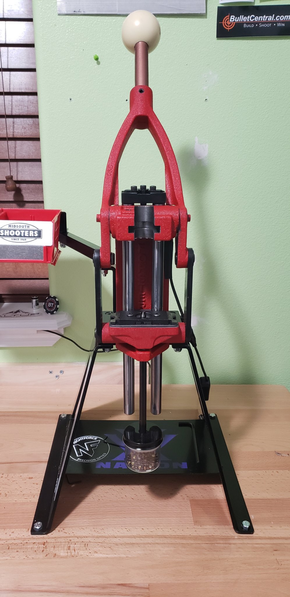

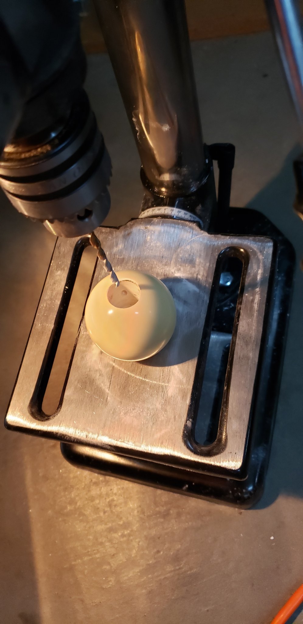

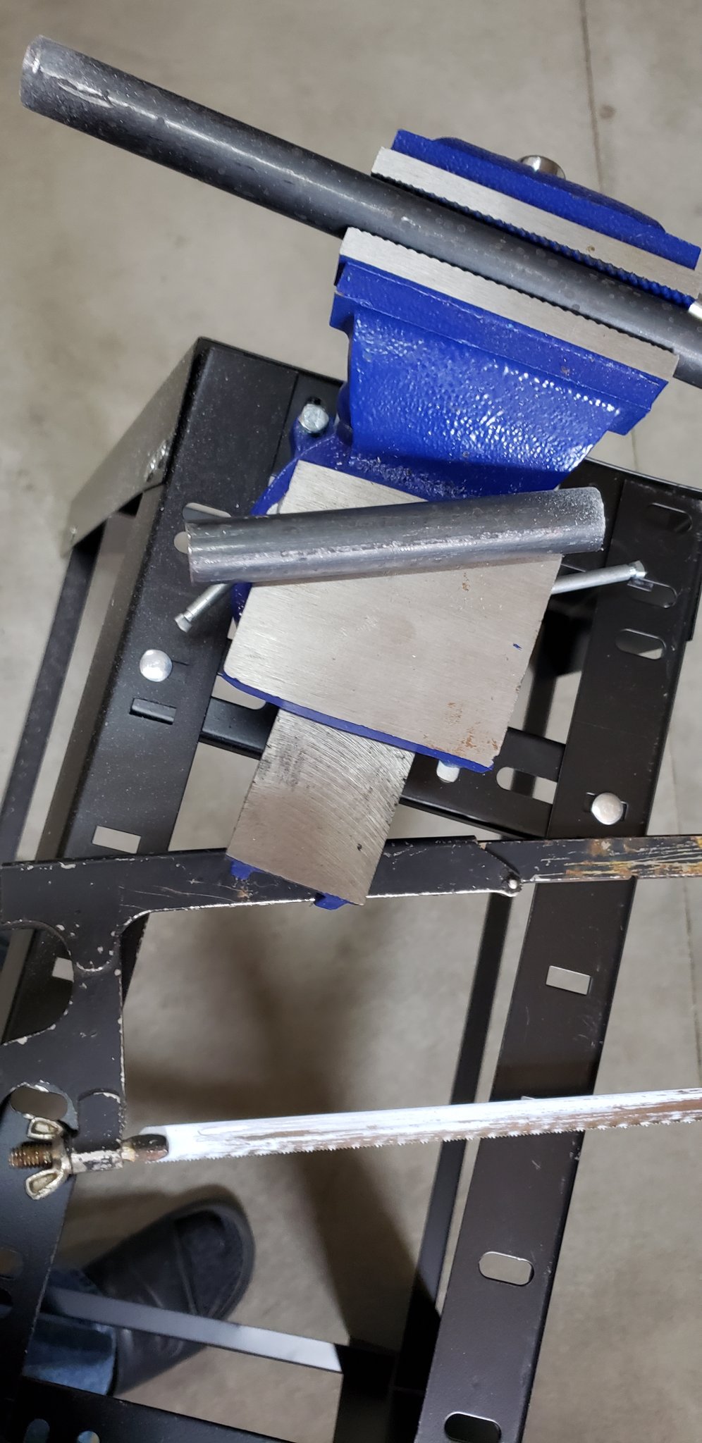

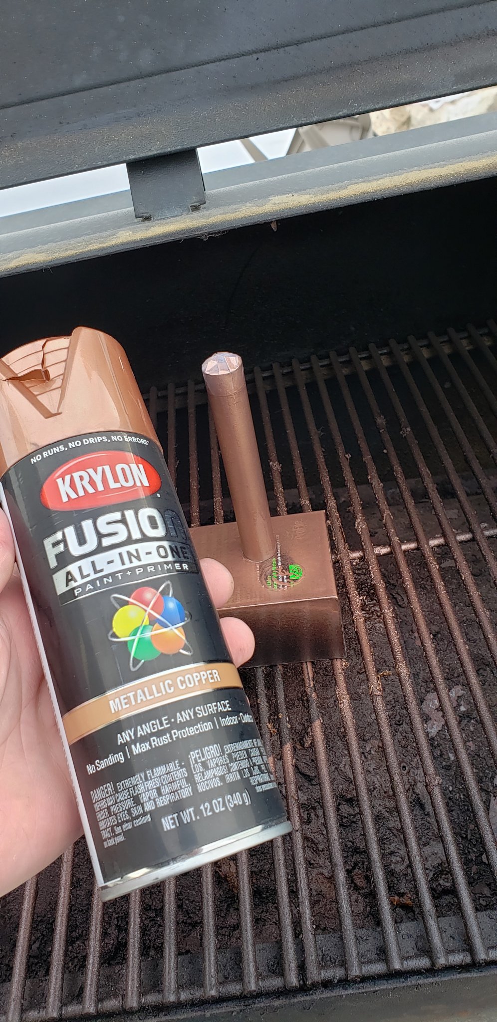

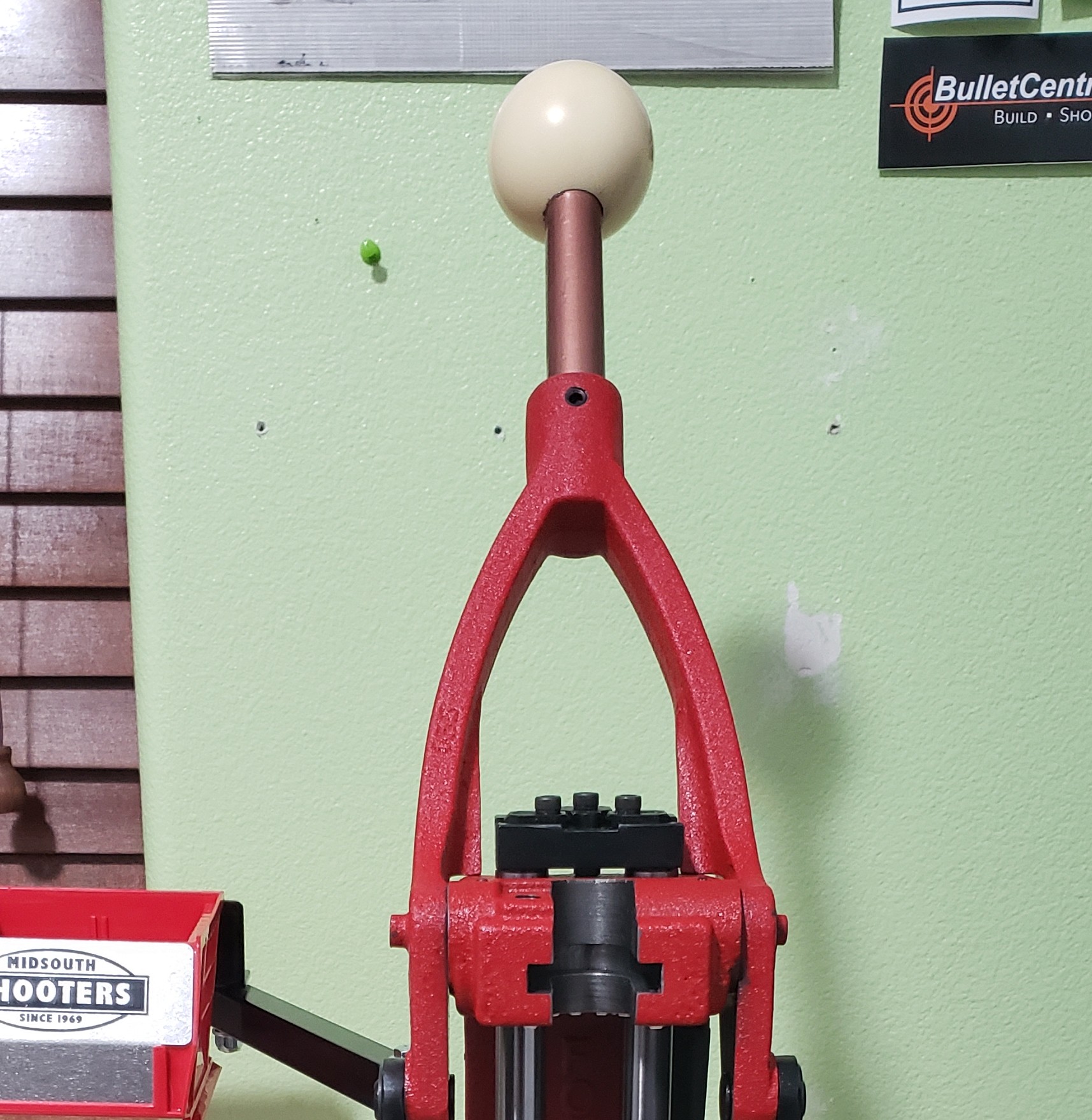

Started loading 223 on the CoAx and quickly found out 2-300 deprimes later I wanted a shorter handle. Not wanting to wait for something to come in the mail it was time to hit the garage.
It would cost about 15$ to make it if you had to buy it all.
Materials
-3/4" round stock
-Pool cue ball
-Jb weld all purpose
Tools
-drill with 3/4" bit
-bi-metal saw blade
-broken pellet grill as paint booth
The copper paint looked way cooler in my head then how it actually turned out. I will probably make another that's black with an 8 ball or 3 ball.
I don’t think the classic Hurst or the like would be good in use. Cool looking sure.
Part of the reason for the ball head is so the it can slide on your palm. This let’s you not keep the same wrist angle throughout the stroke. This isn’t the best explanation but think about how your hand orients when throwing the long foam covered handle vs. the round ball.
I much prefer the ball head.
