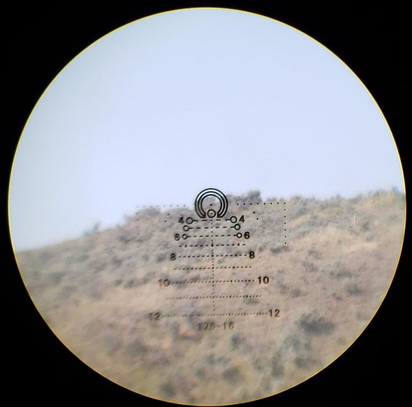

I’m using a 1-6x24 LPVO with the GRSC reticle on the 12” Grendel, just using holds in the tree. The reticle is meant for 16” .308 spitting 175gr SMK/M118LR at 1000ft elevation.
For 123gr ELD-M, I’m consistently getting MOA, but with the 110gr PPU fodder, I couldn’t get it to shoot under 3” at 100yds from either the 12” Faxon or 17.6” Lilja.
That “trash” PPU 110gr factory ammo is the only one so far where I’ve gone 3-for-3 at 780yds out of the gate, then made a 1st-round at 900yds on a 12” square plate. It wasn’t loud, but dayum if I wasn’t tickled with the performance. I almost wrote the ammo off as close range blaster ammo for assault rifle performance, nothing more. I’m glad I gave it a go at longer distance. Will be ordering more when it comes in again.
With 120gr Federal or 123gr ELD-M, I usually have an initial register just off the edge of 780yd steel bison you see above, then 2nd-round connect quickly and subsequent impacts with relative ease. If you look right below it, you see the 400yd plate, which is boring to shoot for me at least. The 900yd is off to the right. They move the steel around a lot there at this range complex though, so plates will be in different locations each time you show up, especially after NRL matches. I love that range. Nothing else like it that I’ve seen. This is only one of the many LR ranges they have there. The cowboy town is right to the left of this shooting position, a huge facility.

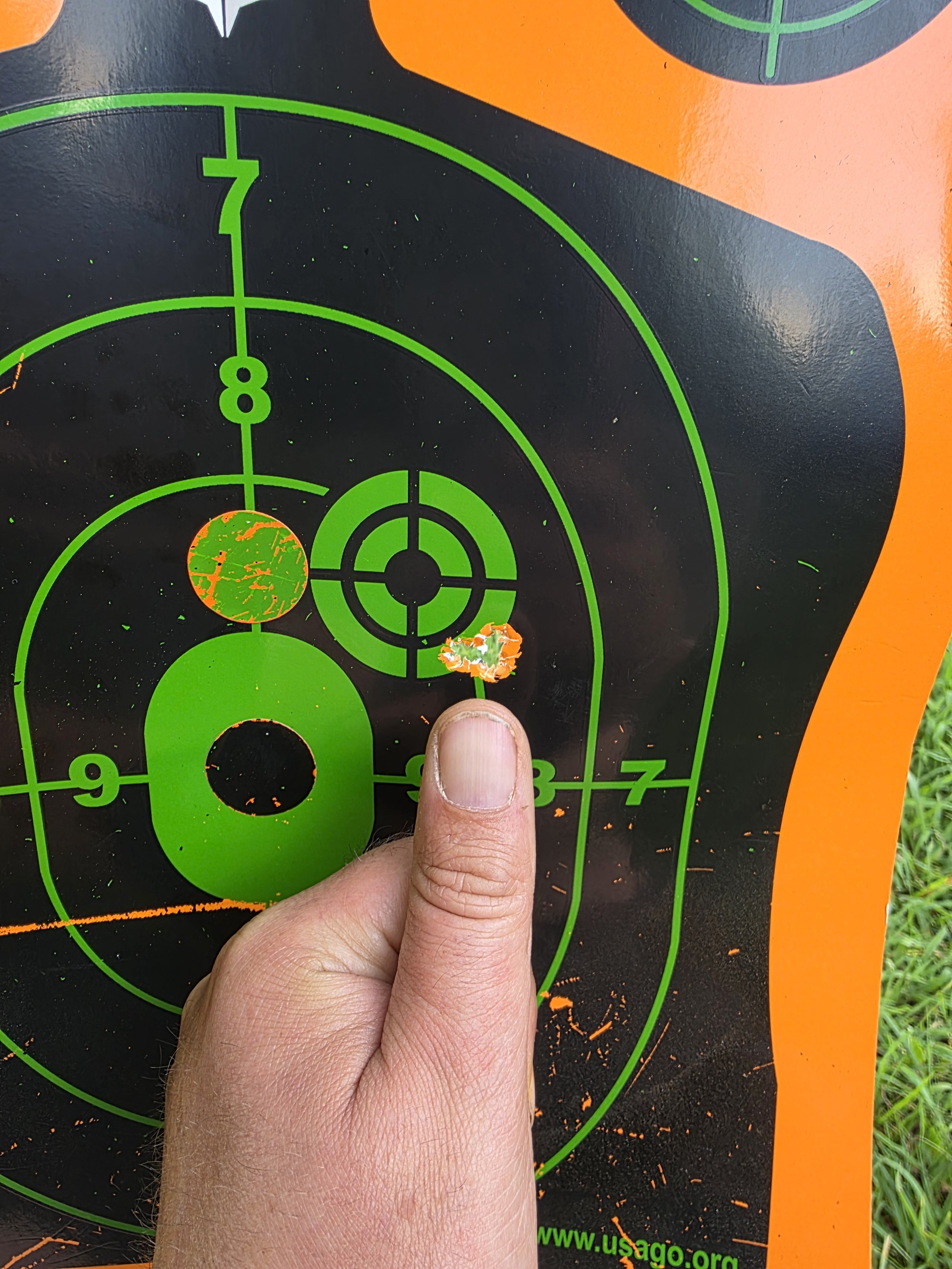

I started out shooting with a 1-4x24 GRSC LPVO. Those were discontinued Korean models because they broke all the time, and I’ve broken 3 of them I think, I just loved the FOV, reticle, and glass clarity so much on the ones I had that I was willing to risk it. The 1-6x24 is a Japanese and built like a tank. Mine initially had 1-4x, then 1-6x. The other one has NF NX8 1-8x24. Both are suppressed with TBAC Ultra Gen I suppressors, mine an Ultra 5, the other an Ultra 7 (more quiet but longer).

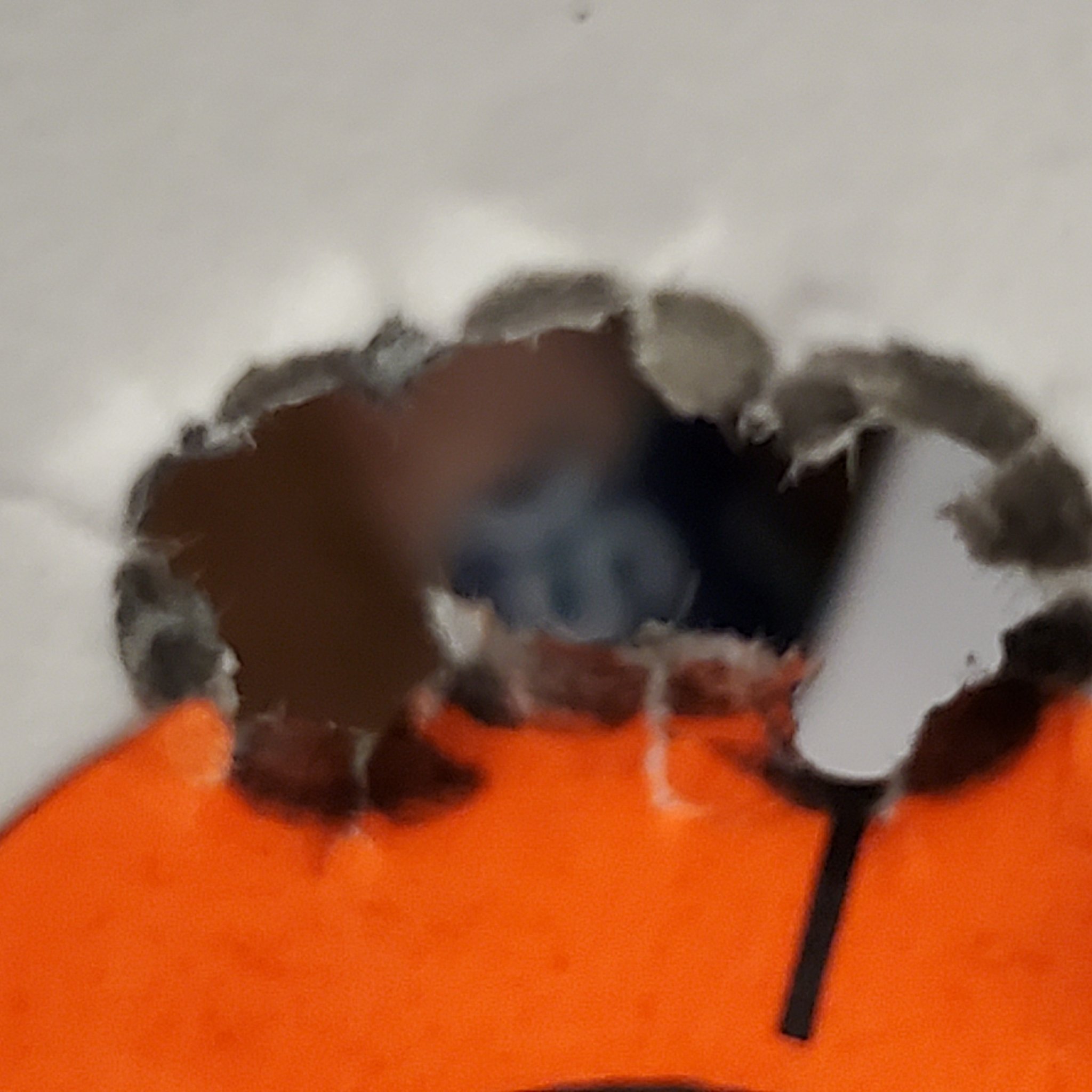

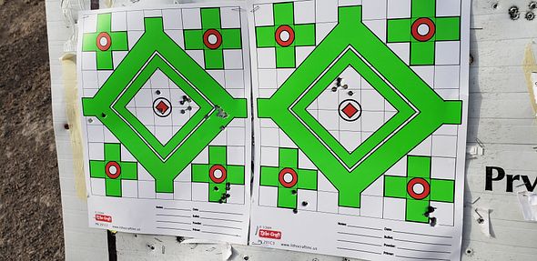

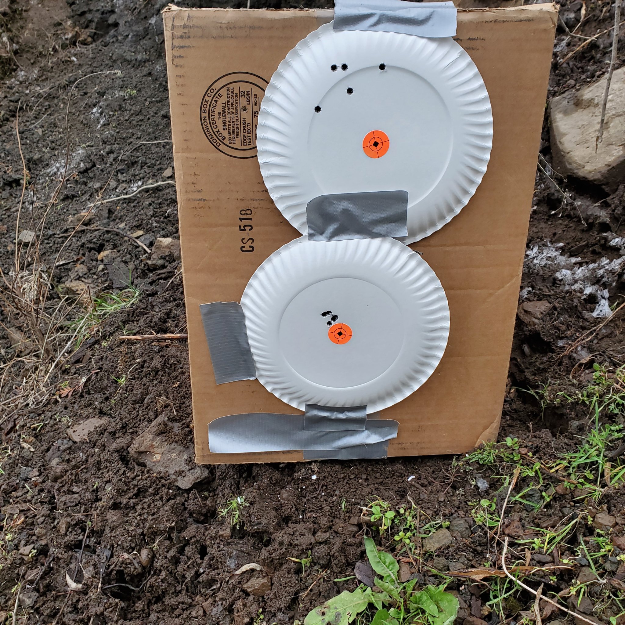

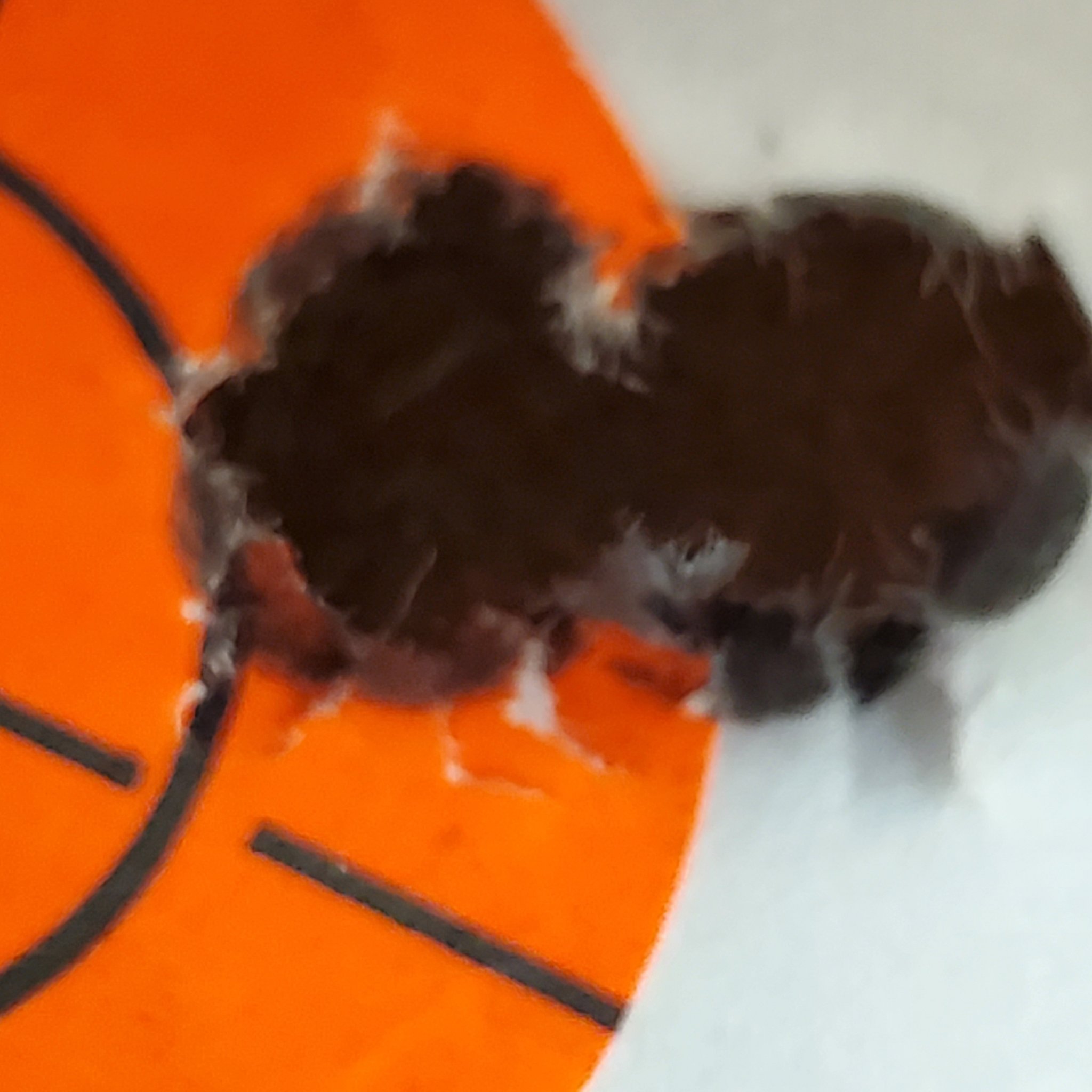

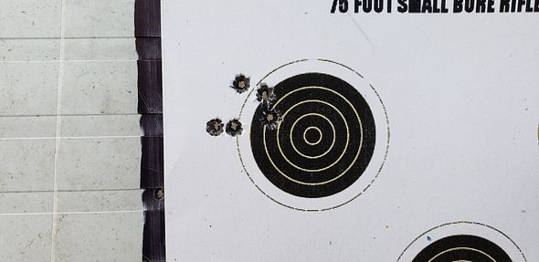

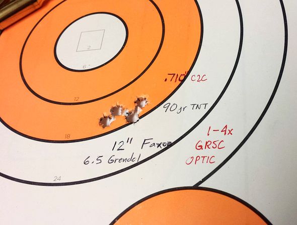

Here are groups from both 12” blasters with different shooters:
I think this was 123gr ELD-M and 123gr SMK hand loads, another Hide member:
123gr ELD-M box ammo:
90gr TNT:
Most of the 100yd work I’ve done for checking accuracy with different loads was with the 1-4x24 GRSC. 90gr TNT was shooting really well, as was 123gr ELD-M. I don’t slow-fire nor do I believe in slow-fire. I tend to group better on a cadence, just because I’ve been shooting for so long and like to keep fundamentals in a fast-paced delivery-on-demand mindset, especially for shooting conditions at distance. I blend sight picture, breathing control, trigger control, and follow-through with a solid Natural Point of Aim position, established and trouble-shot as best as possible to sling through center of the TGT.
