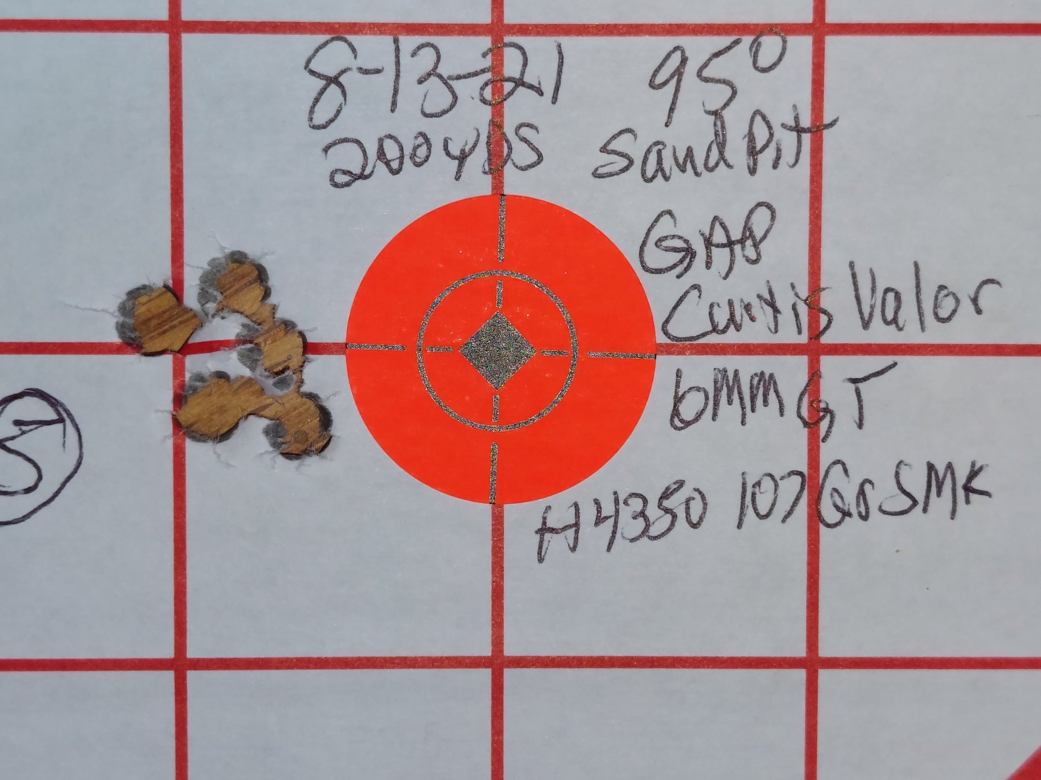

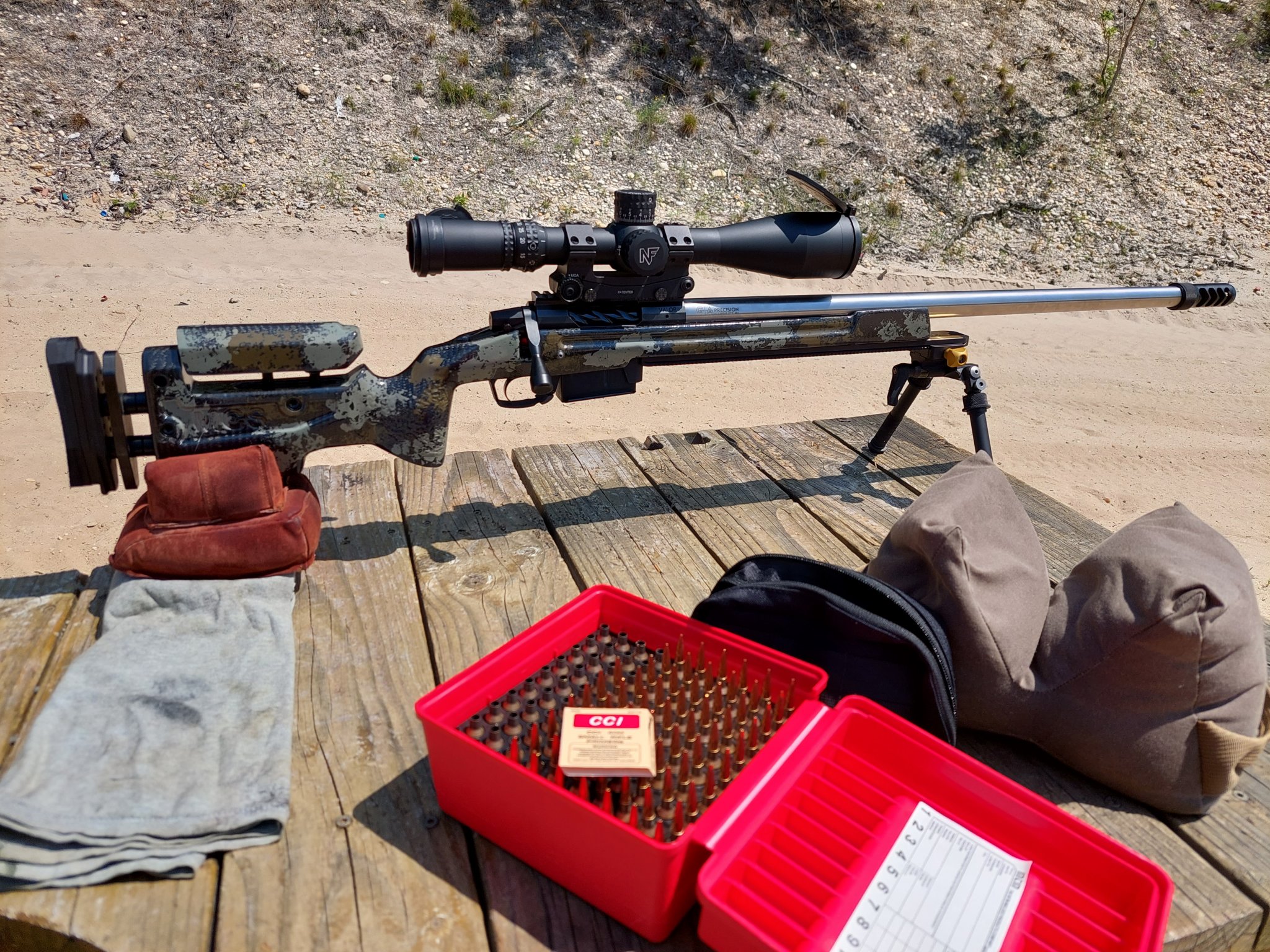

Here's my GAP built Valor, first time out with it. 200 yard group to boot. I'm plenty happy!
Looking solid. I'm on my 3rd gt barrel, they all shoot like that. Pretty easy cartridge to tune in. Shot quite a few 400y groups in the 2s and 3s with all them using Berger bullets. I really think the accuracy more depends on the guy who's chambering vs what action the barrels on. I've used an impact and a nucleus g2 so far. But I do like my bighorn 25cr in the wind over the gt.
