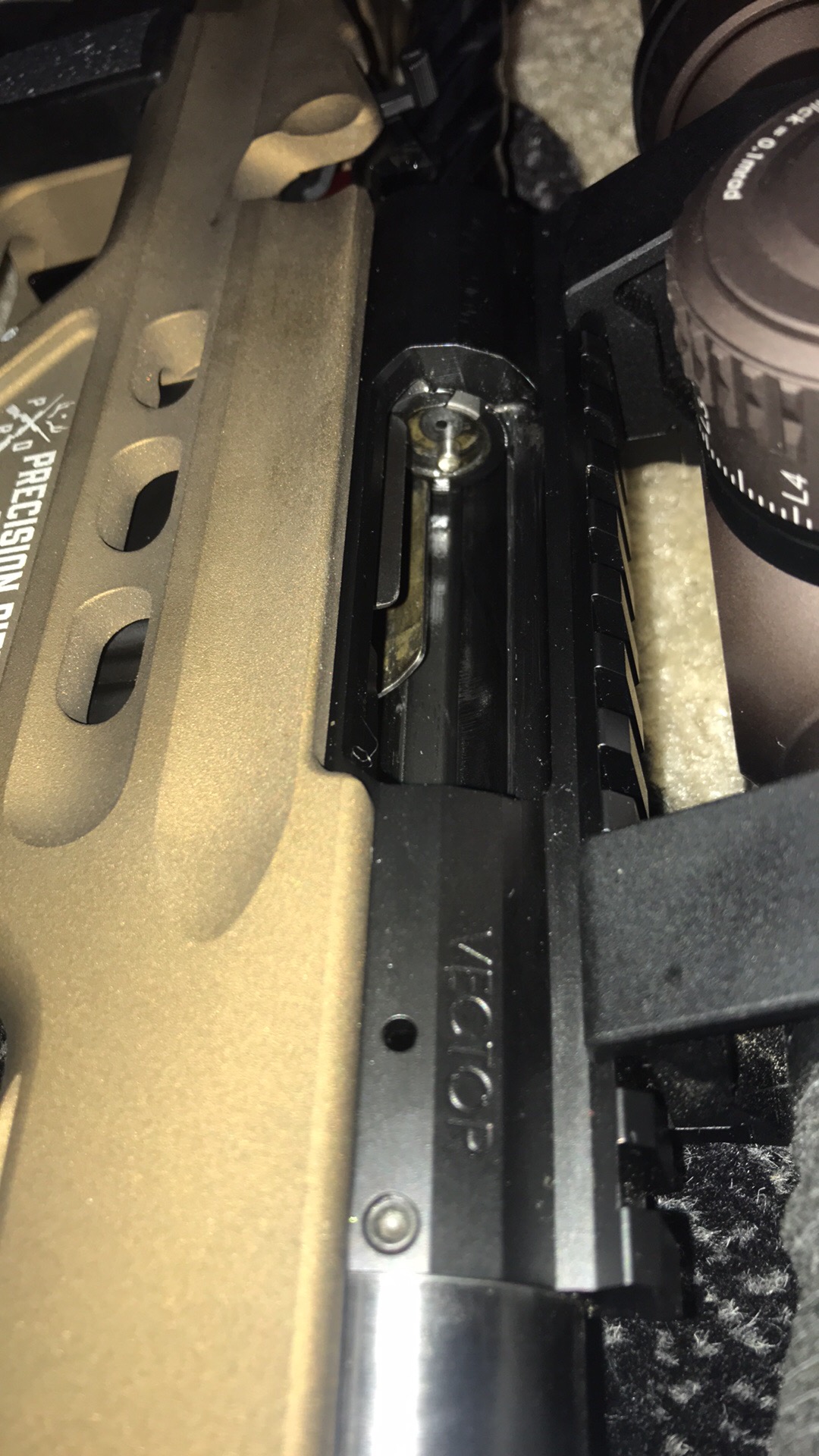

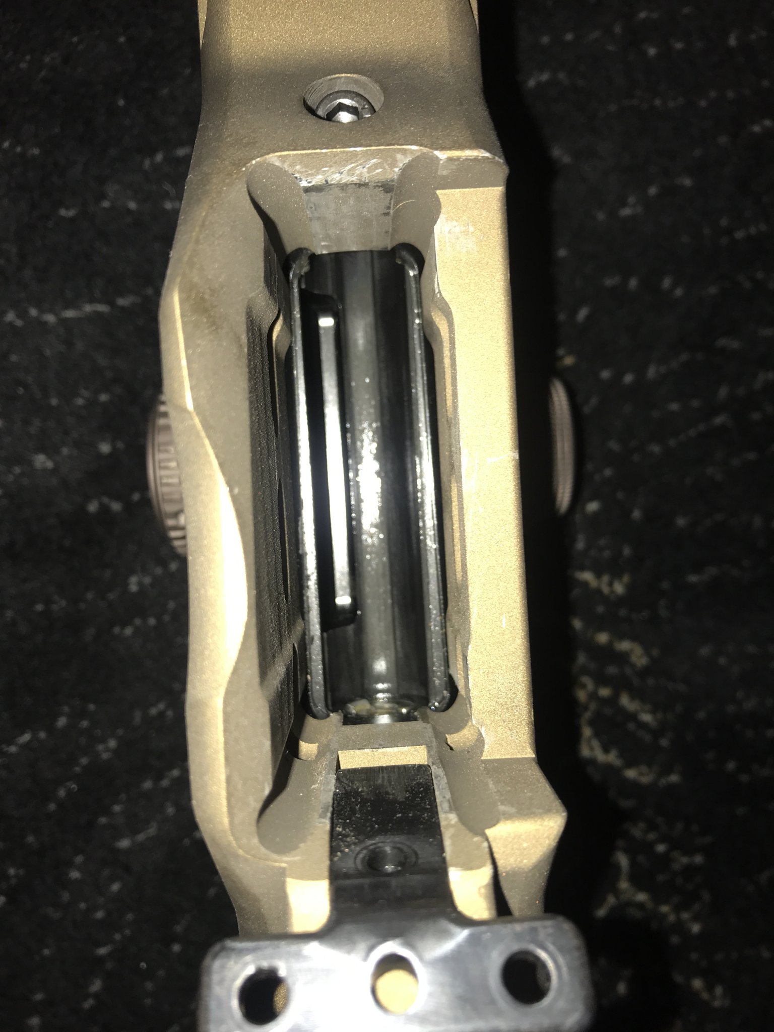

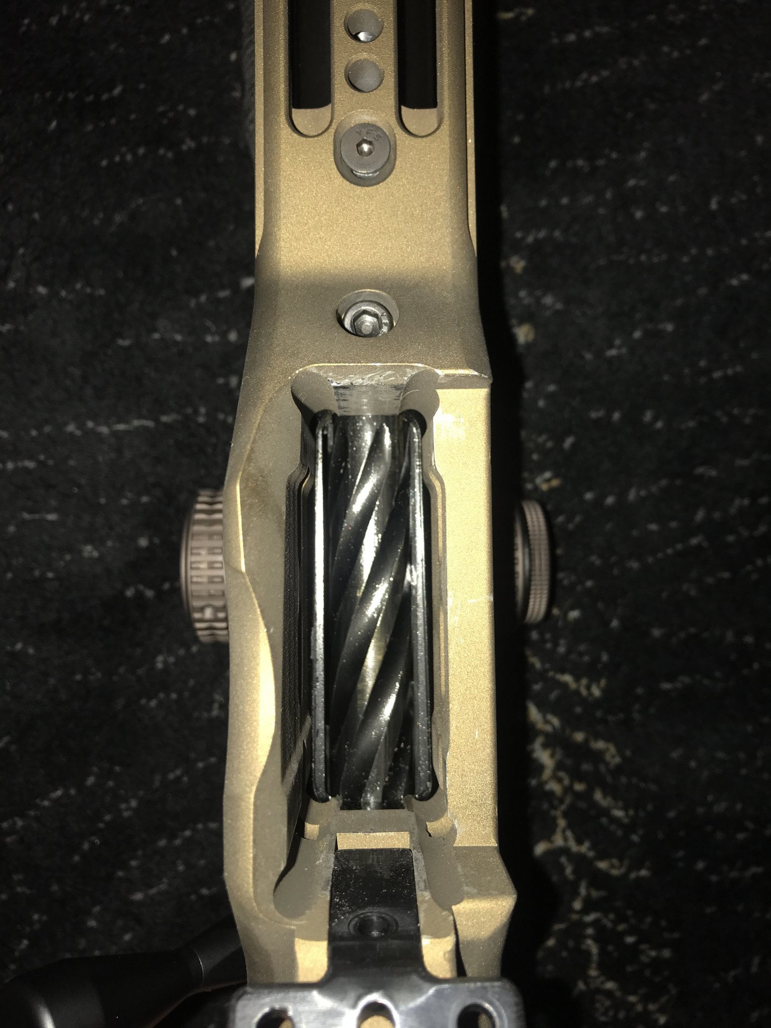

    Some pics for those wondering. If you filed the feed lips until the bolt didn’t hit you wouldnt have any feed lips left... for AICS mags that’s is
