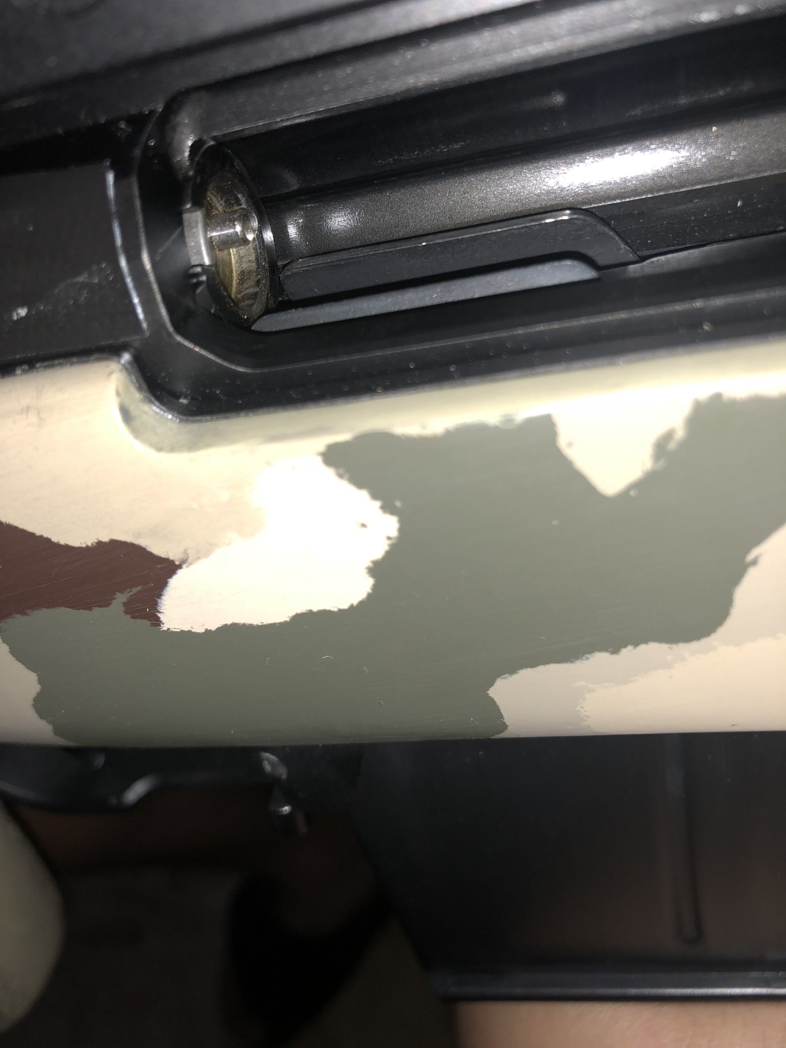

I think maybe its hard to understand without seeing it. If you open the bolt, insert an AI mag, and push the bolt forward it will not work. Every stage is mag in bolt back we do. So if you bump the mag AT ALL it will not feed your first round. Also, AW mags they say are super tight and some material needs to be grinded off the mag catch. This was the case so me and several others in this thread. So either you got a special/updated action or your gunsmith doesn't realize the issue.

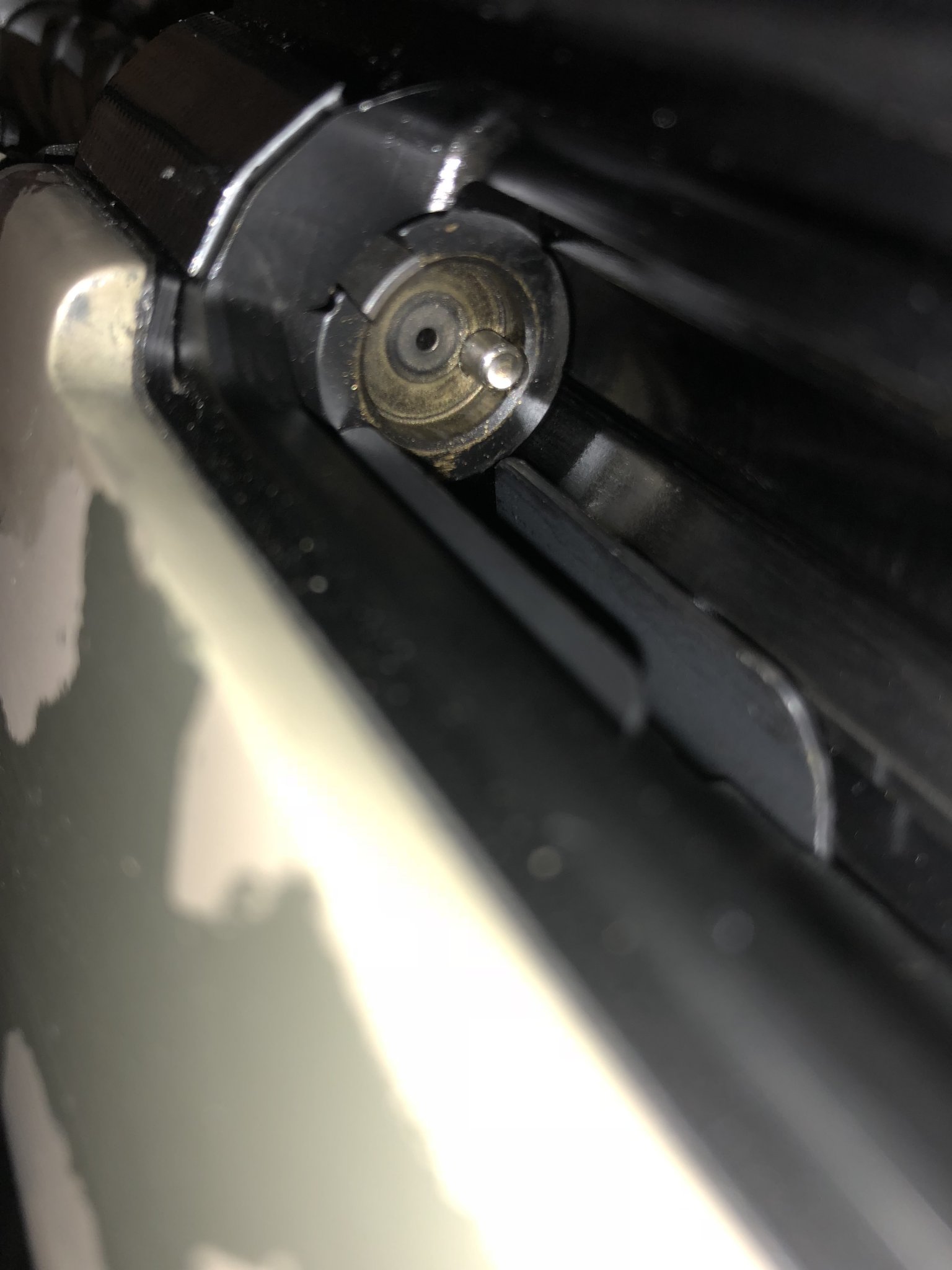

It’s not that it hits the feed lips, it hits the mag body. It goes so far up it literally hits the mag body damn near on the aics mags. Slightly exaggerated but you get the point. It’s too much feed lip contact to file down.

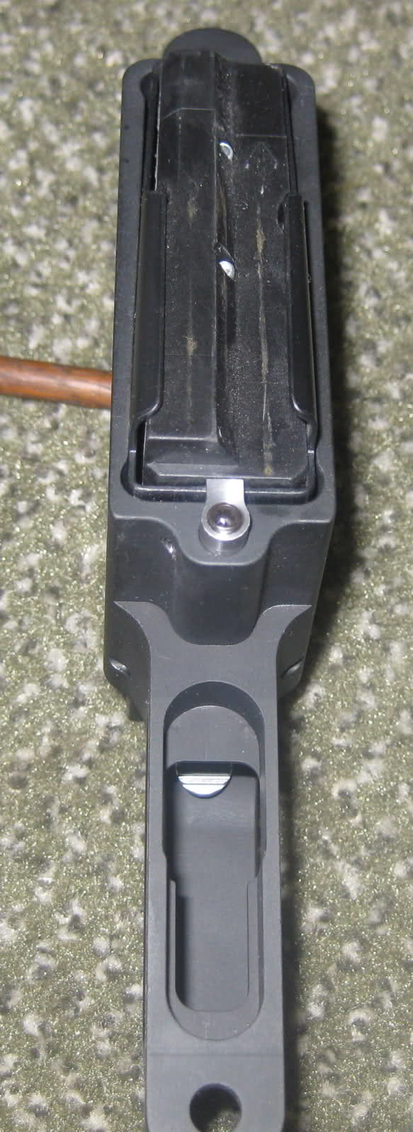

Got an update: Spoke with Phil at MPA and he came up with a Hardware fix to the problem. They are making a spacer that prevents the AICS mags from being over inserted. He is sending me several parts for free to try out on his chassis and the Vector. Speaks volumes to the type of shop MPA runs when they go out of their way to fix another manufacturers problems.... So long story short, if you plan to buy/run a Vector, make sure you get an MPA chassis, and it should feed AICS mags fine.
