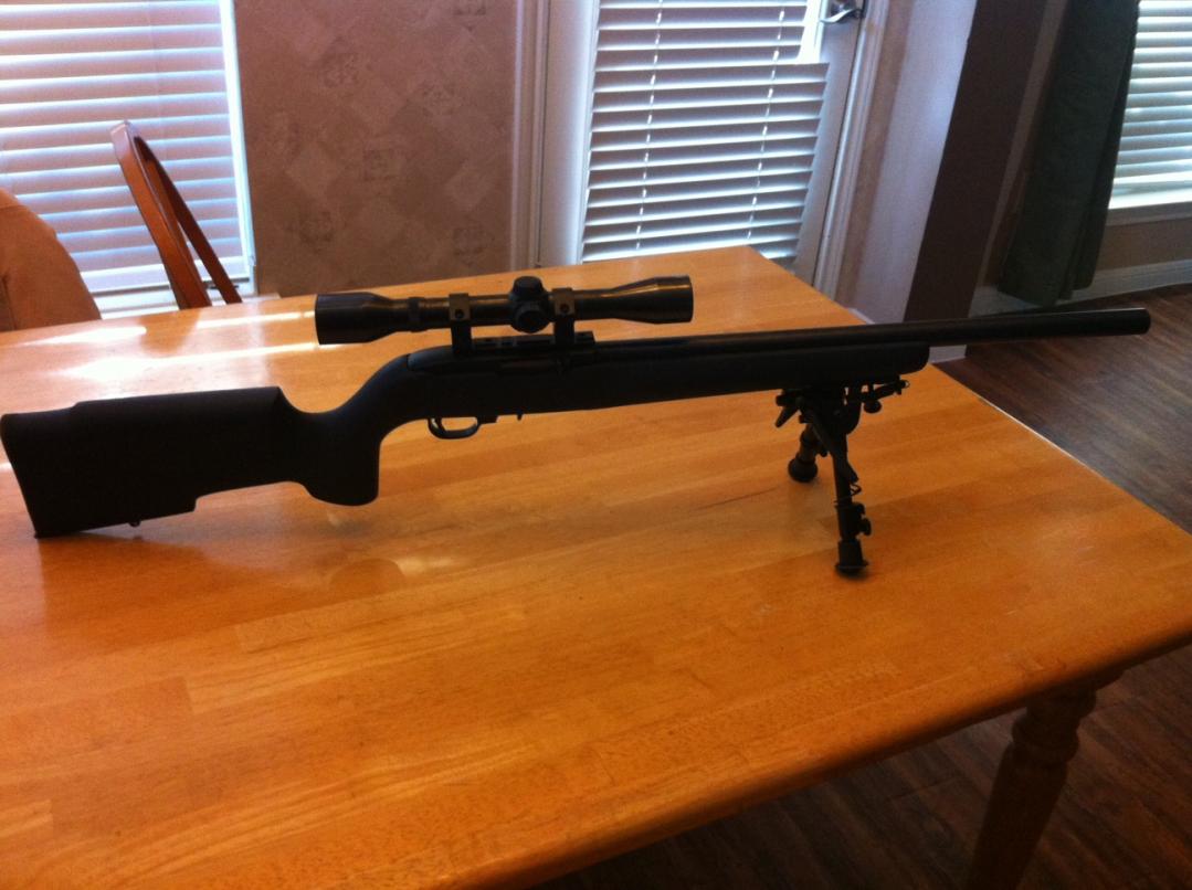

Tossed this together from misc parts, etc. Wilson barrel (awesome, but will probably replace with light weight barrel), Volq trig kit.

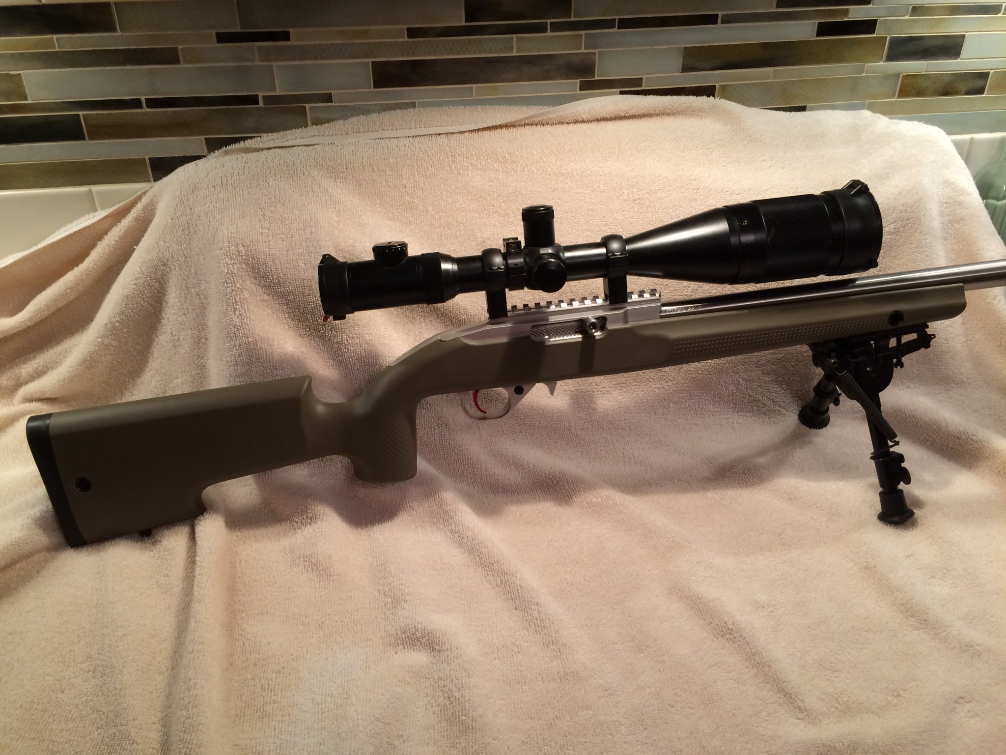

I just bought my first !0/22 a few weeks ago. All they had left was a Target model with a bright red Hogue stock. I bought it with plans to change the stock immediately. So far I have a TacSol Vantage stock, and a Viper Crossfire II 6-18 with Burris rings. Next things on the list will probably be a KIDD scope base, triger and maybe one day the light weight barrel.
EDIT...I didn't realize how crappy this pics are once they are uploaded from the iphone..doesn't do the stock any justice.
This morning my KIDD mag release and auto bolt lock came in the mail so I installed them too.
