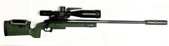

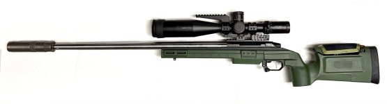

I would like to share my custom 22 Creedmoor build: "One Does Not Simply Buy One Bolt Action Rifle Over A Lifetime"
  • Action: Impact Precision 737R Receiver
  • Chassis: Kinetic Research Group (KRG) Bravo Chassis in Sako Green
  • Trigger: TriggerTech Rem 700 RH Diamond Flat Clean in Black/Red
  • Barrel: Preferred Barrels Pre-fit, 26" Stainless Steel Polished, 1-7.5" 5R twist
  • Barrel Contour: MTU
  • Threading: 5/8"x24
  • Barrel Treatment: Hand Lapped
  • Muzzle Brake: Next GEN ECTuner
  • Scope Mount: Area 419 Cantilevered Tactical One-Piece
  • Scope: ARKEN EP-5 7-35X56 Gen 2 FFP Illuminated VPR with Zero Stop and 34mm Tube
This setup combines precision and reliability, drawing from recommendations and experiences shared by the Sniper's Hide community. For instance, the KRG Bravo Chassis is praised for its ergonomic design and modularity, offering conventional target/varmint ergonomics at a reasonable price.
kineticresearchgroup.com
Just wanted to hear your thoughts or answer any questions about this build.

Not a bad build, should shoot really nice. I am just finishing up my 22 creed build. Have you tried the scope and the Chassis at the store or range? I question why you chose an Arken scope with what is mid to upper range build.
I hope to shoot and zero it this weekend and see how it shoots. I have Area 419 mounts on all my Bolt guns, I run Vortex Razor HD GEN III MRADs on the rest as well, but wanted to just try the Arken out and see, It' does have great glass, but it's not as good as the Razor, you also have to mess with the parallax more on the Arken, it's not as forgiving as the Razor.
For the Chassis, this is the first KRG chassis I have bought, I have MPA's on my others, 6GT has a Vanquish and 7 PRC has a Matrix.
Mine is a ZUES action, CRB Comp contour chambered and finished by Straight Jacket Armory, Foundation Samson stock with MDT M5 DBM, ZCO 8-40 MPAC 3X in a ZCO mount with a Bix'n Andi TacSport Pro X 2 stage trigger. I am using the Area 419 Hellfire mount system to use a CAT JL suppressor.

I've got mostly mid to upper scopes/ gear but I have an Urge to try one of those DNT "TheOne" scopes just to see.
