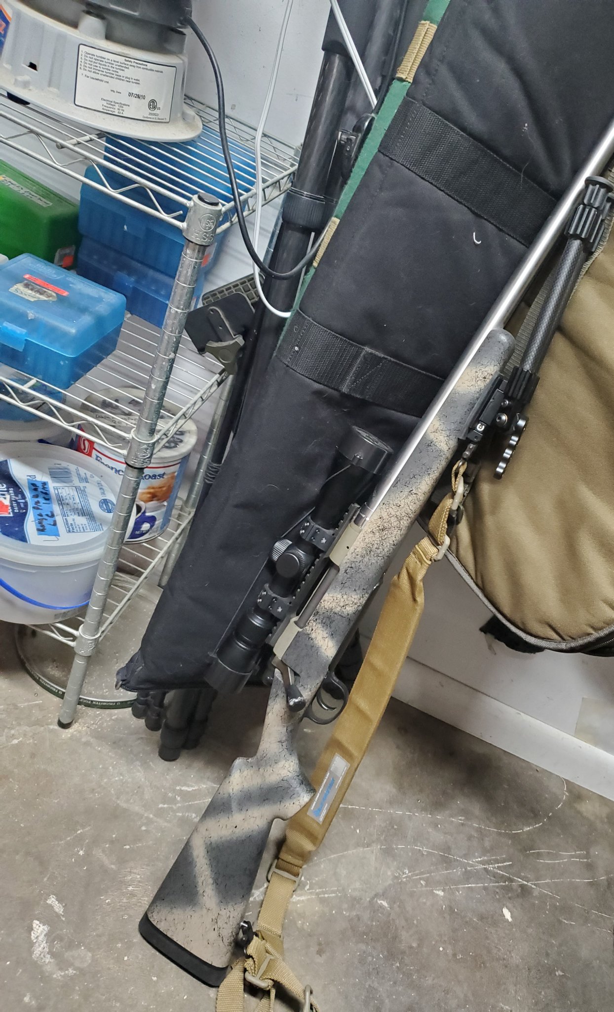

Something like this? Greyboe outlander is only 33oz. The rifle has a #5 contour, so the barrel is a little on the heavry side. It weighs 175oz with bipod sling and a full magazine. I proabaly could have saved another pound or two with a sporter weight barrel. I coukd save a few OZ on the one peice nightforcs base. The scope is 15oz and I think the bipod is around 10oz.

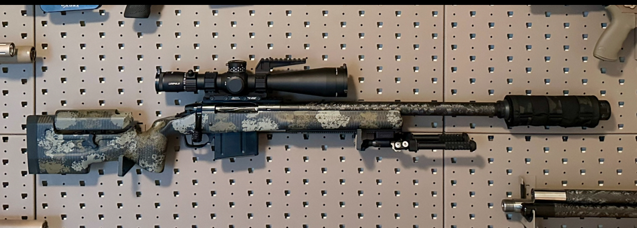

This is my hunting 300WINMAG. It's proven itself many times and I love it. If I were to start over, no DBM. I may end up changing it out but it works good now and I hate to fix it if it ain't broke.

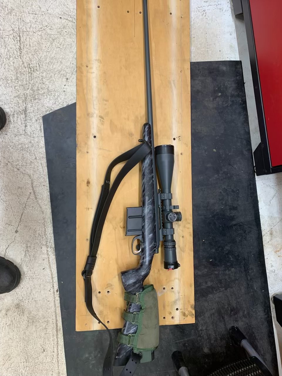

Here is the other 300WINMAG I have. It's really too heavy to actually hunt with but I take it out bear hunting. The way my brother and I hunt bear is to go where there are bears, find a place where we can see a whole lot of country, park the lawn chairs beside the coolers and glass, glass, glass. Most shots are over 500 yards, this rifle is perfect for that.
Both of these rifles were built by Charley Robertson at ScoreHi in Albuquerque, NM. I asked him to cut the chambers as close to being exactly the same as he could. Both have 28" barrels. My goal was to be able to use ammo interchangeably. It worked. I don't have to worry about which ammo is used in either rifle. This one has pretty much only shot 210 Berger Target while the other one has primarily only shot 210 Berger Hunting. But the zero does not change at all if I swap to the "other" ammo.
