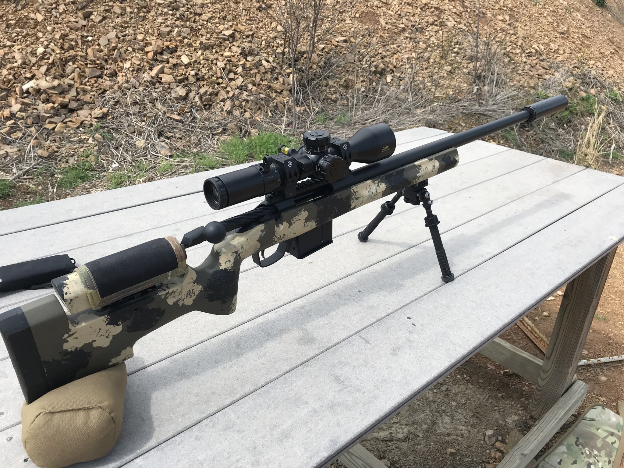

I’m a Tikka fan. I have two, the one pictured has been completely upgraded, minus the action of course and trigger. The Tikka action is so smooth and I love the trigger as is. From the factory they are hammers and wont hold you back. I cannot speak to the Origin, but have heard nothing but good things. You won’t go wrong with either.
