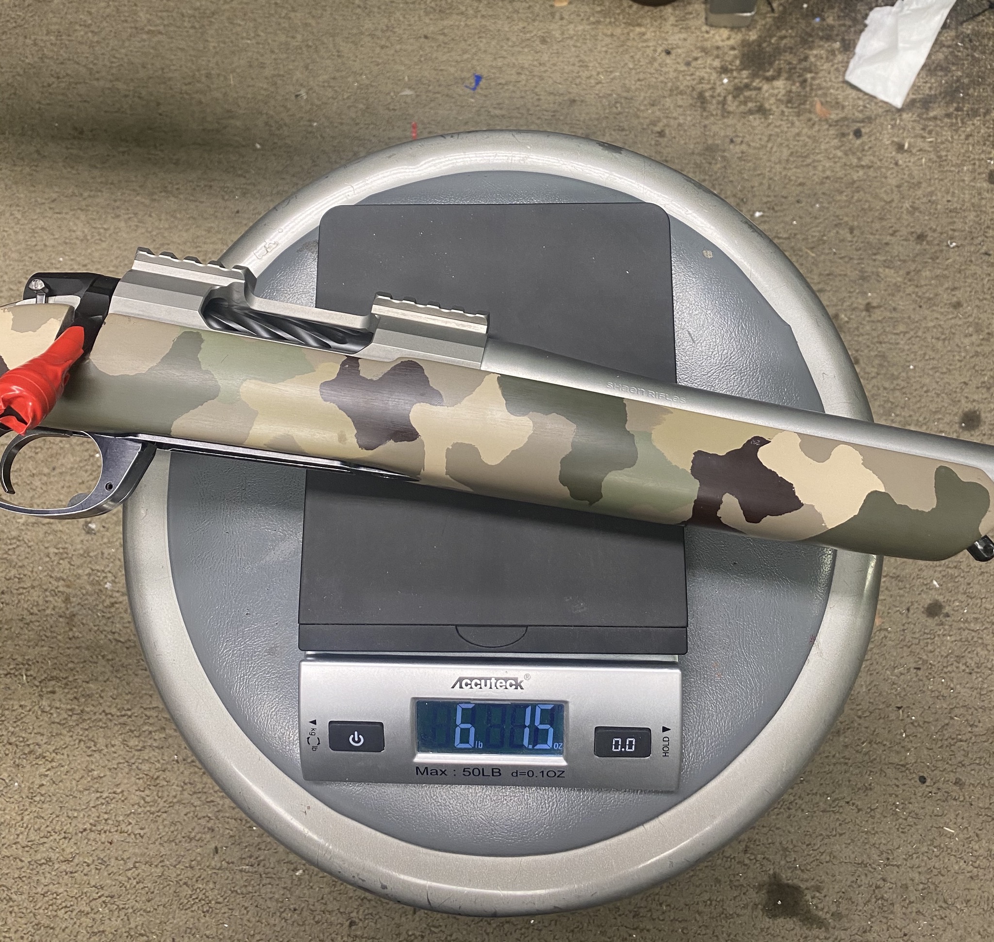

He stated he wanted a long range HUNTING Rifle so with the TI he can get a little liter...

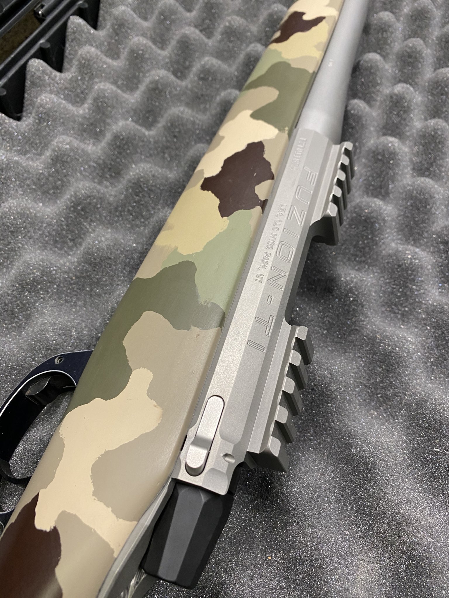

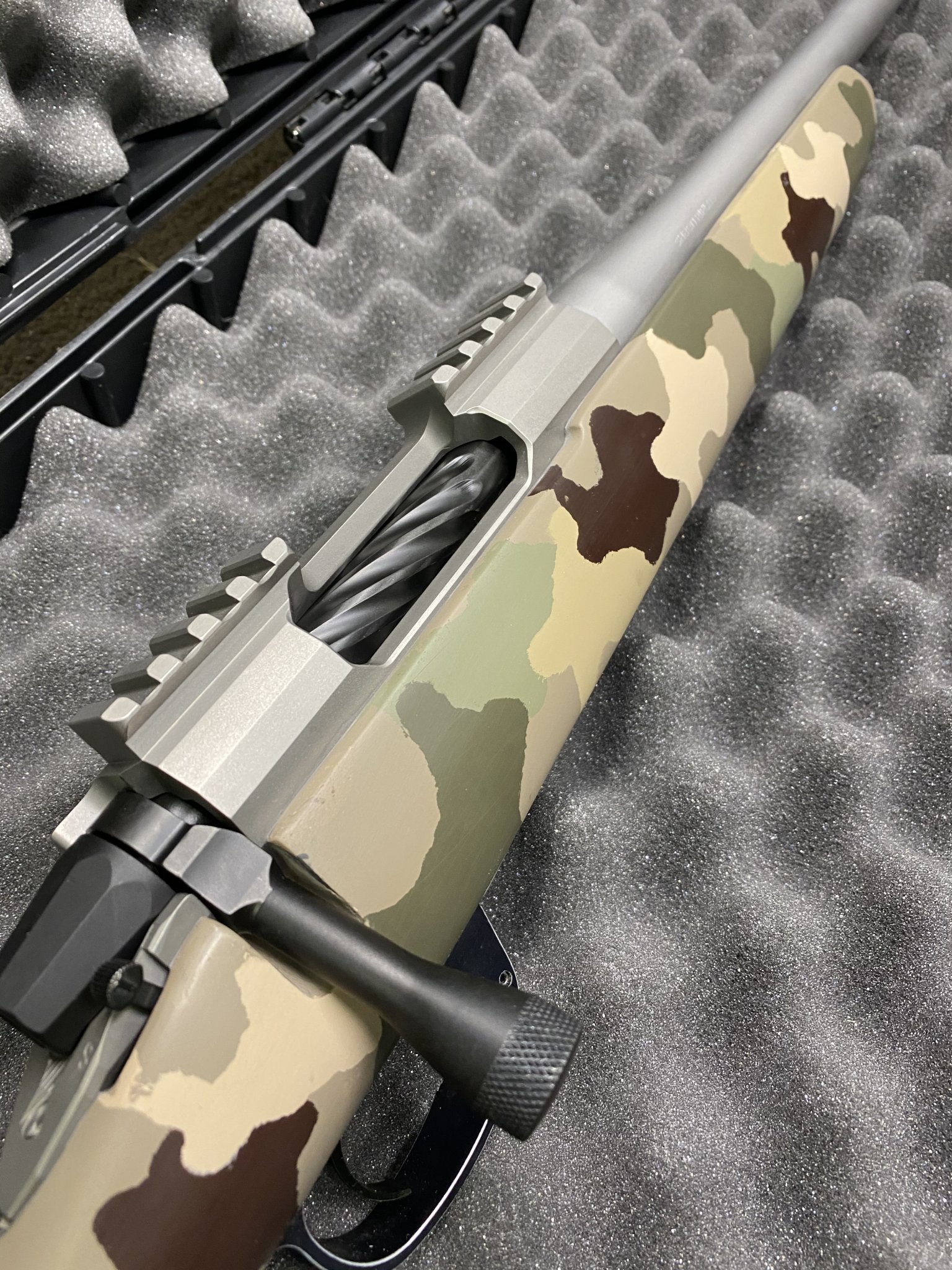

The Fusion Ti makes for a very nice hunting rifle. McMillan Mountaineer.
