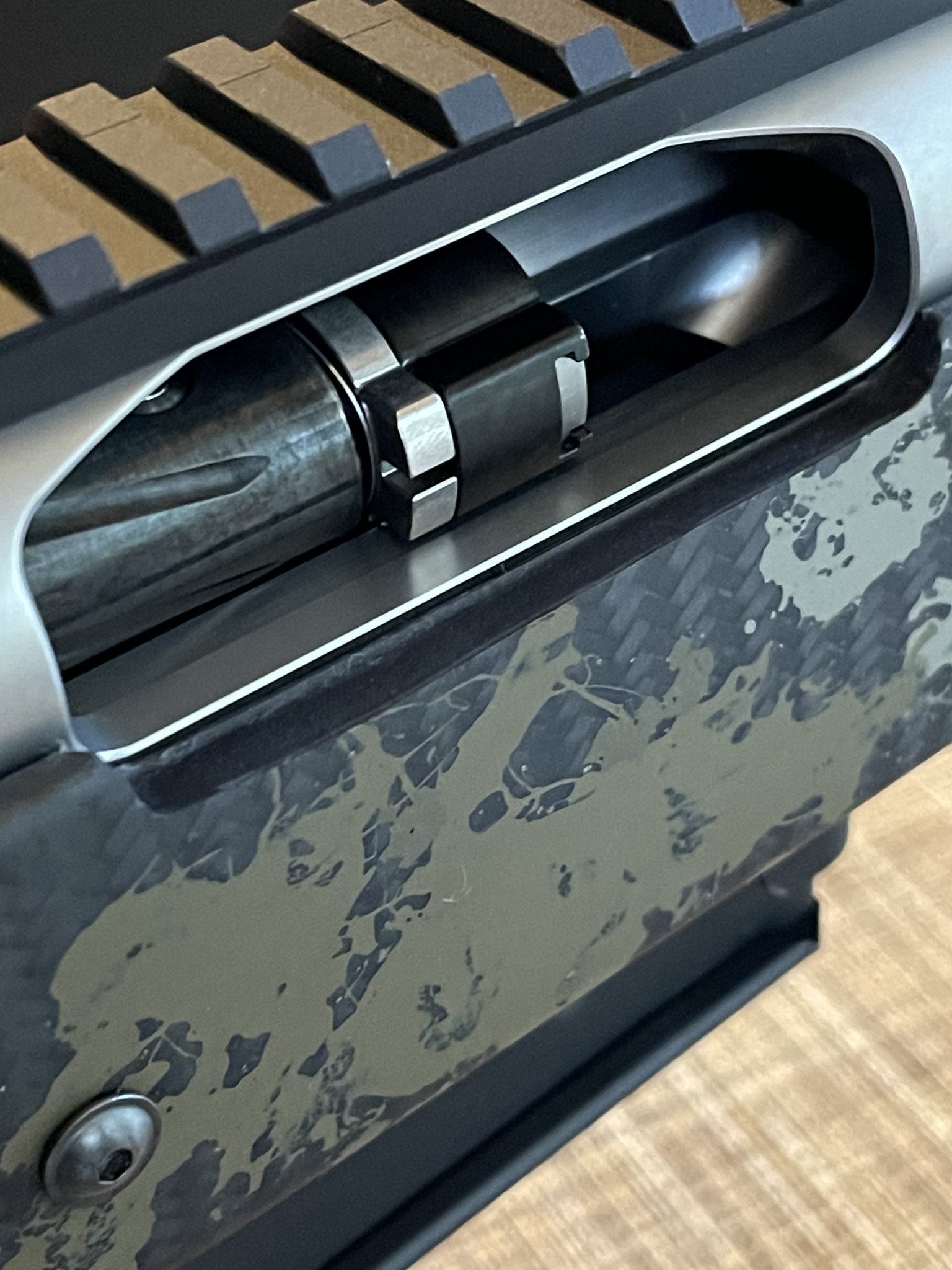

I opened mine up to fit. TL3 left bolt right eject. Manners with the mini chasis. I think it came out good considering it’s a left handed stock that had no cutout for the port at all.
Reactions: 2Twenty3
With the bolt removed I scribed the inside of the stock with a dental pick. Then removed the action and grabbed my small files and went to work. Carbon fiber is very easy to remove so don’t get carried away.
Reactions: 2Twenty3

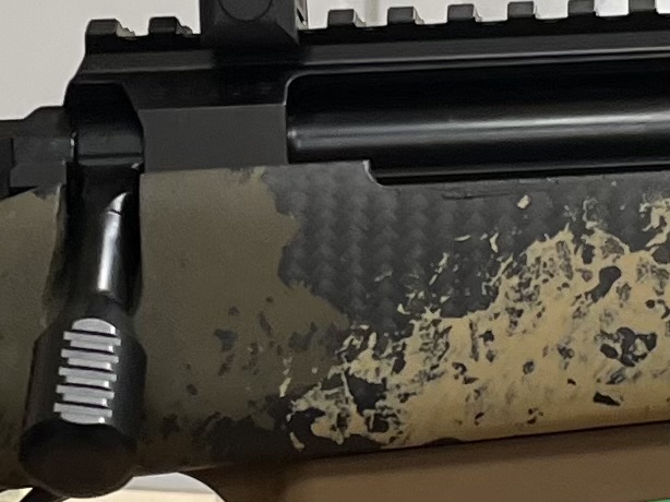

Here's my TL3 in a Manners made for a 700. You can see the rear ejection port has a little hang over but does nothing for function so I just left it like that. Hurts nothing.

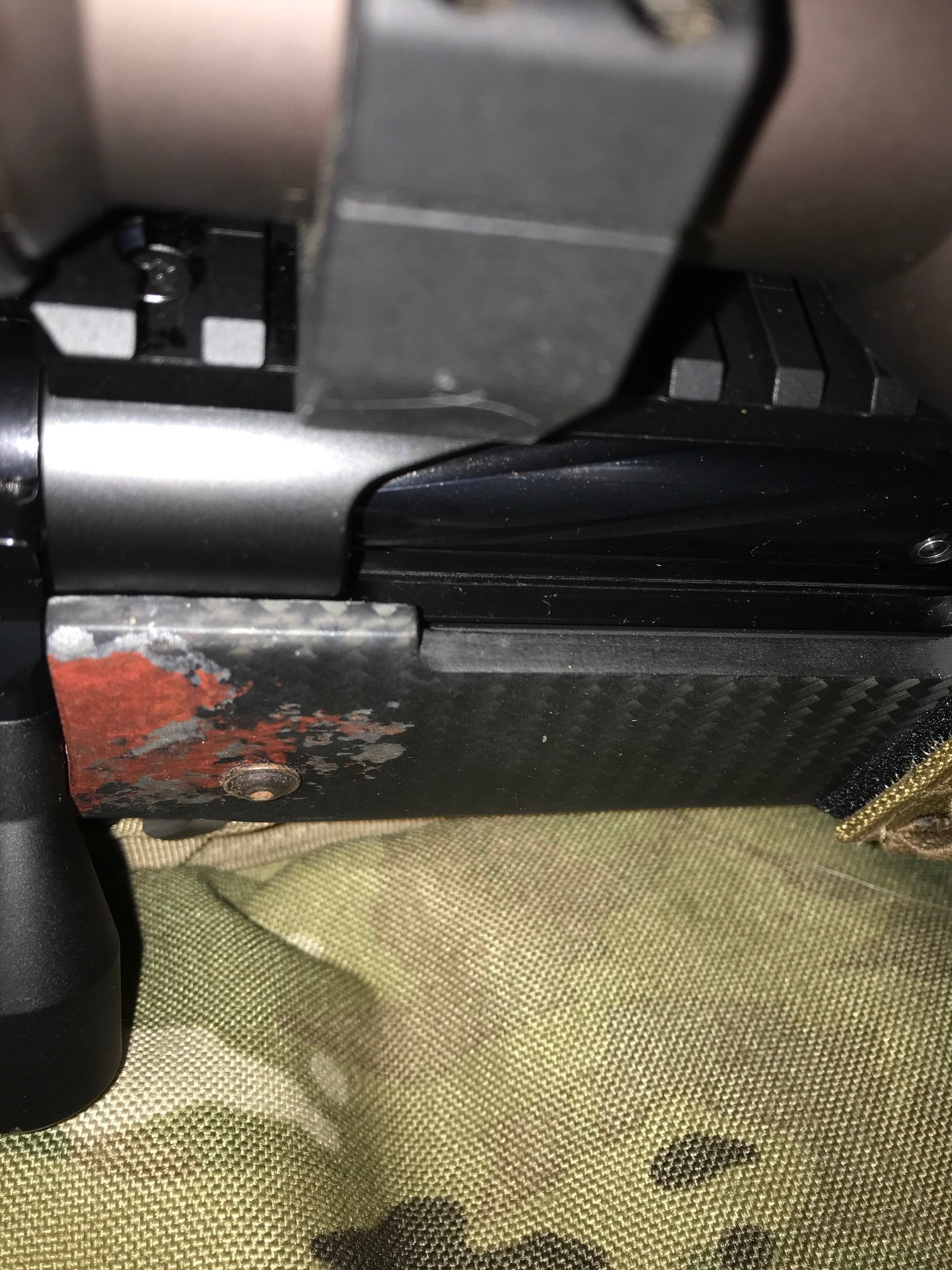

Manners 700sa with an Aero Solus. As stated above, doesn’t impact function but material is easily removed with a file. Cover it up with some black paint and it looks normal again.
And a dremel cutting blade to take out the larger part and then a small sanding wheel makes the job a fast one.
