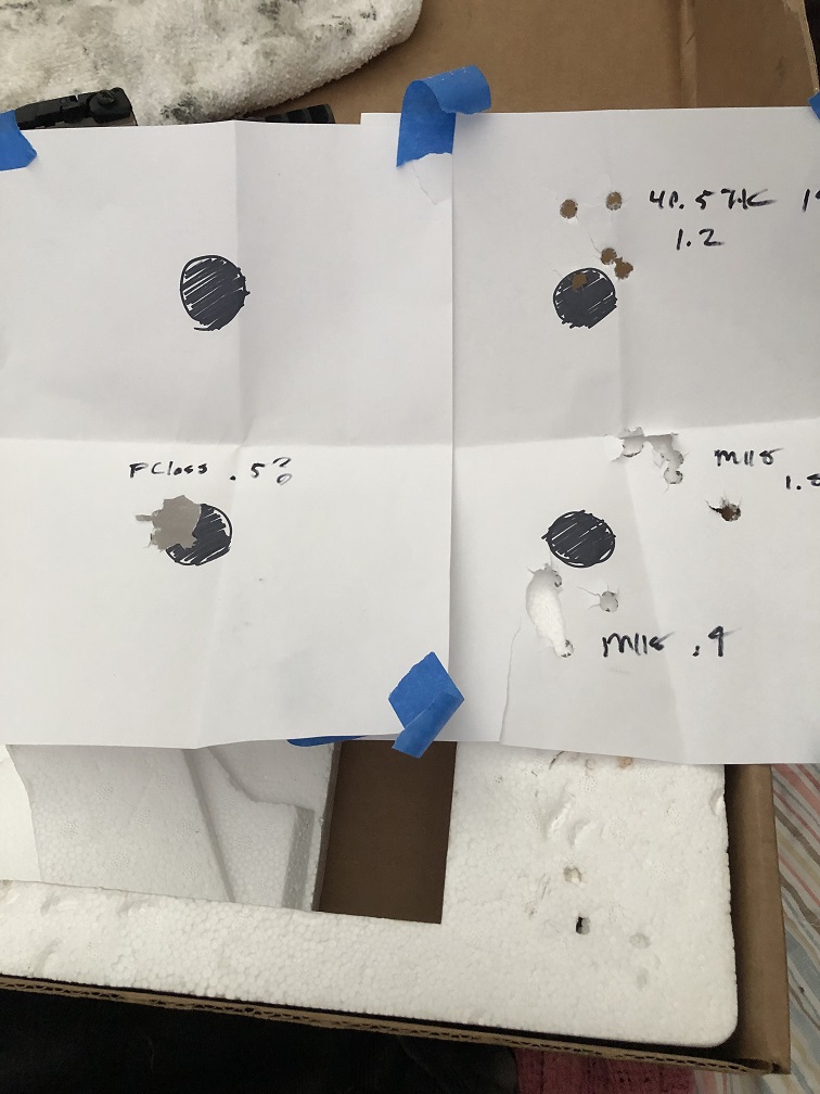

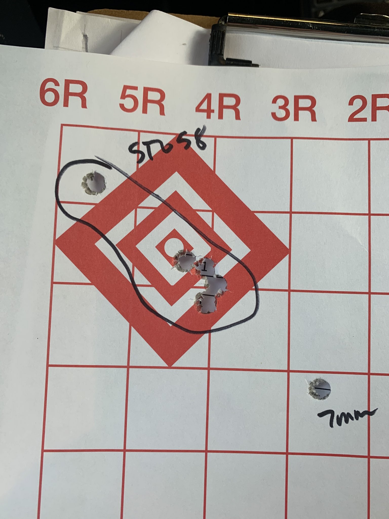

Ok, to anyone still interested in this thread I removed the muzzle break and shot both the 150 gr freedom munitions and the 168 gr FGMM. The point of impact is now at the same place. It puts 3 shots in about 1/2 moa. then the last 2 start to walk to 1 moa and 2 moa respectively. This pattern is consistent. I added a strike industries Jcomp Gen 2 and the pattern stays the same. I believe the big heavy comp I had before was affecting barrel wip. I don't really expect to be shooting more than 3 shots in quick succession so I think this rifle is good.
I want to thank all the people who provided helpful tips and suggestions.
on another note I built a 6.5 Grendel and tested it also and It will drive tacks.
Glad you found a cost-effective remedy. If group suck with a muzzle device on, always try with it off first as it might just be a harmonics issue.
It's harder to determine when you have just put everything together, but starting with the cheapest "fix" first sure can save you a lot of money.
Reactions: themightytimmah
Part of this journey was to become proficient at diagnosing problems with my builds. The people on this site have helped me grow in this respect.
I have a 24" 1-10 Krieger, and my accuracy was total crap when I tried every brand of match ammo I could find. I finally got some fgmm with 168 and 175 smk's, and that finally started to tighten everything up. Now I'm shooting 185 juggernauts, and 200lrht, and it loves them. Just to test my theory 5 years later I bought the new sierra 169's and the shot like crap. Straight back to heavy and tight groups again. My theory is the 10 twist is just too much for lighter 155 grain. And I am only talking about my gun specifically (armalite ar-10t 24" Krieger heavy target barrel), not in general...
