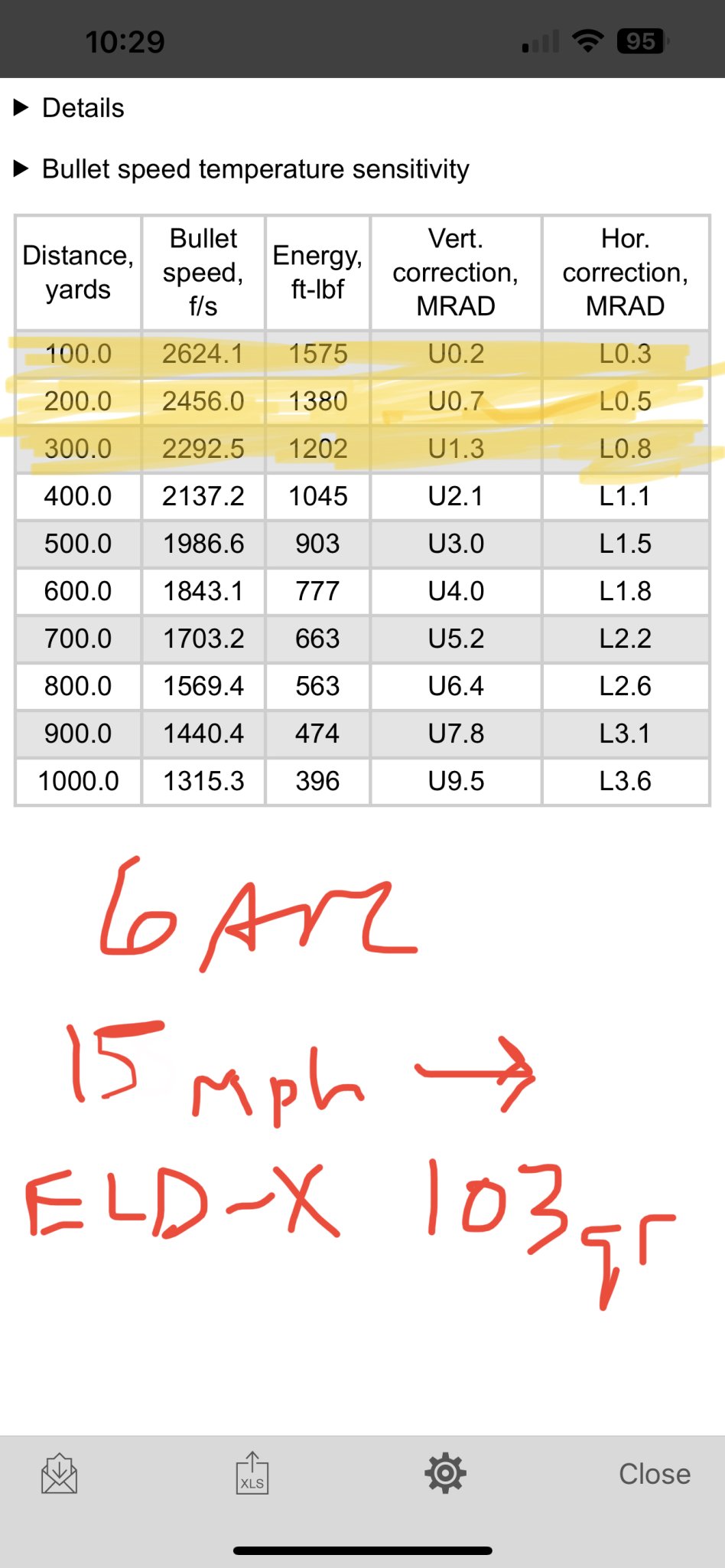

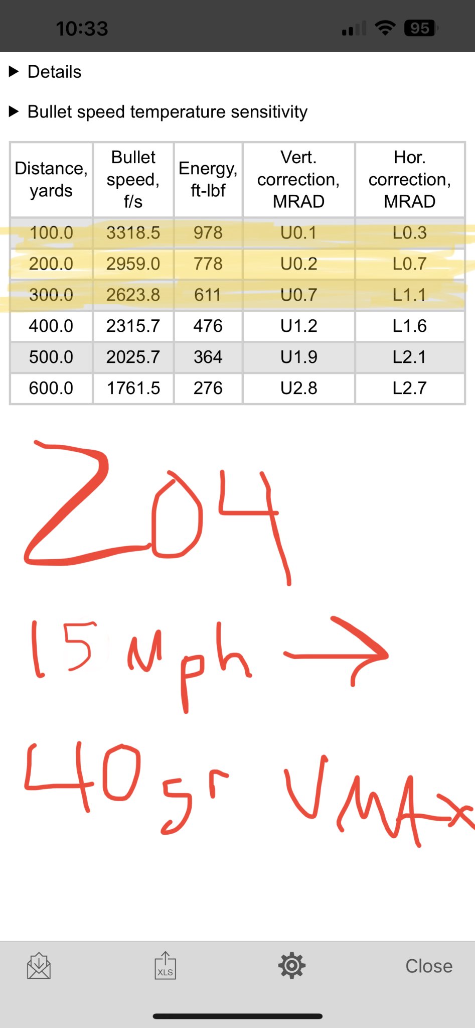

Caliber:
Between these two 204 and 6arc factory loads, 204 is way way waaaay flatter out to 300.
15mph left—> Wind:
100yds equal
200yds: 204 is .2mil more
300yds: 204 is .3mil more
0-300 yds 6br is roughly equivalent to 6arc, and 223 is definitely worse than 204 w/40gr vmax. A 204 w/32gr vmax in the same conditions as above is even flatter but is definitely worse in the wind.

204 is so fun man. So, so fun.
Edit: my 40gr 204 numbers are trued, the 6arc are not. So I suspect the actual real-world ballistic gap will be even more in favor of 204.
