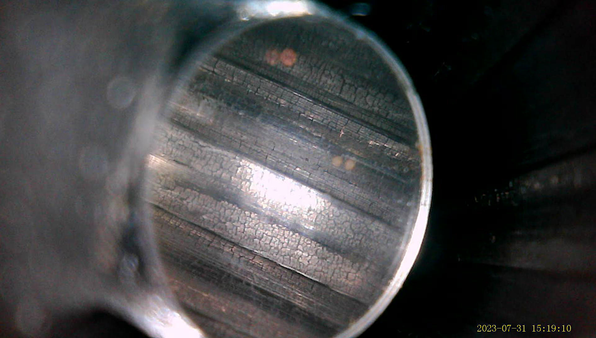

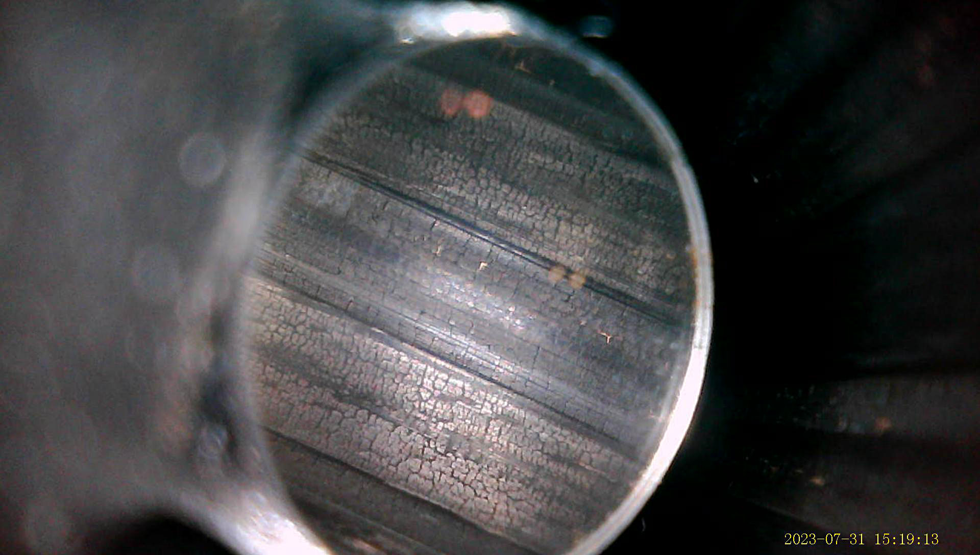

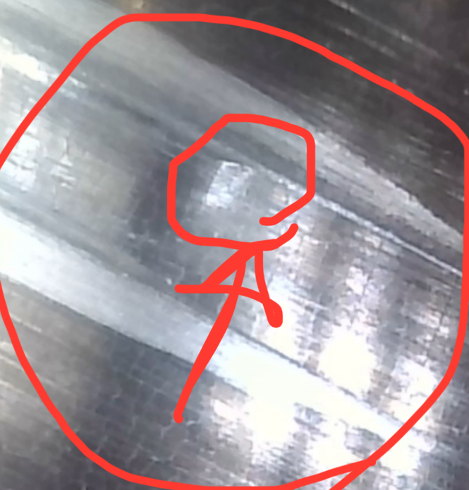

You need glasses then. This is a machining anomaly. Nothing to do with normal fire cracking.
Are you familiar with with machining?
I have zero idea why you are upset. I said nothing offensive to you at all.
As for that little spot in the groove, dunno what it is. Looks a lot like the reflection seen elsewhere it the pic. Ot it could be a very small flaw. I can’t really tell
Cheers and I hope your day gets better. Positive energy, yeah (y) 👊
I’m not upset. No real insult intended.

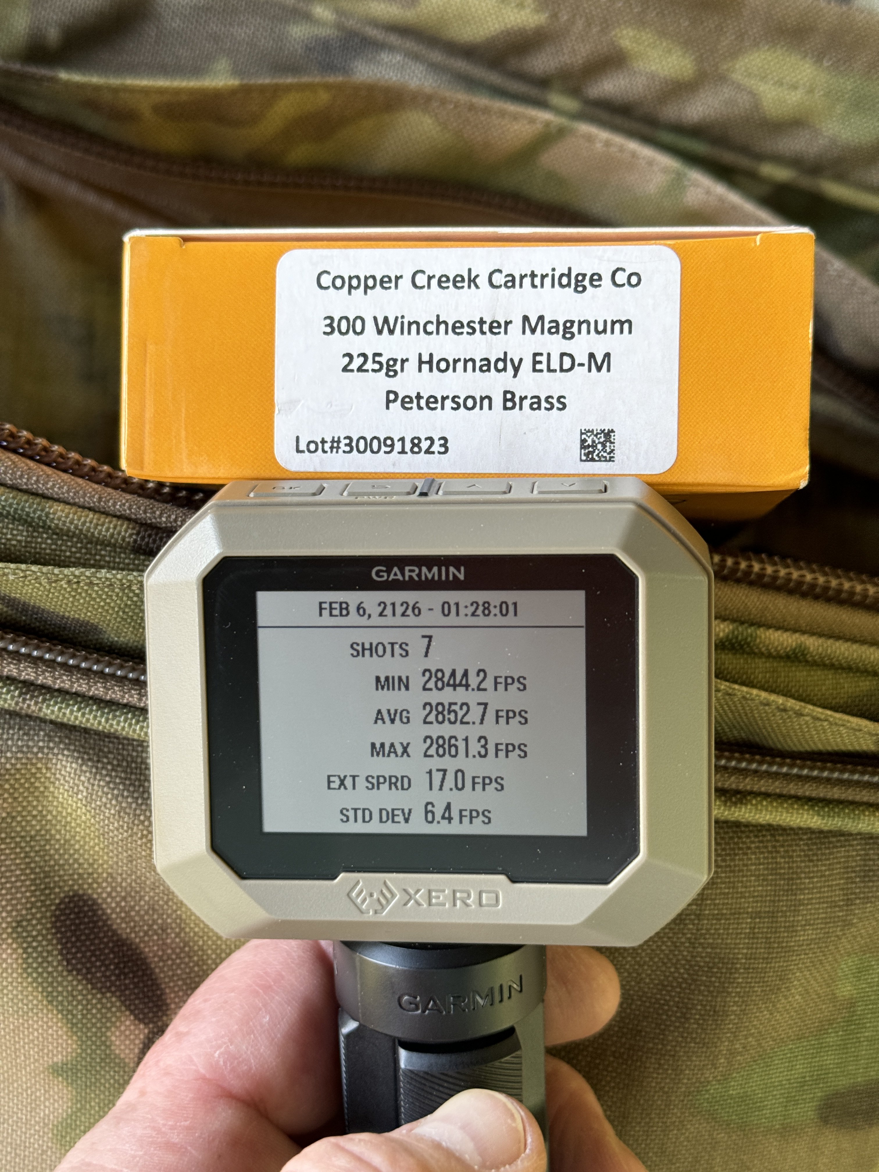

Rifle also stabilizes 225 ELDM without any issues... also same hole... not the same velocity...
The SD on the WTC 180 could’ve been better, but I used a whole bunch of Peterson brass I had lying around that had never been shot before… History tells me that the first reload on that brass will cut it down in half.
I can only imagine what velocities I get out of a 300 PRC…
I don't agree. It's just a reflection of a part of the barrel that might be wearing out a little slower right at the front end of the erosion area. All rifles do that especially high power rifles. And it's probably more reflection than wear. These type of images don't tell you much about how a rifle shoots.
Rifles that shoot well start doing so from the get go, no need for borescopes. Then, get tighter and tighter groups until they settle. I just broke in a 6mm GT rifle. It took 202 shots to break it in. Shots 200 to 202 went into a .14 inch group (pic below). That rifle never shot any group over .48 MOA.
If your rifle was shooting bad, or not as good as expected from the get go what you show in that pic is not the cause. It's something else.
Pic:

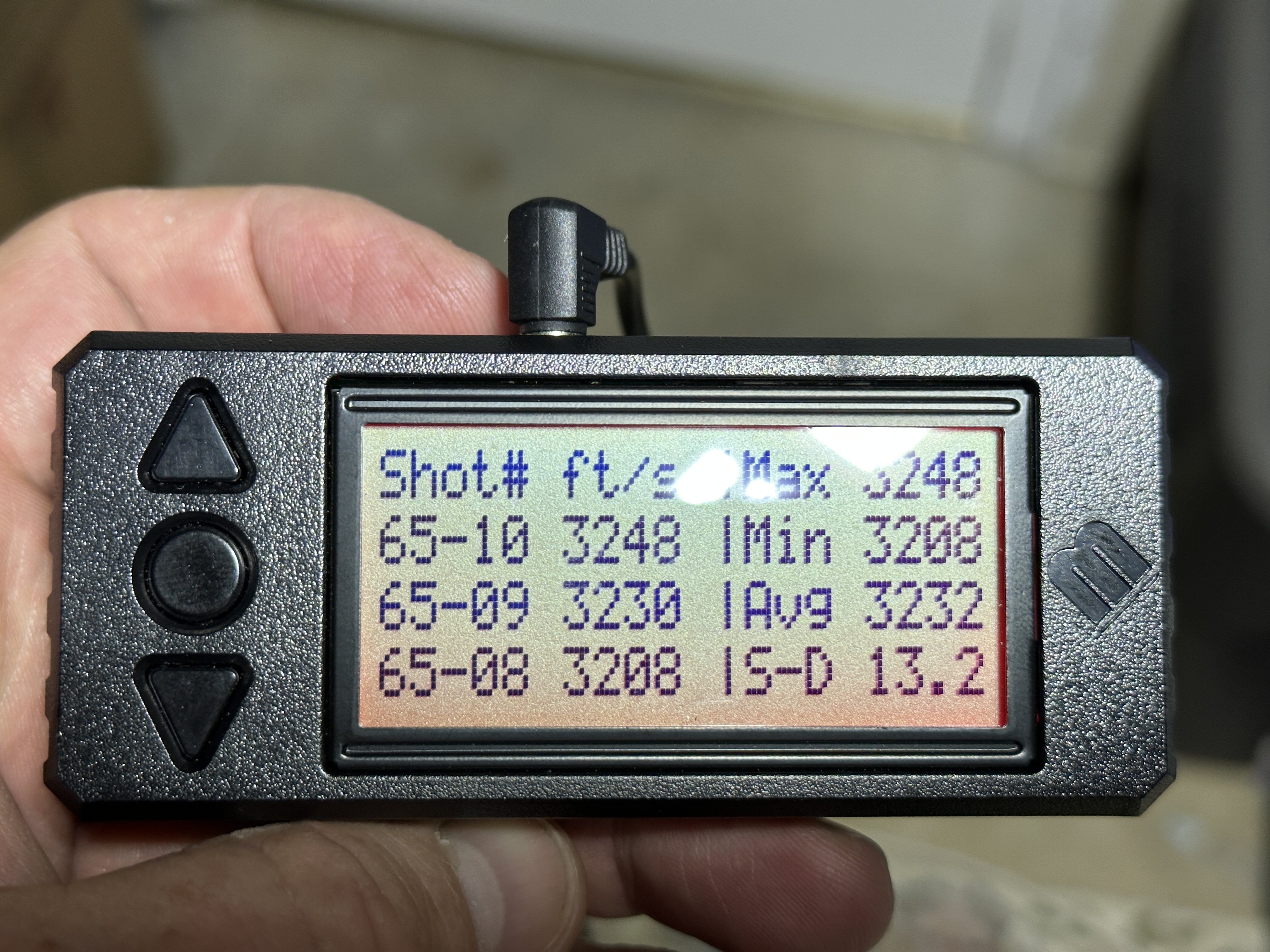

Yeah, I had that happen with a 65 CM PVA CF barrel that I was shooting at Frank Galli’s course and during the first 70 rounds of the course something changed with respect to the barrel and that was that it sped up nearly 100 ft./s
Got a little more accurate, but generally, it sped up.
Reactions: Baron23 and JAS-SH
Not unusual at all. My new 6 GT went from the mid 2700s to 2900 and change in the first 150 rounds. That's from the original barrel erosion. All with factory ammo (same lot#). When I get a new rifle I shoot factory ammo exclusively for testing. I buy a 200 round case so I can use the same Lot#. These days factory ammo (same lot#) is quite accurate.

The chambering looks fine. Nothing I would worry about. Not saying you (OP), but people love to get their bore scopes out and nit pick every microscopic imperfection in the bore and chamber and blame shitty shooting on these things. 9 times out of 10 it's the shooter or ammo. I build rifles for a living and had the fortune of seeing some pretty grotesque chambers and rifling on rifles that come into my shop that still stacked bullets.

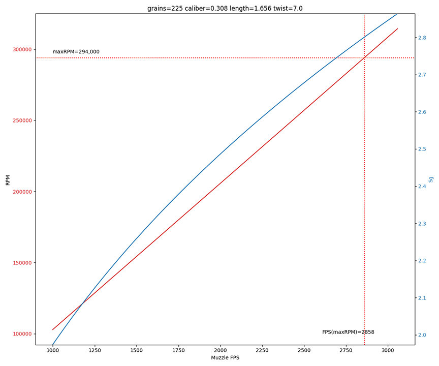

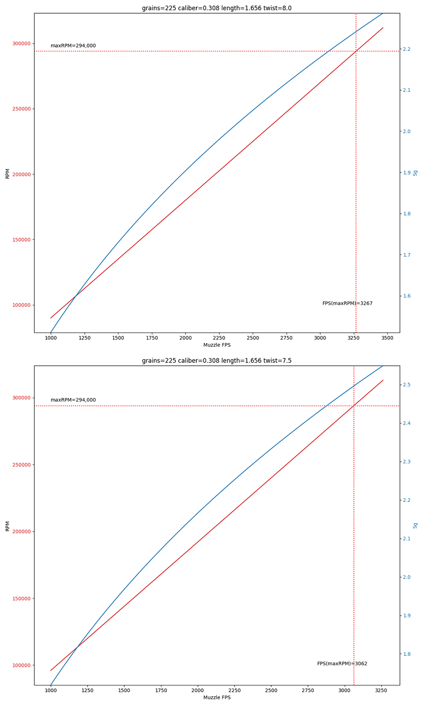

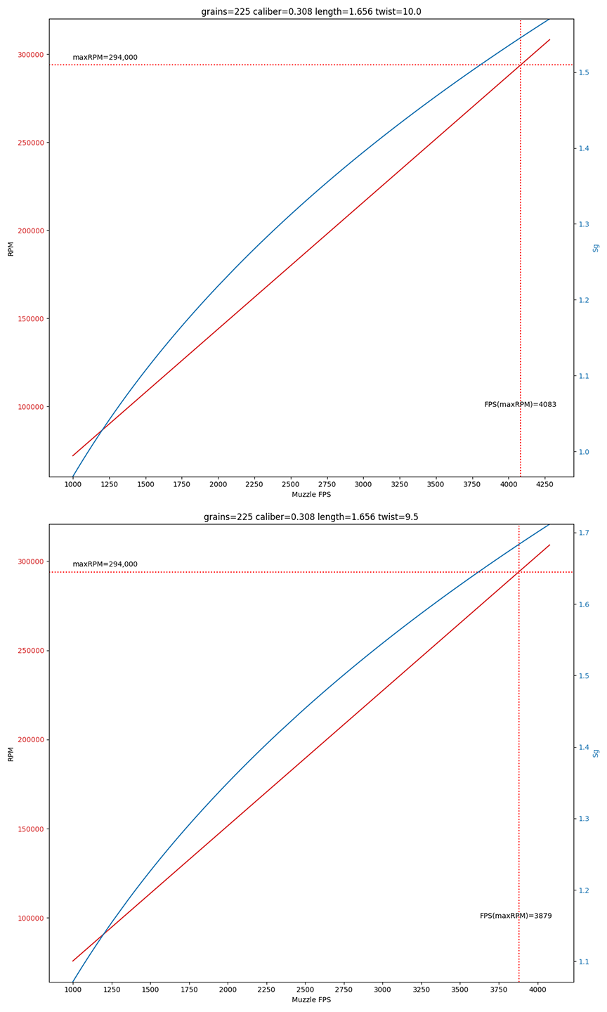

Just some math pics for the 225 308 ELDM. Based on the simple Miller math, and all of these sea level 29.92hg pressure.
I don't think Sg near 2.15 in twist 8 is any issue, but I don't know if the Hornady ELDM may be the issue. I still stand by my previous statements, and the 9 twist appears to be in the sweet spot.
Since it's an 8 bbl, load up some rounds for 2000fps and see if anything changes.
Do some laser spotting tests with the gear temp changing.
