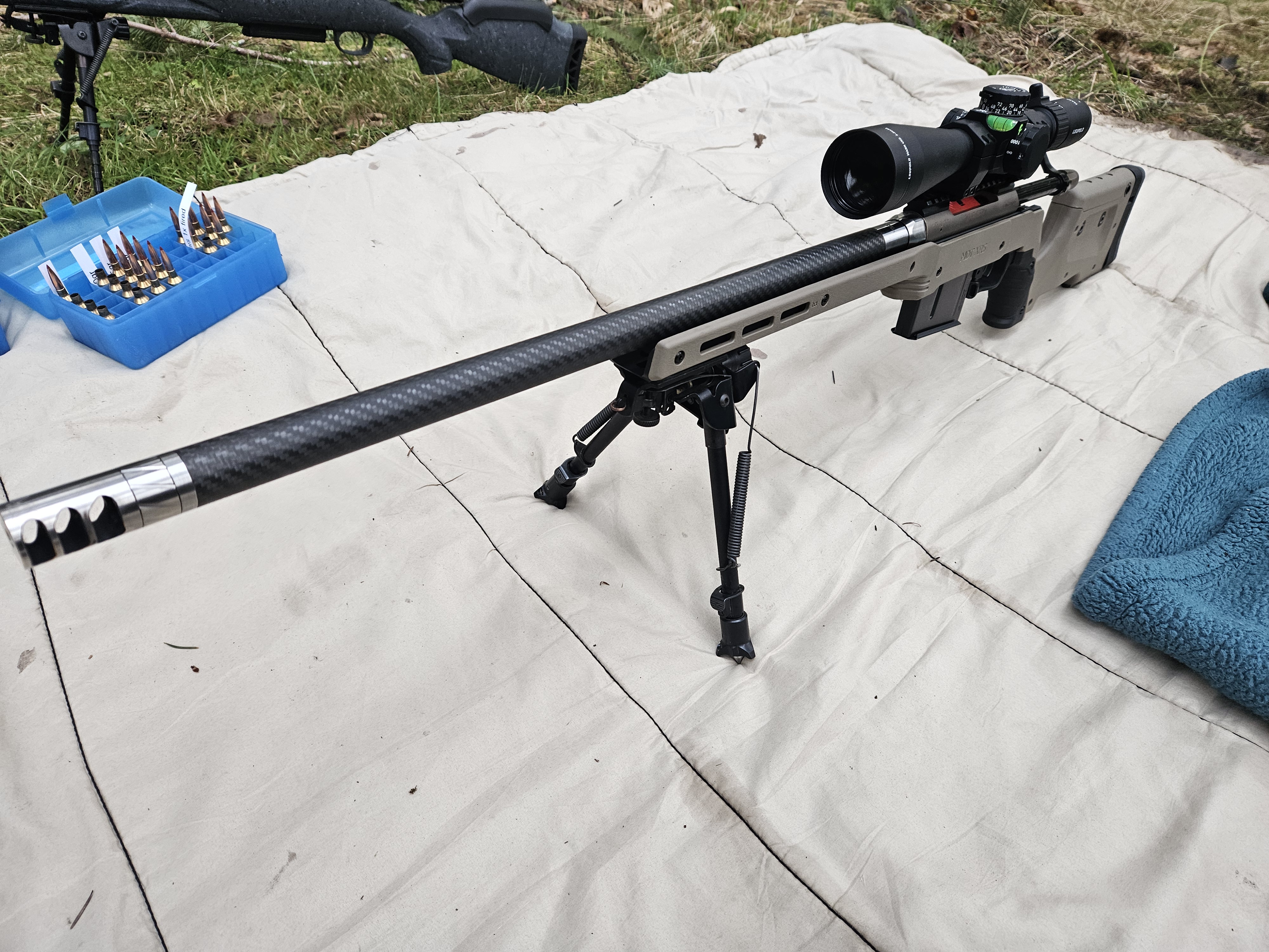

Match grade barrel fouling after 40rds?

Yeah im only getting 40 rounds through it before groups open up, even after letting it cool for hours/days. When your groups do open up, do you experience a major velocity increase with pressure signs?
No it’s not heat expansion unless it is just opening the chamber. Just a dumb guess, carbon is building up in the neck portion of the chamber, this changes your headspace which results in over pressure indications. I am a novice at reloading so if you measure your loaded cartridge and post the neck diameter, neck length, shoulder setback and overall length, maybe smarter people can say if it looks right. If it is the you have a barrel issue, if not these fine people can help correct the load.

Once i rule out a carbon ring tomorrow, which I am hoping the new products i ordered will take care of, ill pick up a couple boxes of factory ammo. Once its hitting pressure again, ill switch to factory ammo and see if the velocity is climbing with that as well.

What are the chances you are just charged too heavy and it works for the first couple dozen until the rifle gets fouled and then starts being more obvious? There are some REALLY esoteric (and thus incredibly unlikely) suggestions in this thread but the most obvious to me is that you are (despite what “book max” might be) over pressure. If your “pressure signs” are heavy bolt lift, you could probably back off by a couple of grains or more. Heavy bolt lift is way down the overpressure road.

That could definitely be whats going on, i have never experienced that with my other rifles i load for, so i never put much thought into it. Is it possible a barrel could take 40rds to foul/settle in?
On a clean bore, i ran up to 59.2gr before i got very faint ejector marks, no heavy bolt lift. At 58.3gr i have zero ejector marks until 40ish rds, then i get marks followed by slight heavy bolt lift.
I found a very stable velocity node between 58.0-58.5 so i was hoping i could stay there, but of course ill change it if i have to. When the gun hits pressure again ill switch to factory ammo for a while and keep an eye on the chrono

Is it me or is that an excessive amount of fouling on the necks? I'm betting it builds up at the neck and causes your pressure to increase.

I have not had any trouble chambering a round, regardless of how dirty the barrel is. With that said, i am using a weatherby/howa action, and while its not bad, its not the smoothest action either. So its possible i am not noticing a difference
It sounds like what you see with a really dirty or carbon ringed bore but after 40 rounds doesn’t make sense. I think there’s two different concepts at play. “Fouled in” is what happens as copper is laid down in the lands and takes 5-10 rounds. It’s the erratic data after cleaning followed by better data after a short bit. But “fouling” in the perjorative, is carbon “dirtiness” that can cause erratic results if the throat or bore is overly coated in hard carbon deposits. Your bore should be fouled in by 40 rounds but won’t be “fouled”. And in my opinion, your problem is not heat, carbon wrapping, trim length, chamber, or cleaning solution related. I wouldn’t go crazy with abrasive pastes or a borescope. A decent wipe-out with Hoppes or Boretech is all you need for cleaning.
If it was mine, I would back off the charge weight by a fair bit and shoot past/through the 40 rounds mark. You need a couple hundred rounds on it to see what the velocities will be, you need to stop confounding the data by cleaning it, and you need to find a powder and charge weight that will allow you to shoot your intended use without cleaning. If nearly 60 grains was where pressure started, back off 5 to 7%….to 55-57 grains at least and shoot 100 rounds. See where your velocities are and if the pressure indications come back after the first 40.

Thank you, i will give it a try. During load development i had good accuracy at 57gr (but creedmoor speeds) so ill start loading that up and see how long i can go without issues. I currently have about 12rds through it since the last cleaning, so ill start putting 20-30rds a day through it and post the results.
I built this rifle as an introduction to long range shooting (beyond the 650yards i currently shoot my factory rifles at) but i went with a carbon wrapped barrel for weight, so i could also use it as an Eastern Oregon hunting rifle where longer shots are more common. I am primarily a blacktail/roosevelt hunter, and have plenty of rifles for those hunt distances.

Well i got up and started shooting at sunrise this morning, starting with a round count of 12 on the clean barrel. I reduced my charge 1.3gr which in turn brought my velocity down ~80fps.
Unfortunately, my problem is getting worse. By round count 20 I started seeing a bump in velocity. By round 25, i was getting pressure signs. I found a box of factory eldx in my ammo bin, it only had 2 rounds in it but i decided to shoot them anyways just to see what happens. I hit pressure on both factory rounds.
My order of bore tech eliminator and iosso will be delivered today, ill work real hard to clean the barrel to remove a possible carbon ring and repeat this test using ONLY factory ammo one final time before i send the barrel back

It will be used very seldom for hunting, ill be using it in Eastern Oregon about once every 2 years for hunting, but the majority of my hunting is blacktails which i use my short barrel 6.5 creedmoor for, and 7prc for elk.
i plan on putting 1k+ rounds through it this year alone target shooting. Which is still fine, as I always bring my cleaning equip when im out shooting all day anyways. I was more concerned about there being an issue with the barrel that may get worse over time until its either not grouping or becoming dangerous. Its my first quality barrel so im not sure how they are supposed to behave.
So far i have 40 rounds of factory ammo through it after a cleaning and still no pressure/velocity increase. Im going to put another box through it today just to be certain, but this is starting to indicate a problem with my handloading

After putting 40 rounds of factory ammo through it, everything was still fine. Started firing the third box and around #55 the velocity started creeping up, i had pressure signs on the brass #58-60. Picked up one more box of factory ammo and just shot a few more, had pressure signs on all 3. Pulled a dry bore snake through the barrel and shot again while the barrel was still warm and the velocity dropped back to normal with no pressure signs. This confirms that there is carbon building up in the throat causing the pressure spikes, and my handloads just speed up that process.
Thank you everyone for your help, i've learned a lot about barrels and have adopted a better cleaning method using better products. I have decided i am just going to live with it, and when i am out shooting i will commit to pulling a bore snake through it every 10-15rds, with a thorough cleaning every 30-40rds. As others have mentioned, i will probly wear this barrel out in a year anyways.
I am still extremely happy with my purchase and the accuracy of this barrel. I own a lot of factory rifles in all different calibers, and i get excited when i can group 5 shots sub moa (doesnt happen all that often). Using the handload that this barrel likes, the other day i was able to shoot 5-shot groups of .47, .34, .49moa prone/bipod/squeeze bag. Couldnt be happier about that!
I am glad you have got it figured out. There something about that hand load recipe that speeds it up. With a good cleaning pattern you seem to be good to go. Enjoy
Thank you! Ive spent so much time (and money) figuring this out that i no longer have the desire to figure out why the handloads speed that up. Im just going to shoot the damn thing!
Brother, I think I'd rather have a root canal than have to pull a bore snake thru my rifle ever 10-15 rounds.
When you get a bore scope (you didn't cancel doing this, did you?) examine that throat area very carefully. I just can't imagine how rough a throat (free bore and leade) would have to be to pick up so much carbon in such a short period of time. Its have to be a rough as a cobble stone street.
And your experience with factory ammo...you can't get thru 3 boxes of ammo without it speeding up and having pressure signs.
Hey, if you want to live with it...no skin off of my back....but its not right. There are lots of folks here shooting 200 rounds on their rifle before cleaning (think multi-day clinic or a two day PRS comp) and don't have pressure signs just pop up.
Look for a carbon ring....look at the FB and leade....what you are describing just isn't right, IMO.
Reactions: carbonbased
Brother, I think I'd rather have a root canal than have to pull a bore snake thru my rifle ever 1-15 rounds.
Yeah i totally get what your saying, i just got burnt out on diagnosing it and really want to get back to shooting. Waiting for all my parts to come in to build this gun felt like a kid on Christmas eve. The thought of removing the barrel, sending it in and waiting, reinstalling and starting load development all over again sounds miserable especially since its starting to become shooting weather.
I didnt cancel the borescope, i ordered the Teslong everyone talks about and its getting delivered tomorrow. Ill get some pics with it tomorrow evening and see what you guys think
