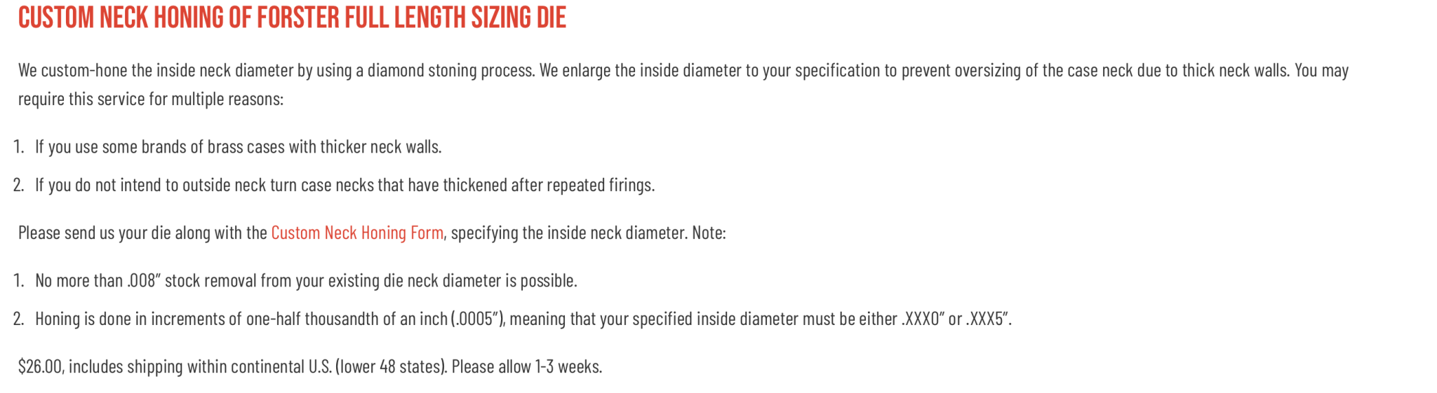

Maybe just turn a ~$100 FL die into a ~$126 custom die by ordering a custom-honed FL die from Forster, beyond that, you're wasting your time and money.
