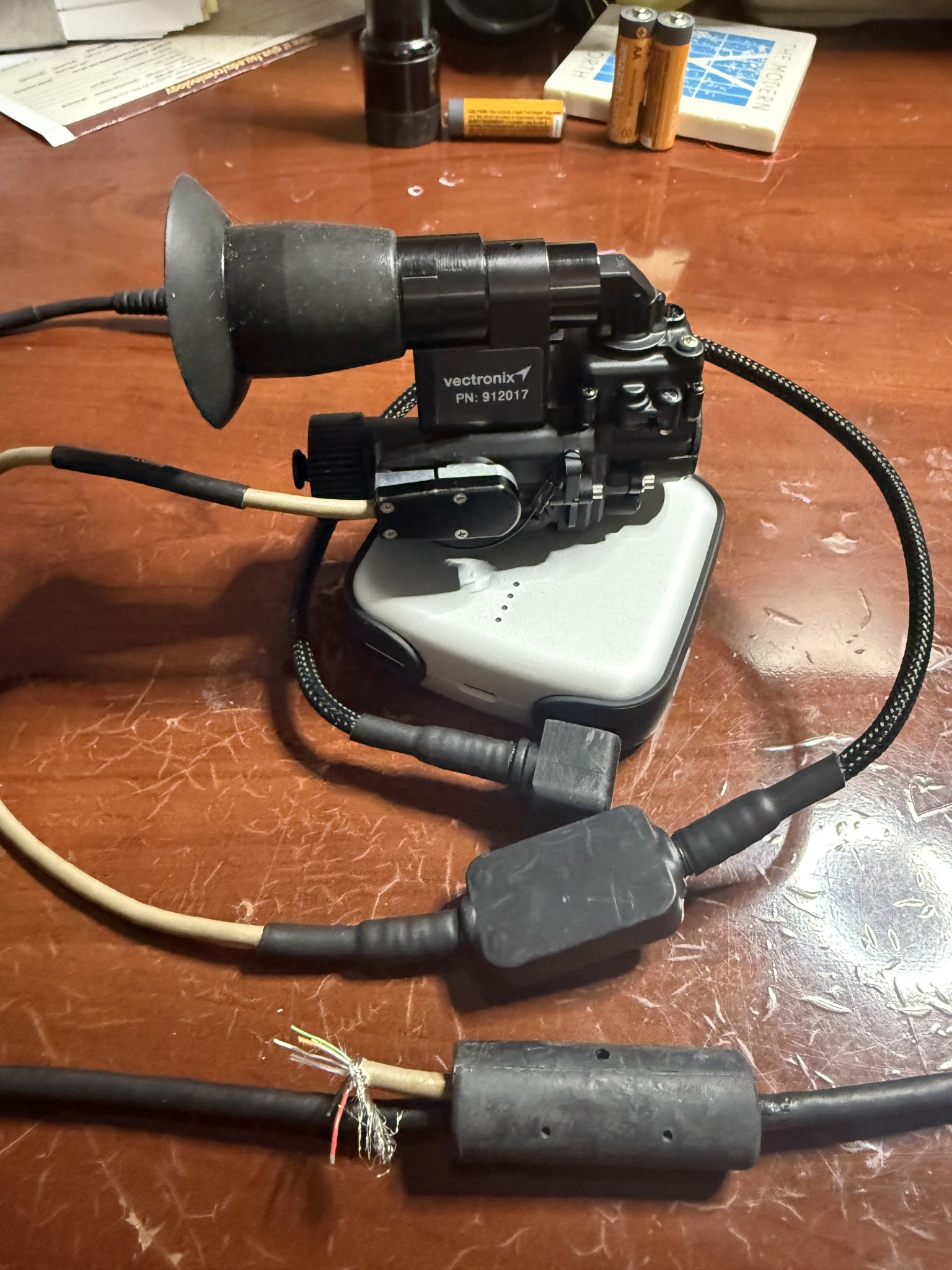

Here is @CoryT Vortex Impact 4000 power cord. Works like a Champ!!! If you are night hunting this baby is a Must.

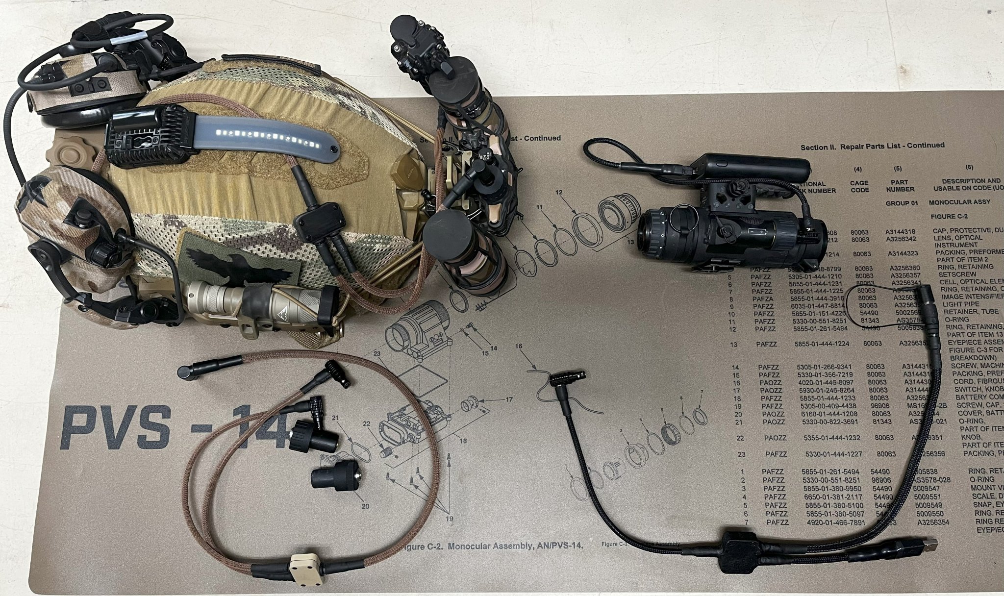

Fischer split cable for DTNVS/E-COTI on a Nocturn Bat Pack, also available as a Lemo connector version. Split cable to power a EoTech Clip-IR/ Vortex 4000 LRF from USB. Lemo cable and battery adapter for the IR Patrol series. All plugs can be 90 degree or straight, voltage regulated if required for use with a USB pack . All Lemo, Fischer and DC type plugs are supported, as well as USB connections. Battery adapters and caps are 3D printed in engineering tough resins or Nylon.

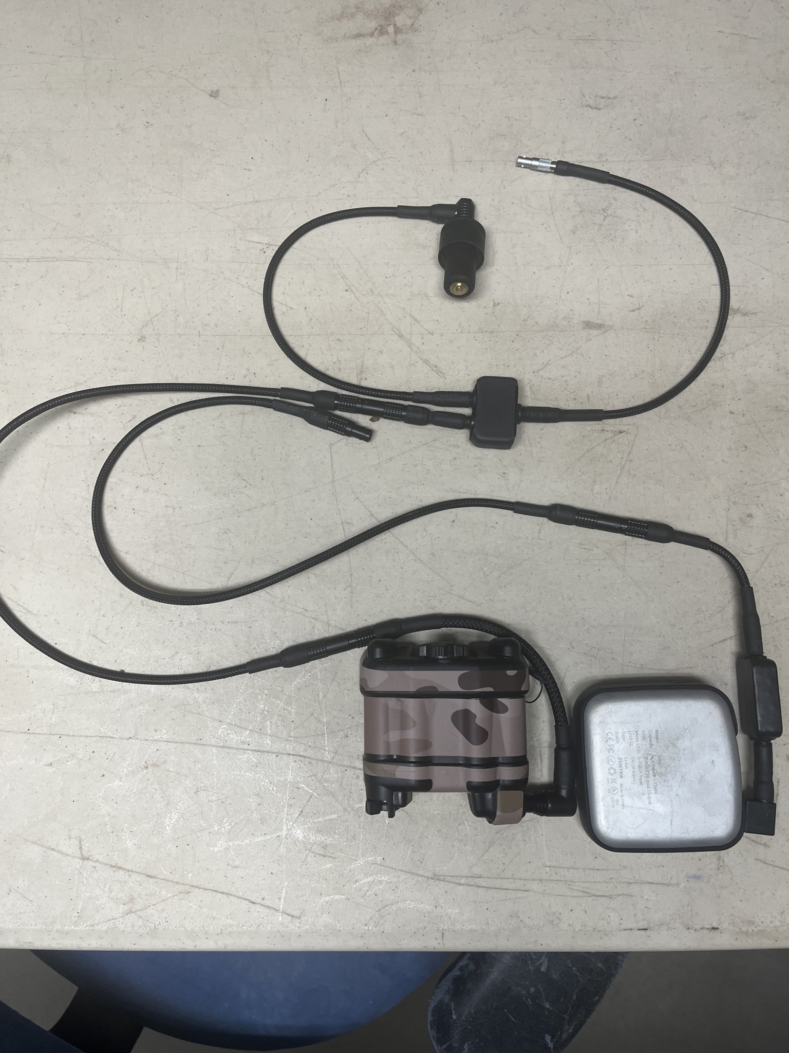

Second dual cable system testing before delivery. Using FlexSeal on the splitter and regulator box, seems to be an improvement on adhesive heat shrink. No really good way to apply that on the splitter assembly.

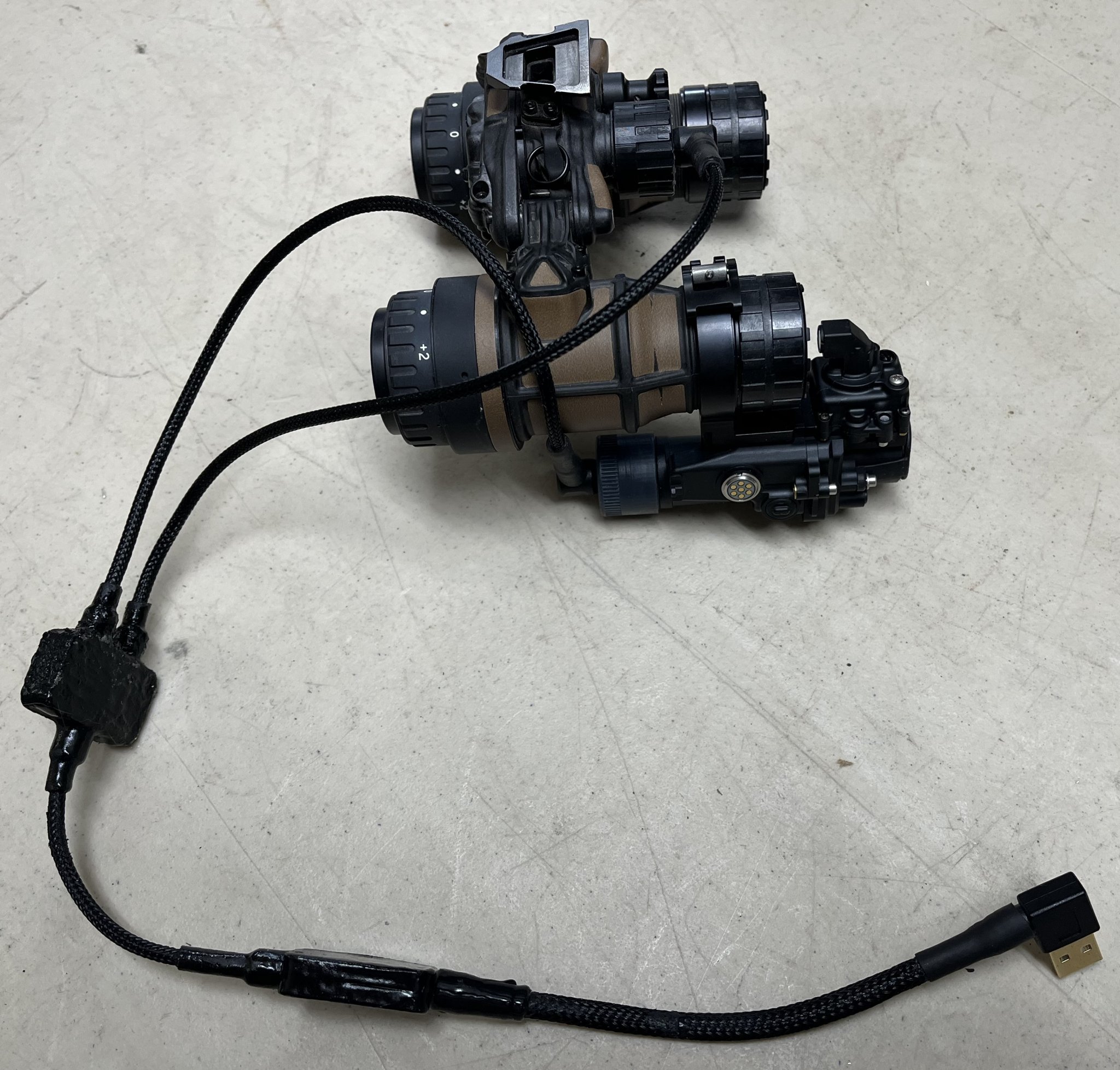

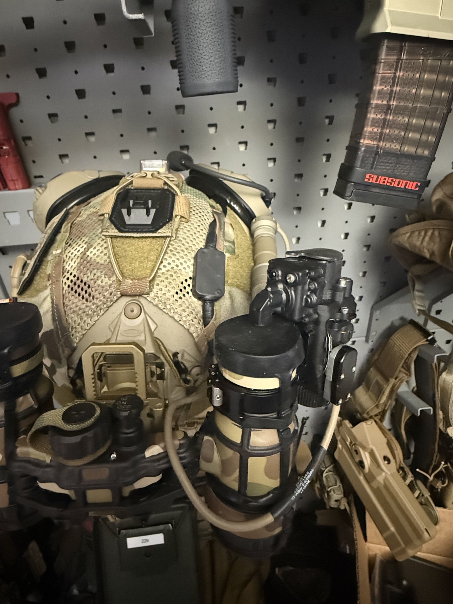

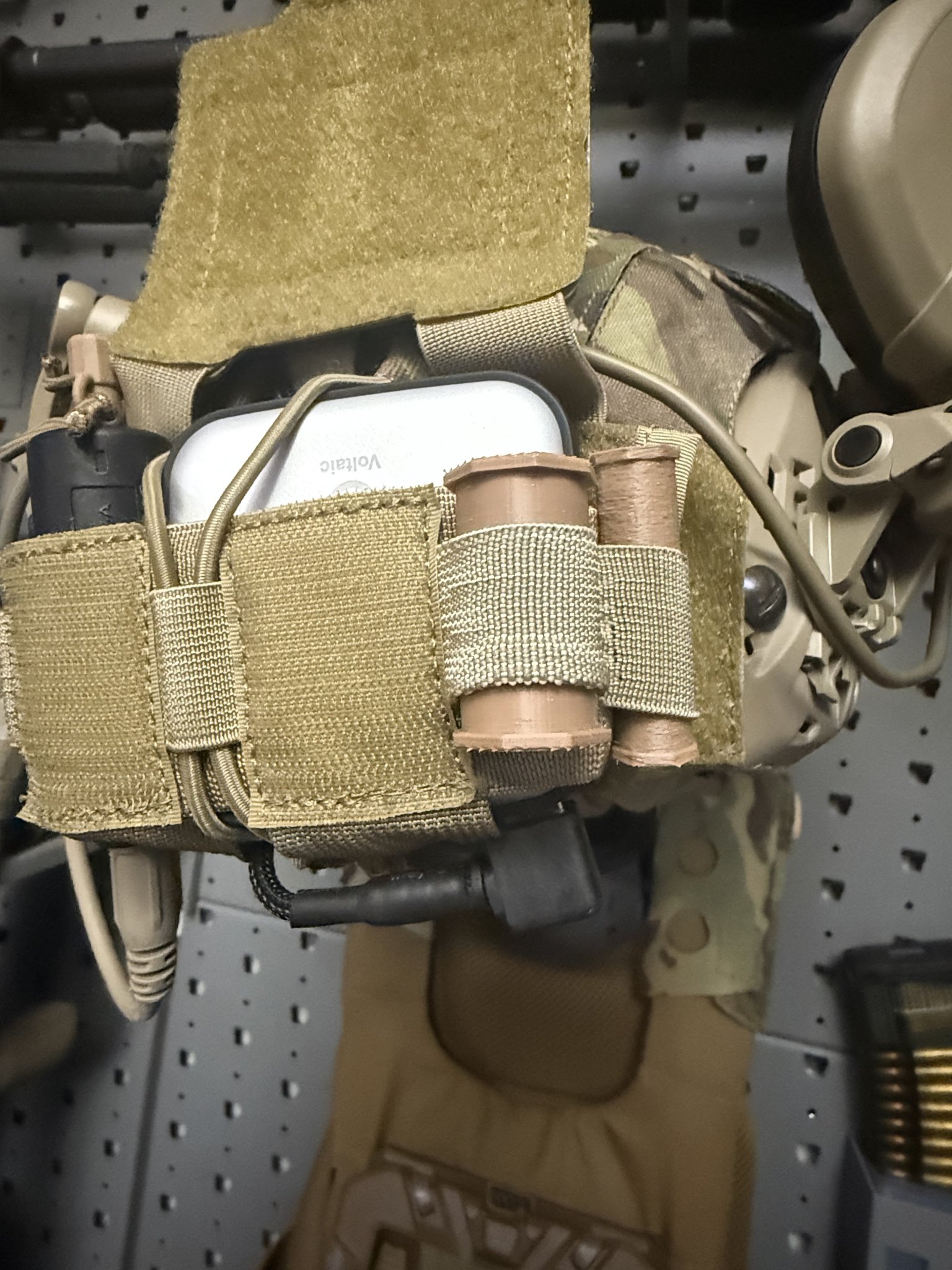

My man hit it out of the park on my new USB cable. OEM ECOTI connector to USB using OEM donor connector from PVS31D splitter. And he set it up to put out the right voltage to the pin outs to keep the battery level from bitching at me! Cable is exactly how I envisioned it. 10 out of 10!
Super fast turnaround especially considering I had to source and ship another PVS31D cable/pack to get the pin outs and voltage. Great work Cory, thanks! Looking forward to getting out and using it. Still messing around with wire routing, but man am I pleased with it.
