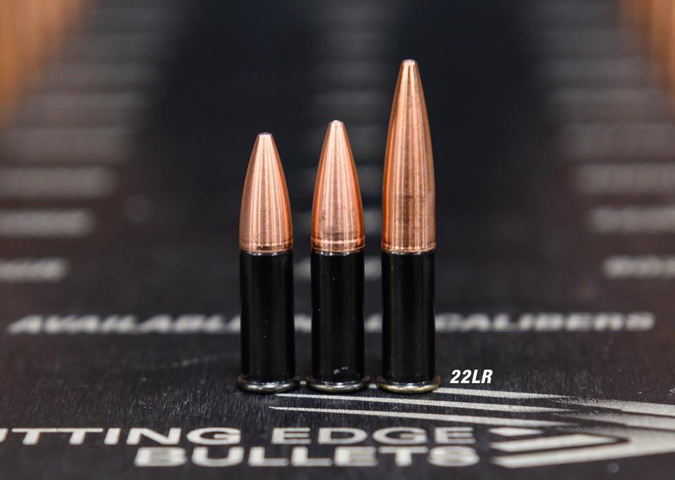

The CE bullet that they are allowing preorders for now is their 32gr. It’s designed to fit in a standard 22lr mag. .111g1 but they say it should run at or above 1400fps. They suggest using 3n37 powder I think.
This bullet isn’t in the same league as mine. They are supposed to be coming out with a larger bullet sometime in the future though.

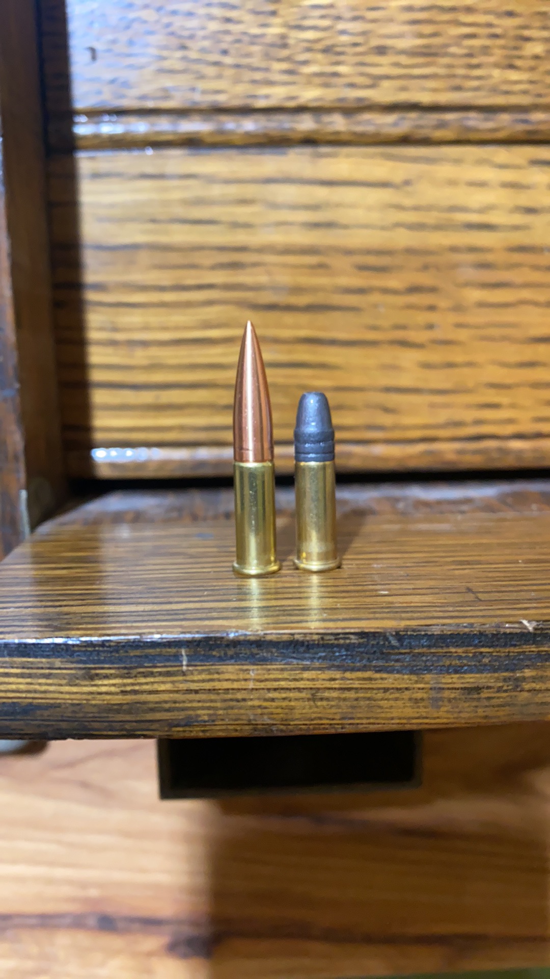

This is my bullet. I currently can run it at 1250ish and brass holds up. I’m going to change barrel parameters and gain a little weight/bc and speed.
Mine will run out of a 17hmr/22wmr mag and had a .250g1 It’s not quite double what a standard 22lr is but getting up there.
The 9 will only stabilize their 42gr. They have a heavier one that’s supposed to come out that will need a 1-6
The press release is for the 32gr. So yes, not the ELR projectile that people are looking forward to.
But if people purchase this current offering it’ll work in 1:16 twist.

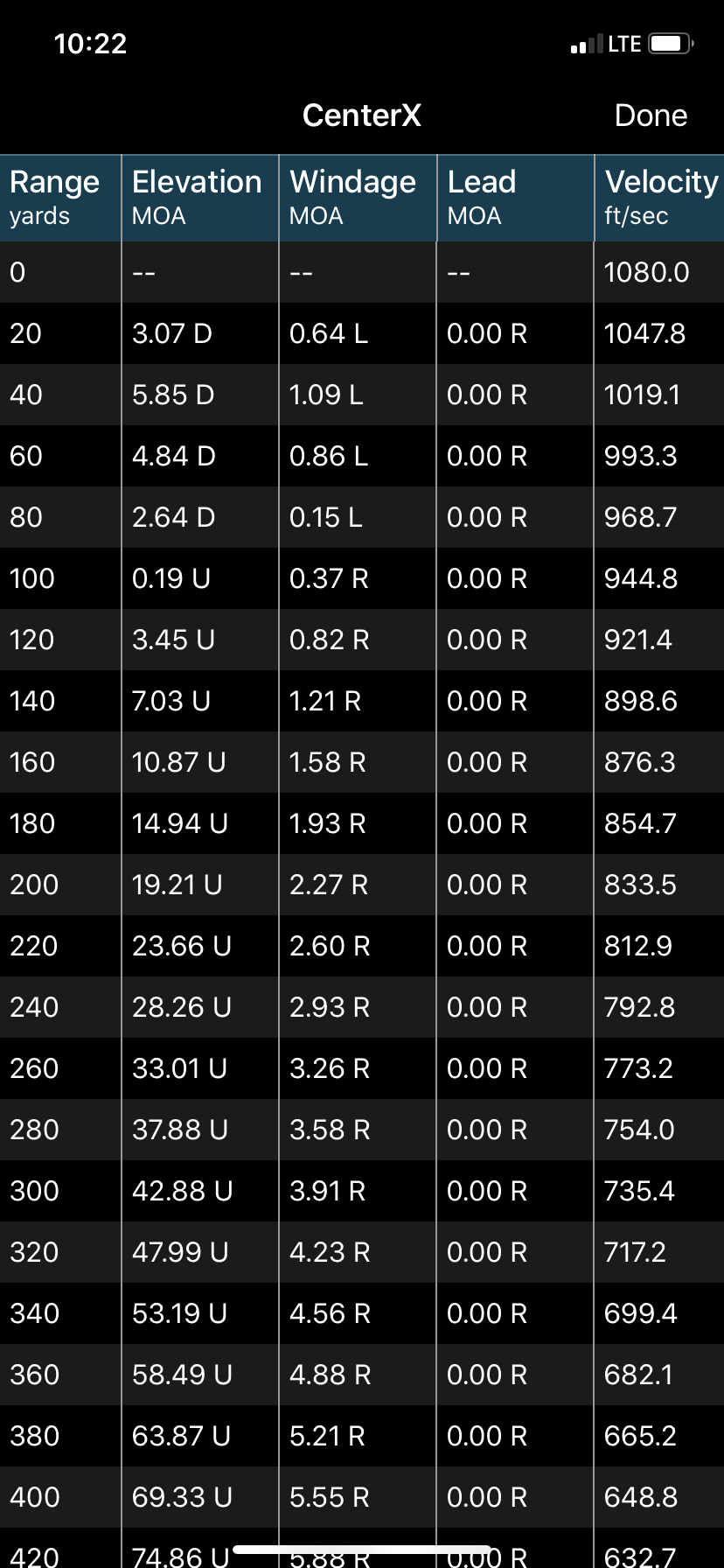

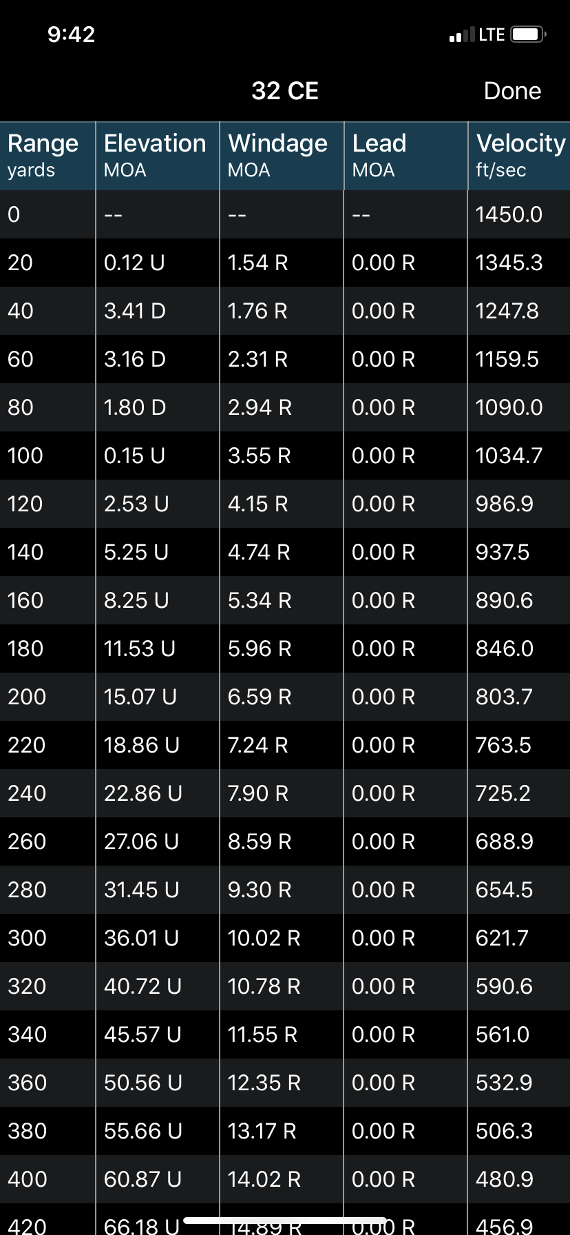

And was curious if there was any real advantage inside of PRS range. I’ll be pre-ordering these to check out and have a rifle built around yours or others for ELR.
5mph wind from the 3 o’clock
CenterX at 1080View attachment 7517779Cutting Edge 32gr at 1450View attachment 7517777
If you were to send the CF bullet out at 1050 it would have less wind drift out to 3-350. Wind drift and constancy is what matters.
