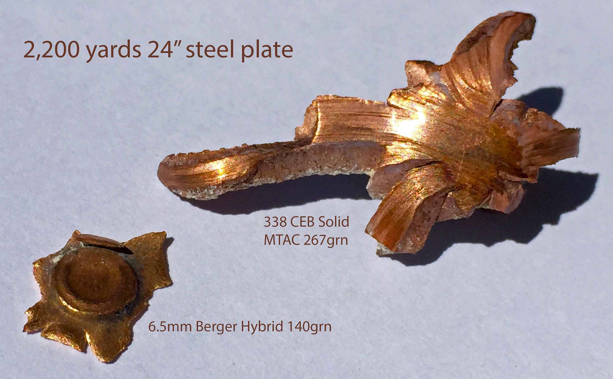

We're are all familiar that on heavy plates at longer ranges that 6mm 105gr bullets can sometimes be a bit harder to spot.. than lets say a 6.5mm 140grain. But solids are WAY HARDER to spot as they do NOT create anywhere near the same frag signature or watermarks as their lead core counterparts. They all share one common issue, caliber to caliber. They have less mass and do NOT frag anywhere close to the same caliber your are shooting.. My 6.5 might frag like a standard 223 on a plate at 500m.
Here are some real examples of frag.. Note that we could see the frag signature in our scopes on both the 285gr and 168gr lead cores, but not the solids even though it was 200y closer.
Here is an example of a 338 285gr lead core 2240. Look at the miss, but really the frag signature coming off the bottom of the plate.
Here is an example at 2200; 200 yards closer than the above sample with a 338 267gr SOLID.. look at how much smaller the watermark is, but really how little and fast the TINY frag clouds is and disappears.
Now back to a 7mm only 168gr 2400y. 200y further than the SOLID example above.. look how much more frag. signature a smaller standard projectile shows than the zippy Solid 338
I've shot more solids that I want, as I live in an area were it is law for hunting.. I also went down the path BC and speed chasing for both long range and ELR. Between those three, I have time on 6/6.5/308/270/7/300/338s. They all share one common issue, caliber to caliber. They have less mass and do NOT frag anywhere close to the same caliber your are shooting.. Solids might be ok .30 cal and up, but a 6.5/6 is really low mass and your really giving up things in Assumption B.
Soooo - if your looking for increase long range performance on steel.. Maybe think of another caliber first.. then when need more but the next caliber's recoil starts to threaten stuff in assumption A, move to solids.

As distances increase, misses, plate movements and impact frag are diminished and harder to see. Mass is your friend when spotting the moment of impact. A 300gr 338 is way easier get feedback from than a 55gr 223, I don't think there would be any argument.

Back to the frag thing. I found an image I put together from one of our plates when I was having this same conversation about what is happening with solids that is causing such a low frag signature off steel.
Note: The 6.5 had a ton of misses at the distance show but did empty the lead when it hit the plate. The 338 having over 2x the weight didn't leave a frag signature any better that the 6.5, but did swing the plate. We were using target camera to review and spot the 6.5s.
Note: In the MUCH smaller sampling of animals I am NOT finding solids that look like they do when the hit a plate. The solids seem more intact when they hit steel far off (lower velocity) and close just fractured (hard to find).
I hope some of this is helpful as you guys on small calibers decide if solids are for you.. just trying to share what I have found by spending WAY to much time and money..
