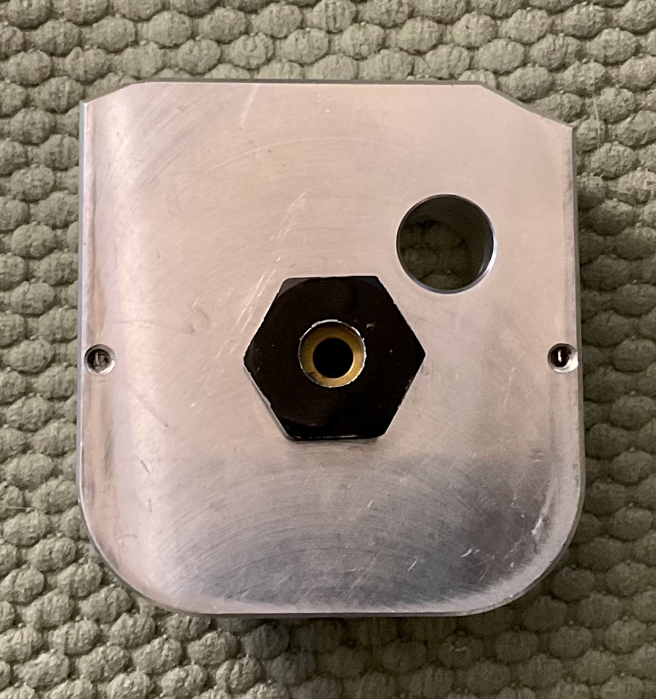

    I appreciate your reply, could you tell me a little more about the neck bushing? I understand the concept as I use bushing dies for all my centerfire loading. How are you doing it for the .22 case?
    I took a Redding bushing and set it up in a tool head so that I could “neck size” the .22 case. I only size the top of the case, roughly the same length as as the part of the bullet that gets seated. I used a drill press and some aluminum automotive plugs that had the same threads as the tool head to hold the bushing. I’m sure there are better ways to do it, but it was simple and cheap. I found the .223 bushing worked best with the CCI cases that come with the CE bullets. Also tried some Eley cases, and those needed a .222 bushing as the brass was a little thinner.
    That is awesome! I'm not sure why cutting edge didn't make a bushing die set for them. Seems like it would have been much more repeatable.
