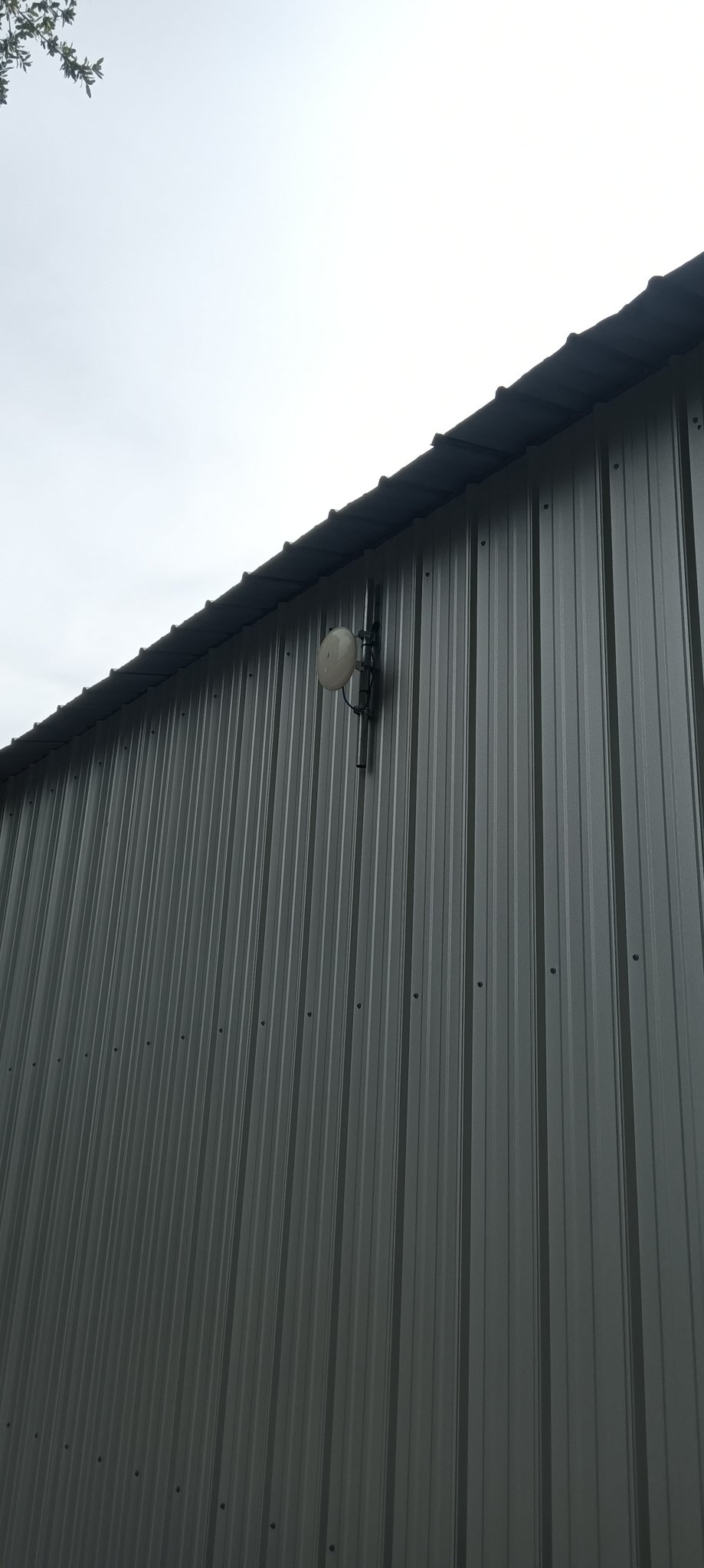

I have this unit tying 2 buildings together. The first at the front building where the Internet service is. The second is on my shop.
Works flawlessly, really does. I've had it for a couple years and haven't had any problems. I get great TV from it also.
Building to building is 200yards.

Look into cell phone companies for internet. I use Tmobile home and have a TV antenna on the roof for local channels. With all the streaming services that are cheap/free it doesn't make sense to pay for satellite anymore.
