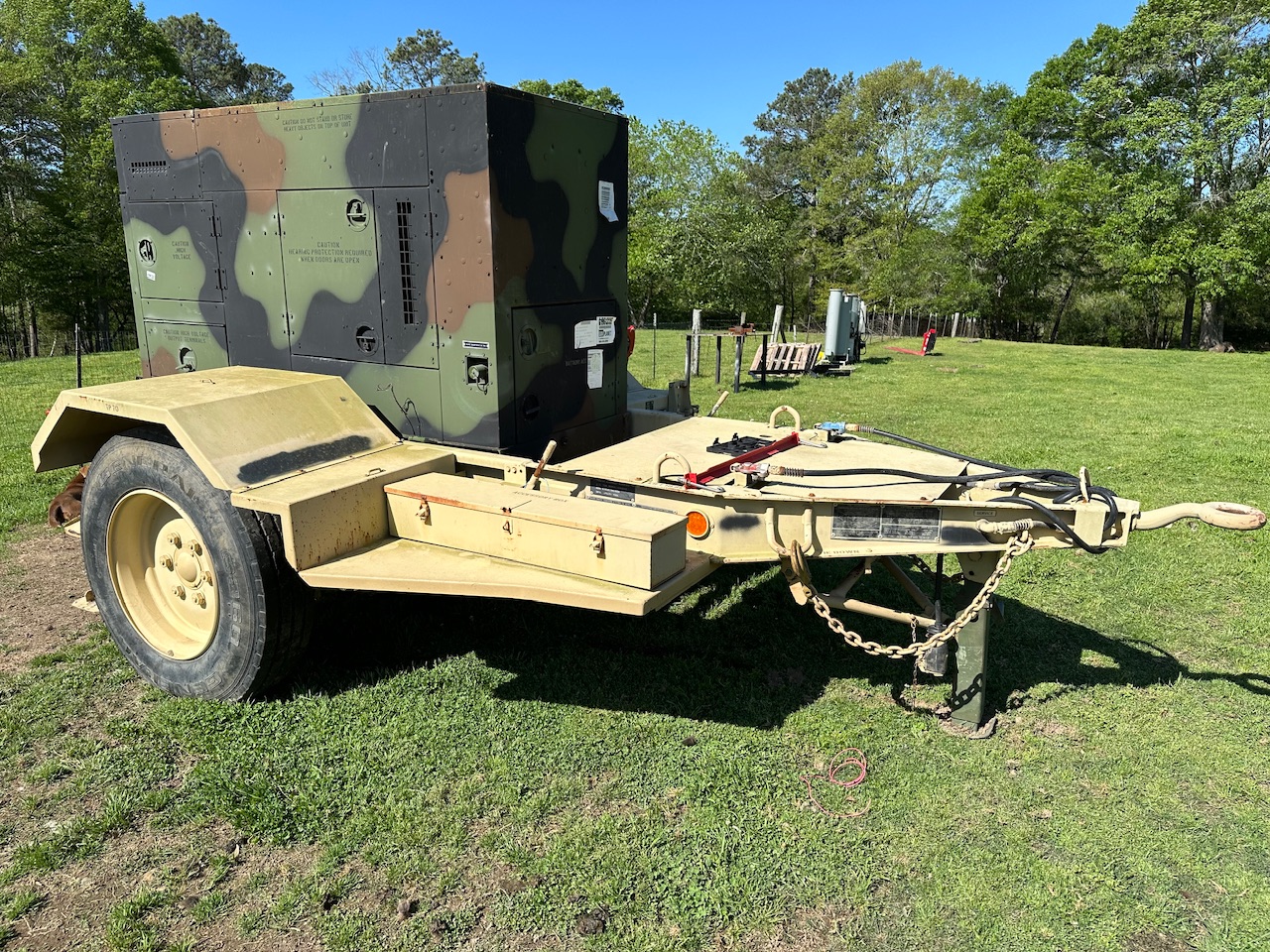

Also got one of these. A 30kW mobile diesel from a GOV auction with only 8 hours on it. Looks brand new! John Deere 4-cyl diesel.

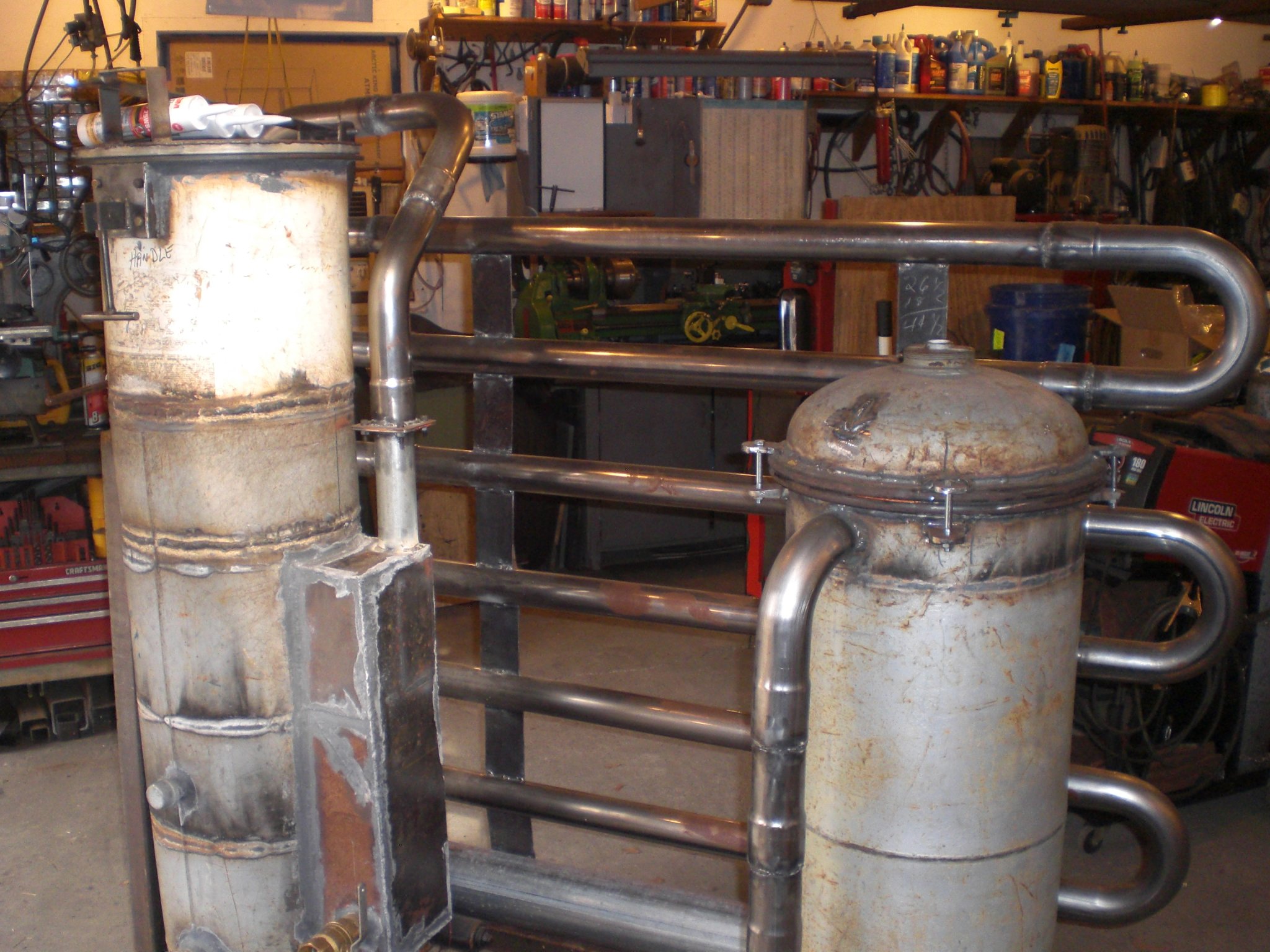

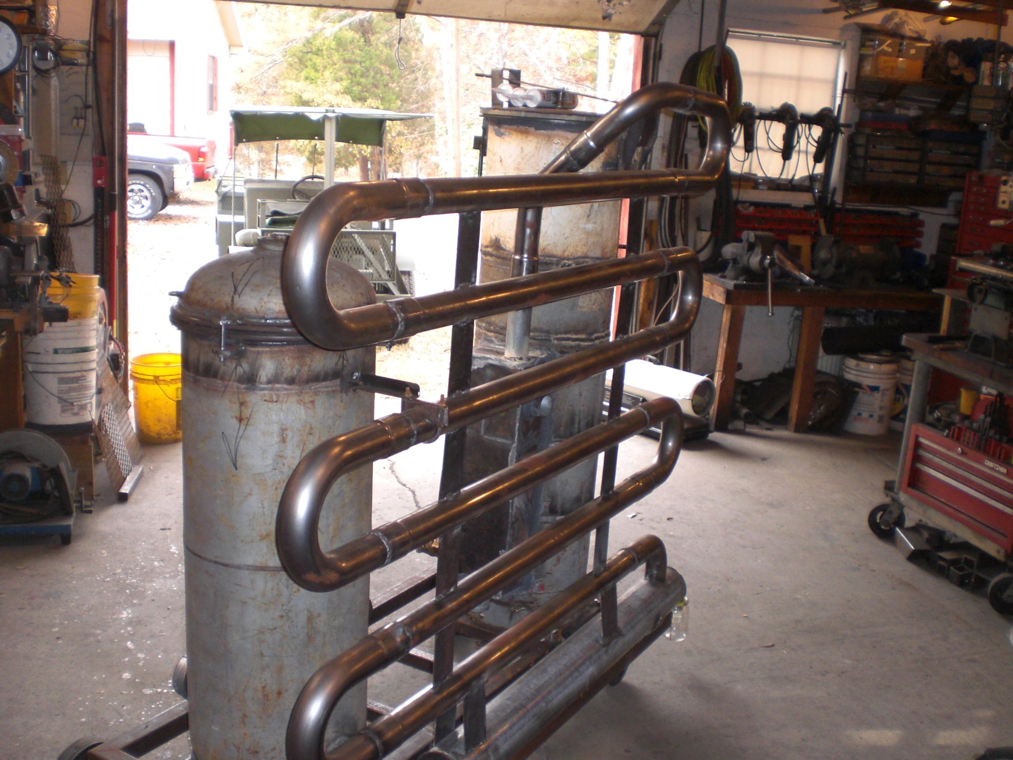

Wood gas for the spark ignited. Mineral oil from utility transformers mixed 50/50 with diesel will extend that fuel supply. In a pinch you can run a diesel engine on a mix of gasoline & filtered new/used engine oil, or automatic transmission fluid. Do Not use hyd oil!
A good prime mover in a SHTF is an old Multi fuel engine, any liquid that will burn will keep her turning. Your best bet across the board is steam, plus the boiler will also run on the body fat of liberals.
