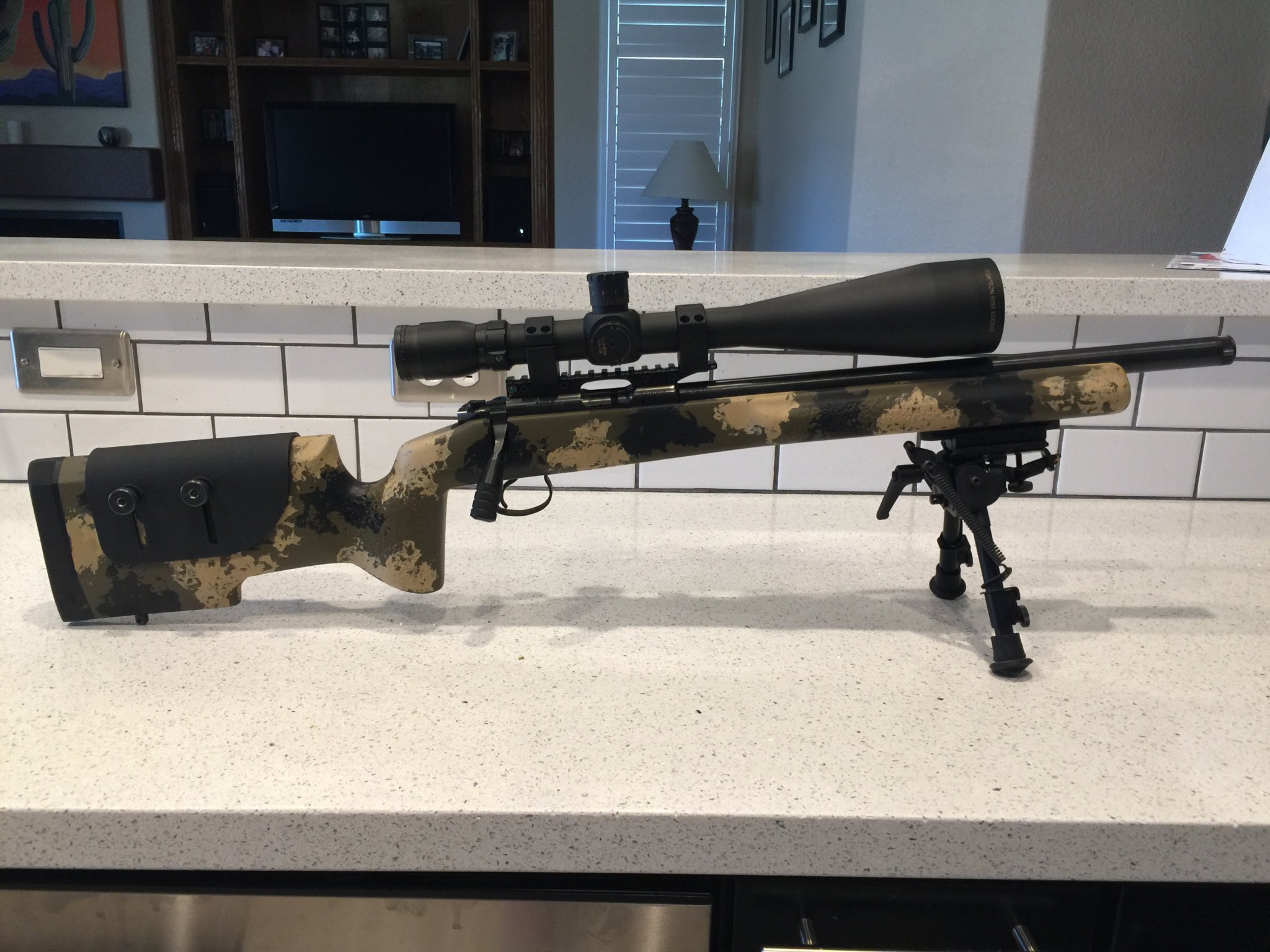

I bought the Tacticool and then got a Manners from eBay which was bedded and pillared and I immediately noticed a difference in accuracy. I love the Manners stock it is sturdy and a bit heavier but I only shoot from a bench or prone.
I have a Area 419 15MOA rail which helps with clearing the objective.
Vortex PMR Medium 30mm rings
Sightron SIII 10-50x60 LRMOA
Aftemarket bolt handle
It is so much fun to shoot I would highly recommend the VPT ??

Looks good(y)
What height rings are those? Mine are way too high..
