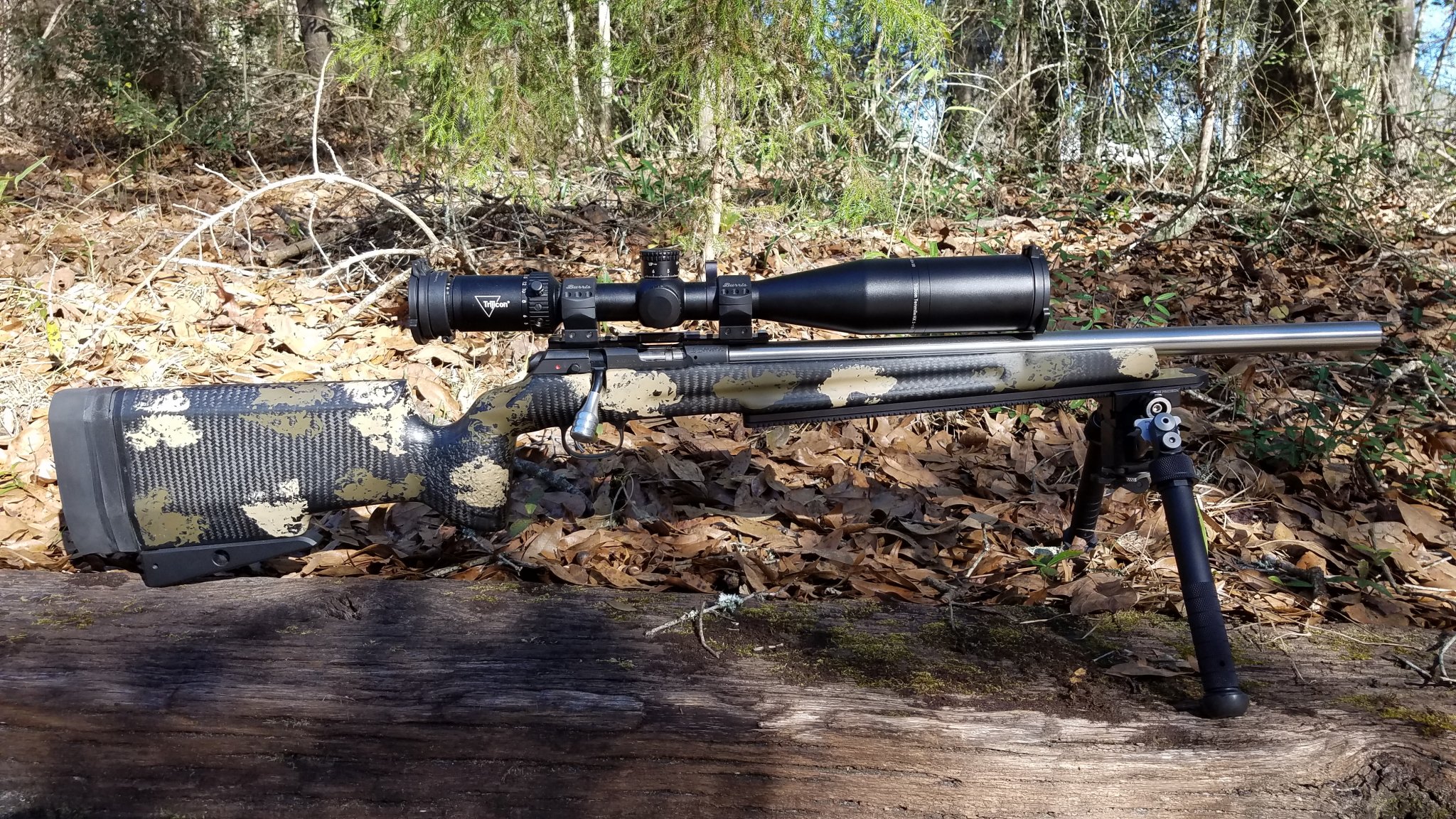

I'm having very good results with CZ 457 Lilja drop-in .900'x21' straight cylinder barrels. Been using them to shoot in our local ARA Unlimited matches. Out of 4 barrels....this is probably the worst one.
