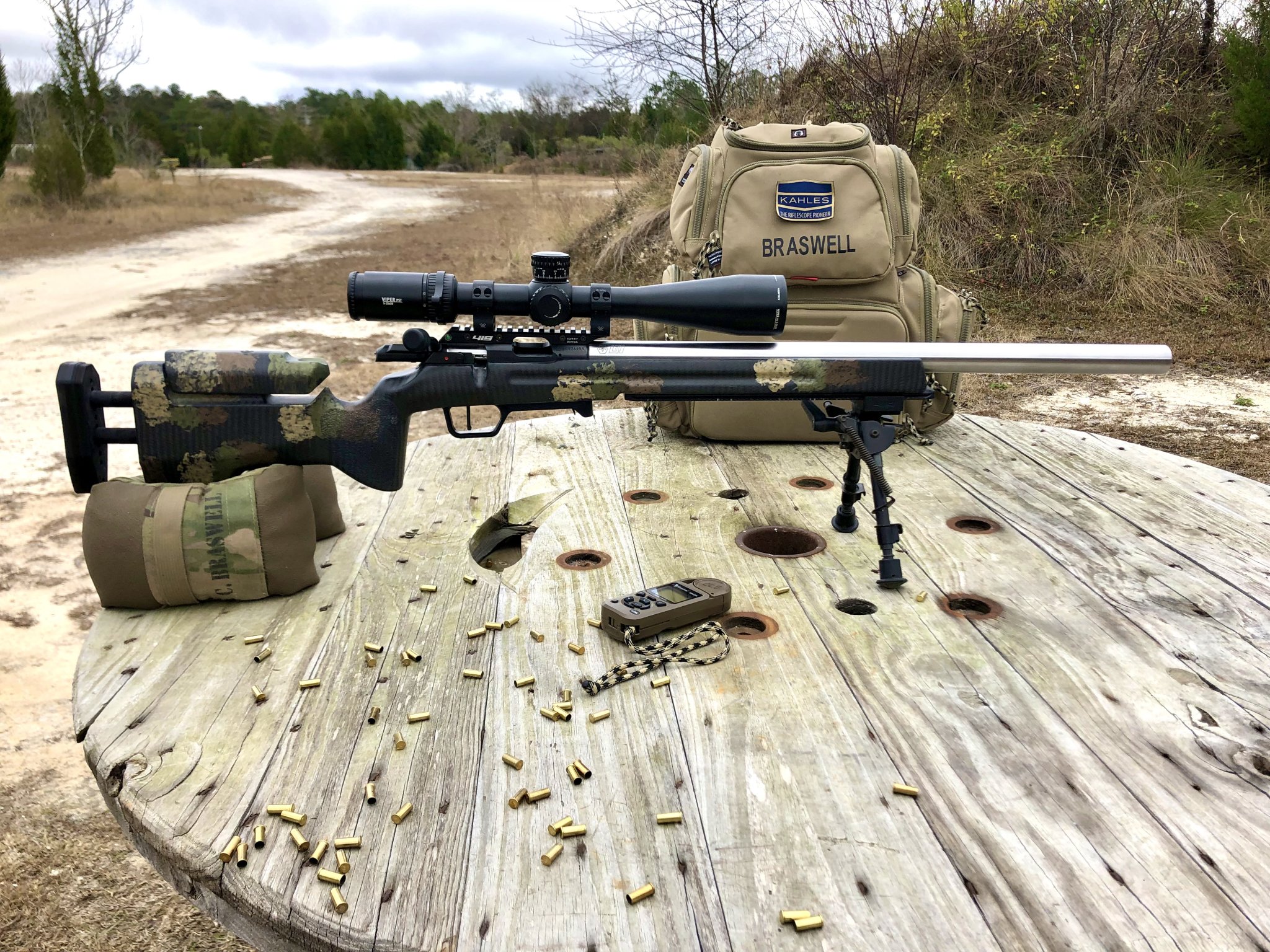

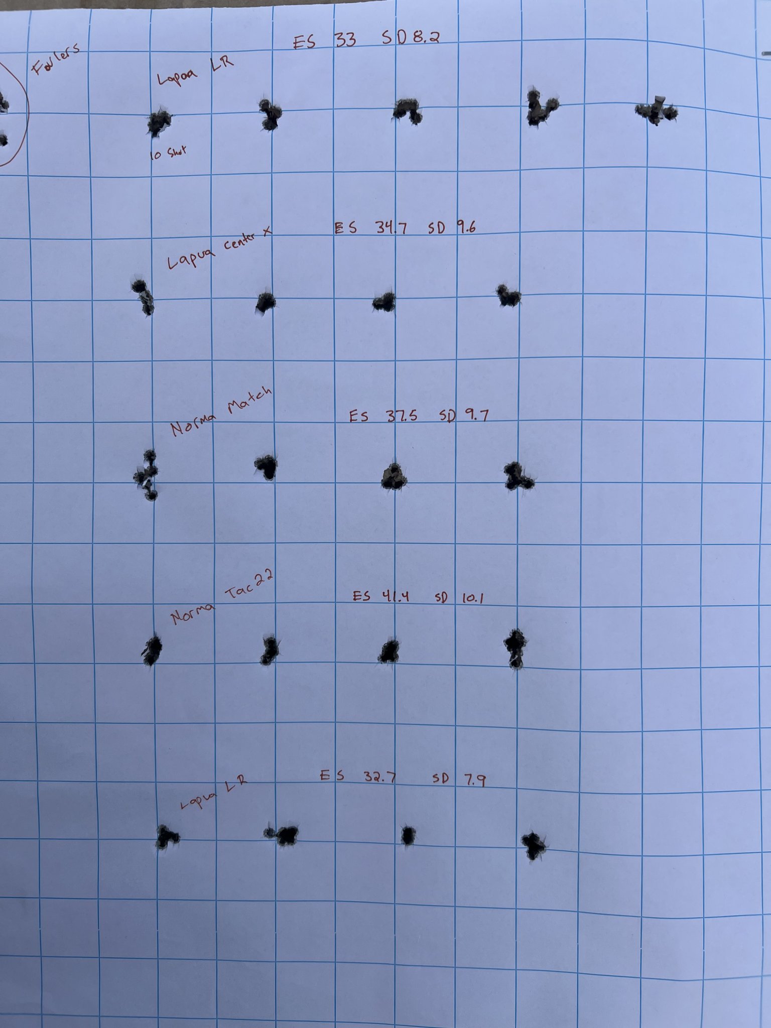

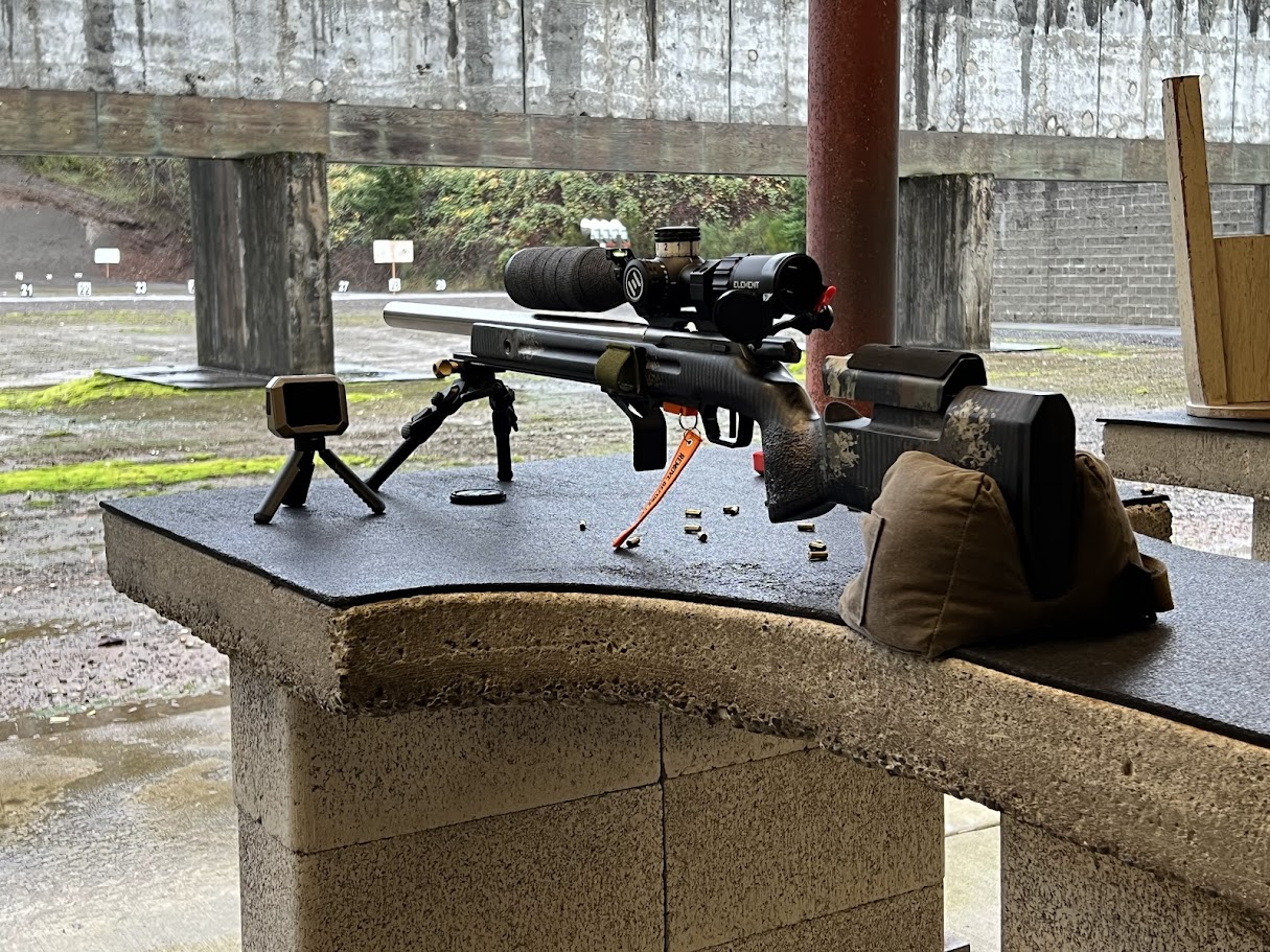

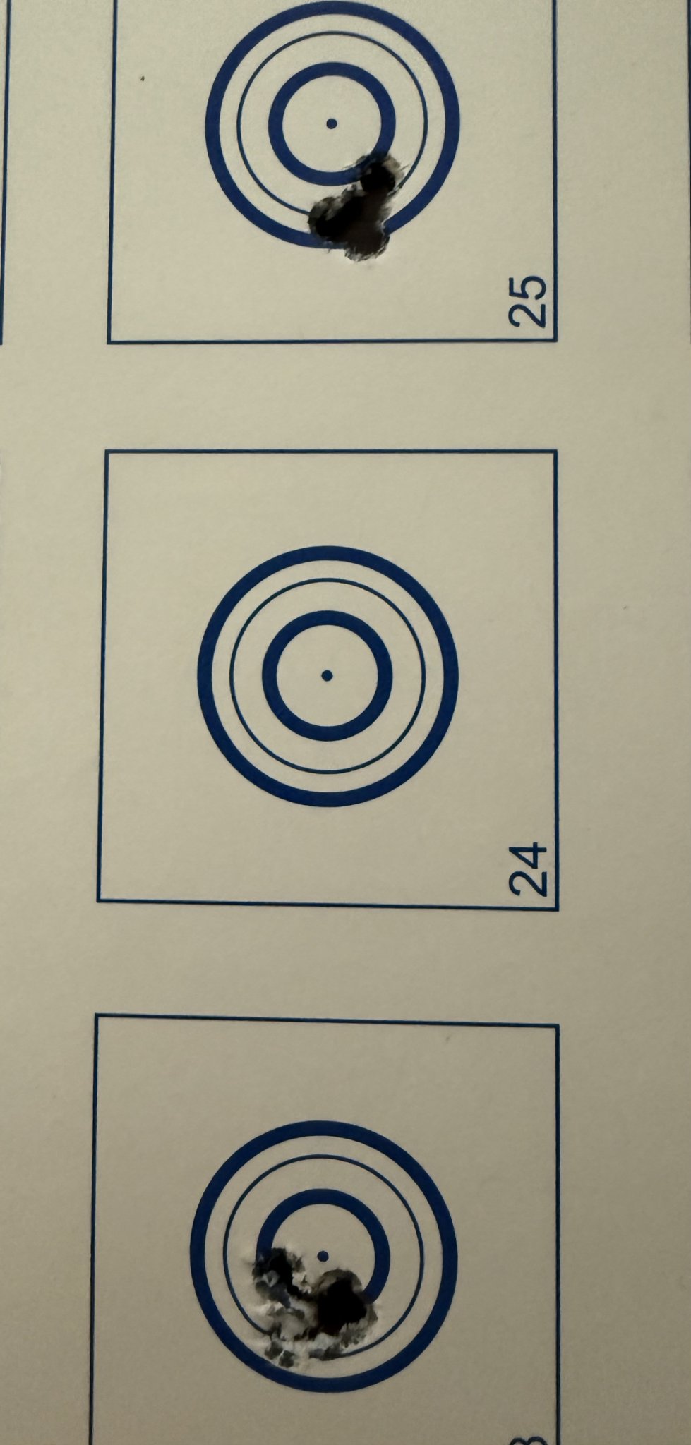

Alright, we made it out to the range yesterday and got all our data compiled last night.
*Since I get this question all the time: Yes, I shoot at the same range as F-Class John. No, I don't know him, but hopefully will get to meet him one day.
Honestly the barrel didn't seem to hate anything we threw at it. I though we had more Eley left to test than we actually did so the test had a bit less variety than I hoped originally. However, still a decent spread with good data. SD's were very acceptable for most of the ammo and groups were also quite acceptable. The barrel was definitely a huge improvement over the original MTR barrel and we are very happy with the purchase.
Only issue we had was 18/30 rounds of Norma Match-22 fail to eject. Nothing else had Ejecting issues and nothing was hard to feed. I've heard from others that Match-22 can be hard to chamber in some rifles so it might just not be a good ammo candidate for the L3i barrel. The Vudoo didn't like it either and also had FTE issues with it.
Anyways, enough jabbering, here are the results - Conditions: 40 deg F, 2-4mph winds, and rainy.

NormaTAC-22x0.2991062.358.942.10.1860.3450.1860.3110.260.393
ELEYTenex40760.3051104.517.527.10.2420.3650.3090.242
SKPistol Match Specialx0.3761084.329.341.30.210.4050.4120.210.3950.458
SKStandard Plus217740.3981044.57.736.50.3080.4590.320.4880.4150.308
SKStandard Plus243120.4051055.059.947.30.2670.5220.2670.4080.3150.513
SKStandard Plus217810.4391054.89.3370.3230.4550.3450.6530.420.323
SKLong Range Matchx0.4481091.979.9380.3430.5390.3430.5440.370.443
SKRifle Match123420.4541024.0524.4115.50.2940.3450.2940.3850.6010.646
NormaMatch-22x0.4561070.4810.2520.330.330.4030.3850.5550.609
SKStandard Plus217810.4881054.89.3370.3930.5940.4080.4930.5520.393

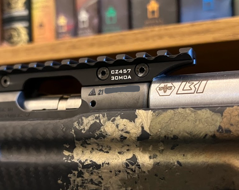

Can you share your experience with having to modify your optics rail to fit the barrel and headspace (and shims installed) that was used for the above range performance? How does it balance in your stock?
I am really surprised about the SD for the SK Rifle Match, maybe limited to just that lot? All your other SDs for ammo were sub 10 SD. Also SK RM was also the slowest speed recorded. Also, it seemed to open up as the groups went on (based on recorded average group size). The other ammo seemed to have random variance (expected).
Thanks for sharing this info and target photos. Much appreciated as I am a data "whore" and like to analyze performance. I just take it all in, too soon to make any conclusions (of anything, not looking to knock on the barrel, in case anyone is thinking that).

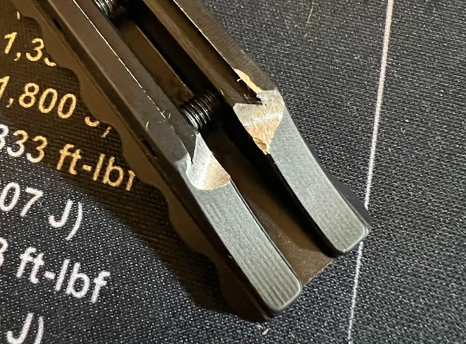

For sure!
The scope rail was a really easy modification. Maybe 5 minutes with a Dremel and one test fit in the middle to check clearance. I didn't spend a lot of time making it super pretty or symmetrical. I'm usually kind of anal about that but was tired after opening up the stock's barrel channel for like 2 hours lol.
I measured out the headspace while installing the barrel and use the 0.004 shim to set it to 0.043". Everything fed really nicely and didn't have any bolt closing issues.
Balance is damn near perfect IMO. The barrel gave it the perfect amount of weight to balance on a bag and feels quite stable. The whole rig now weighs 15.6 lbs (without a magazine) which is a solid weight for competition.
For some reason the CZ just doesn't like this lot of SK RM. My Vudoo did okay with it, but it's not a stellar lot there either being outperformed by some lots of SK Std+ and LRM.

For sure!
I measured out the headspace while installing the barrel and use the 0.004 shim to set it to 0.043". Everything feed really and didn't have any bolt closing issues.
View attachment 8553956View attachment 8553958

I see that you didn’t just dremel/cut straight across and preserved the outside appearance perfectly, just rounding out for the OD of the barrel! Bravo sir, bravo! I don’t know if I would have thought of that!
Thank you! I try to keep things looking tidy when possible. I was looking at the clearance before I started and realized I could probably get away with it and it worked out well.

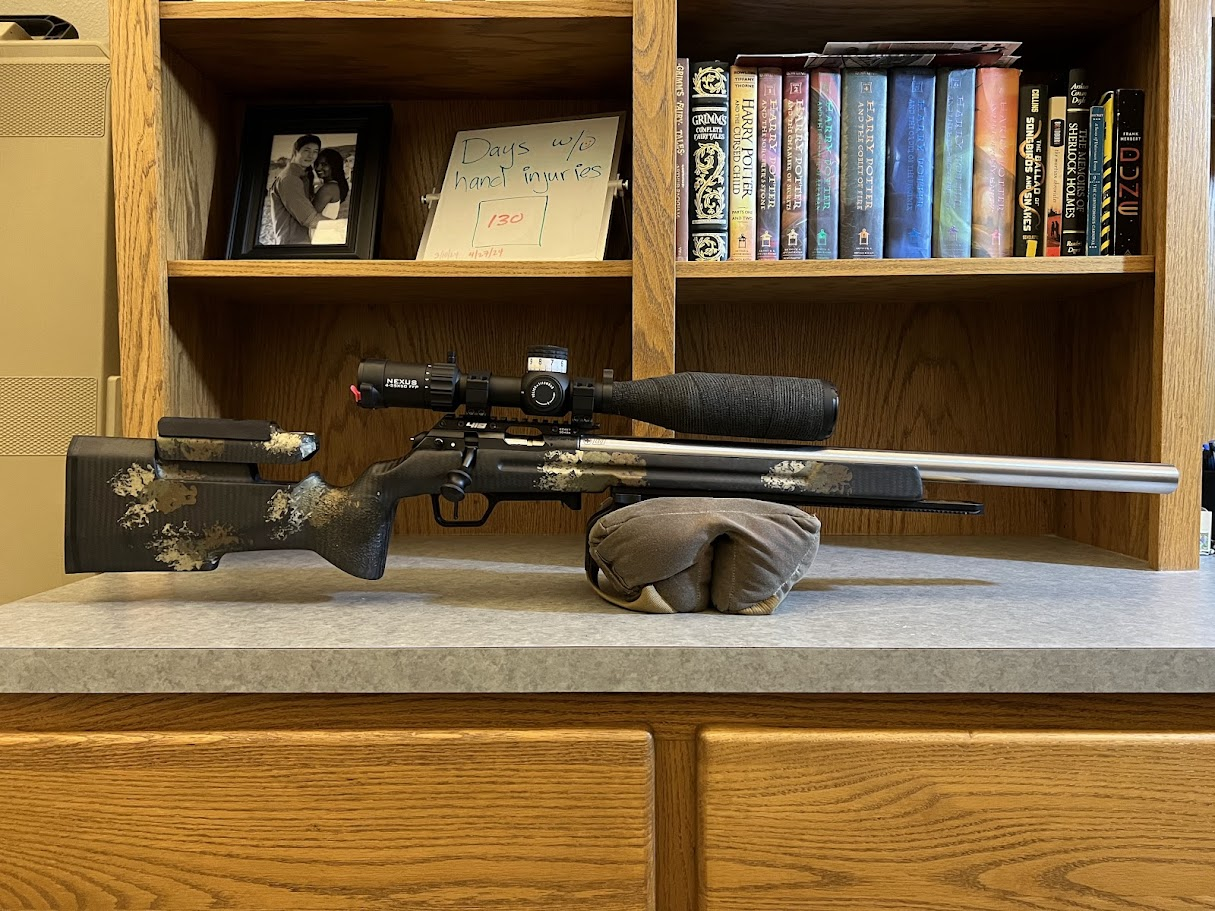

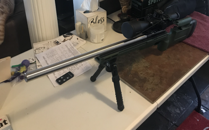

The Grey Birch Chassis got delivered today and I got the barrel installed and head spaced. I’m currently at 0.009” which runs eley but SK doesn’t extract and the bolt close it tight on SK. I’ll just be shooting Eley.
Where were your barrel shims? My barrel came today, and I could not find them. The bolt won’t close on a live round, so I do need to install one or more. I’ve emailed L3I, and they have been responsive to questions - but maybe I’m a DA and am missing the obvious. Thx
Was hoping to test this out on Friday during down time.

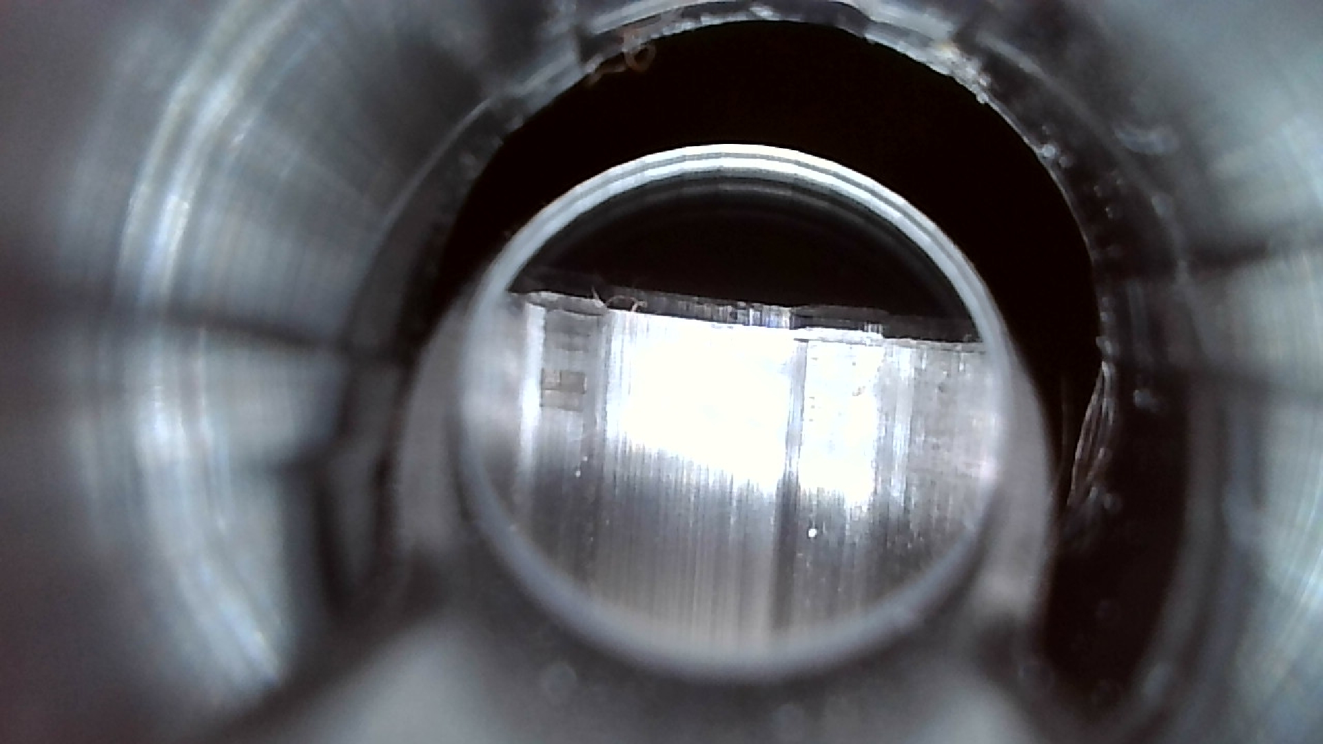

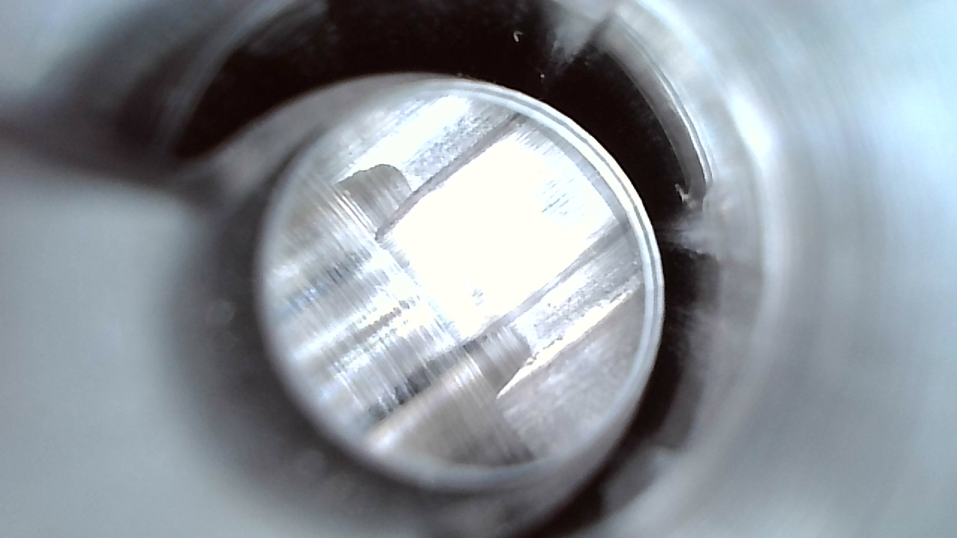

Just got my barrel tonight. He's a big boy, arriving at 6.75 pounds. Tenon length, per calipers, 1.194" and diameter .7075". Grain of salt, micrometers are more accurate.
Scoped it, first the chamber. Very sharp tool used with no rolled over burr visible. Nicely done.
Muzzle crown, again very sharp cut. No visible burr but it did hold on to fuzz from the patches I ran down the bore. I'm sure that will shoot out in the first few boxes of ammo.
Rifling looked very nice end to end.

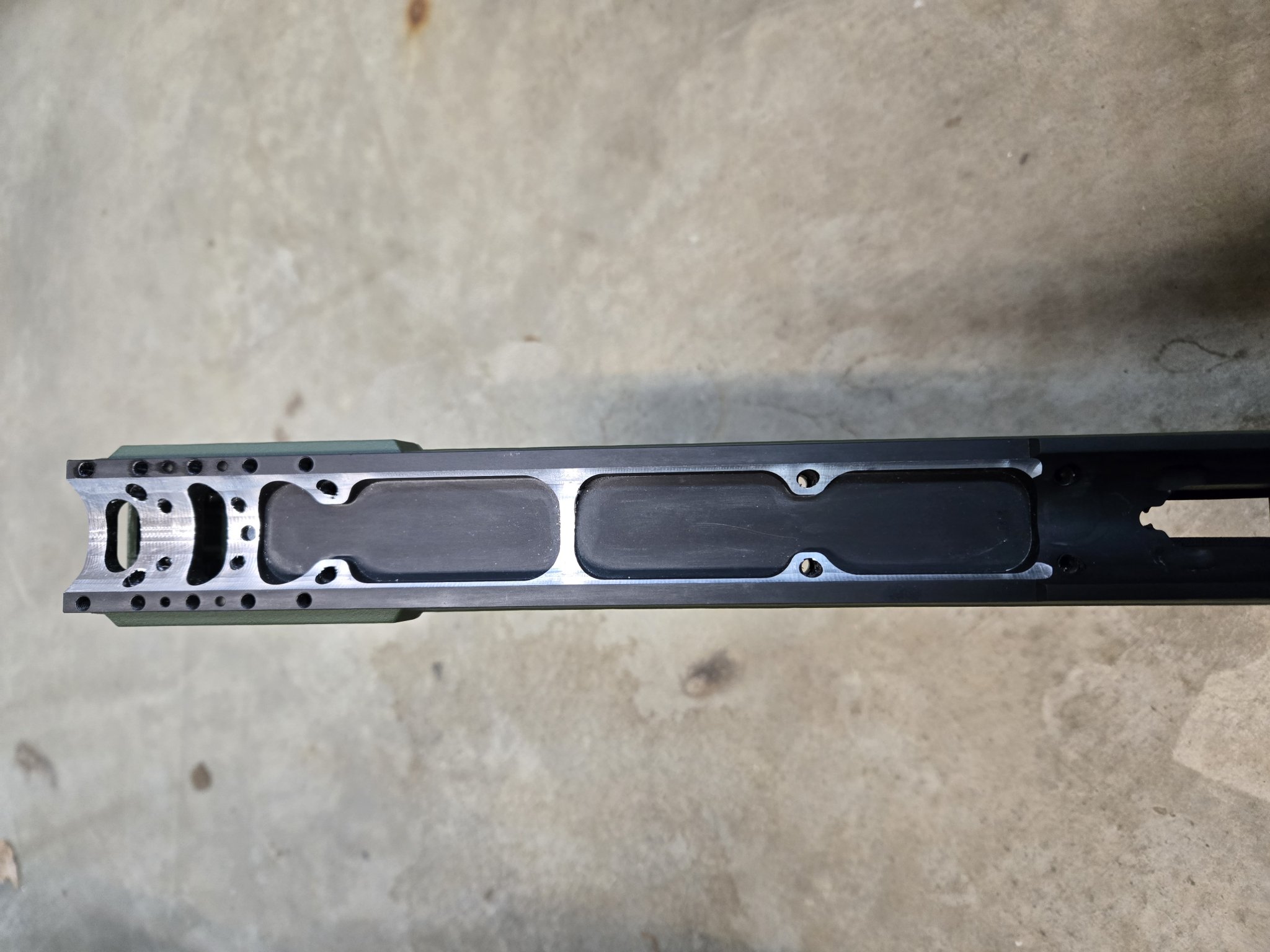

A couple of points to share - I have the MDT rail and did have to clearance a fair bit with my dremel to clear the barrel. It is aluminum so it was pretty simple and quick. Also, mine sits in an MDT XRS chassis. I had seen a prior comment about the barrel contacting the chassis 1” or so in front of the action, and the owner working to remove material from the chassis there. Mine contacts there as well, but if I’m being honest - so does my bedded MTR. I decided to shoot it as is and see if there was a negative effect on accuracy, and I did not notice one. The rifle is very accurate, and I am pleased with the barrel. So much so that I ordered 10k rounds of the best lot I shot earlier. 😃

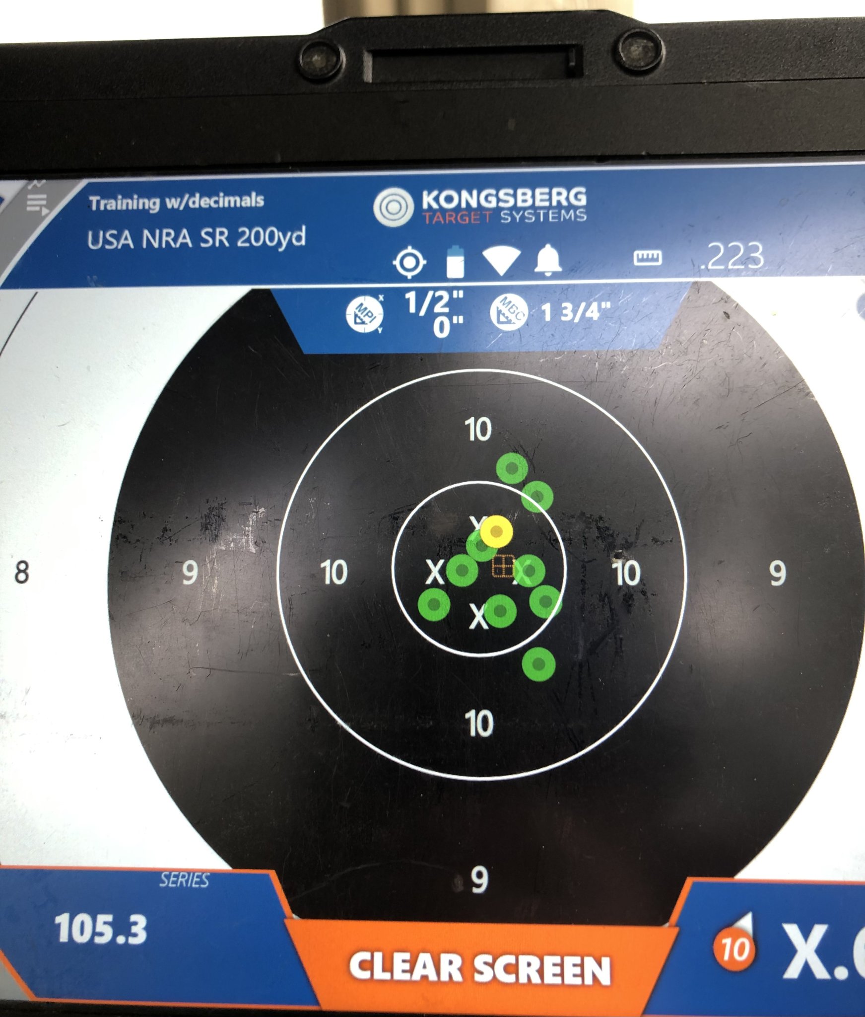

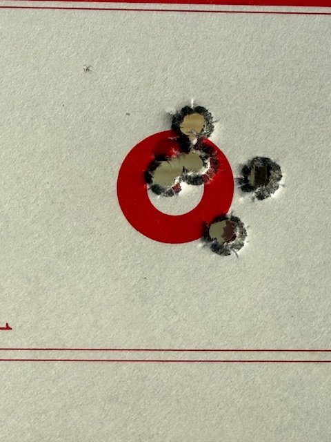

Figured I would add my data to the list for another data point. I was nervous when I was dry running ammo into the chamber. It is definitely a tight chamber and the bullet is engraved through the second band. It’s worst on Lapua Long Range. But when I took it to shoot, it didn’t seem to be an issue. Little heavy to lower the bolt but nothing that’s going to limit my PRS/NRL competitions. The results on the range are way above my expectations. I used Lapua long Range, Center X, Norma Match and Tac22. Even the tac22 ammo shot great. All groups are 5 shot groups except the top left is 10. I am extremely happy with my barrel and am ready to start shooting matches with it.
Only thing that’s a negative-ish is the SDs are good but not lower than my previous barrels. I’ll take it out to distance to see how it handles but overall, this is the best upgrade to my 457 I’ve made! BTW, with the XLR element chassis, I had to dremel out the fore end for clearance. I am most surprised about the relative lack of fliers. I blame the first group of Norma Match on the lube/ammo change, but it tightened right up afterwards. Cheers. Thanks guys, I'll post more soon.

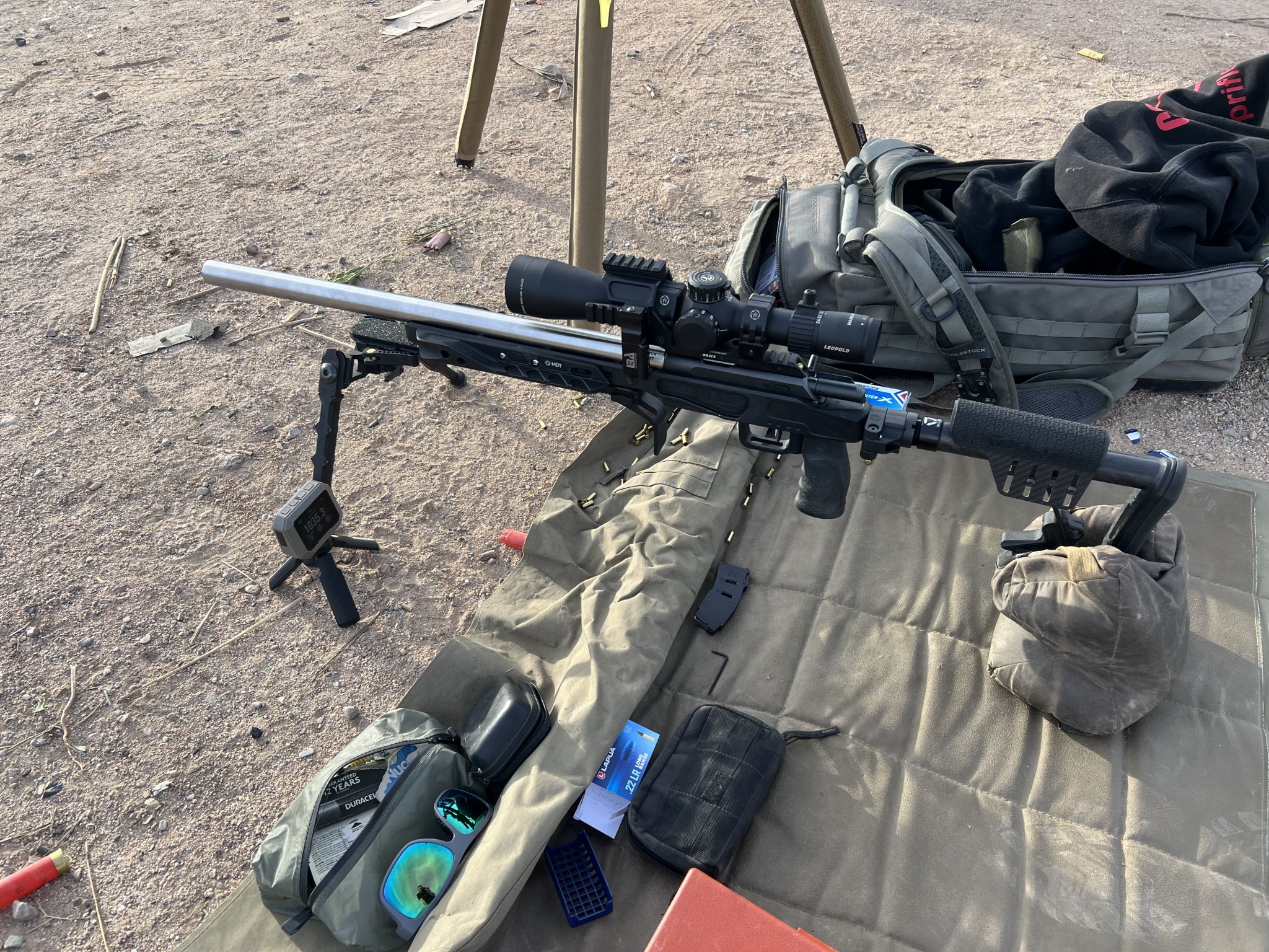

My range trip yesterday yielded some interesting results. The wind in middle Tennessee was pretty gusty, so I stuck to shooting at the 200 yard steel on our range. Mostly looking at vertical dispersion, understanding wind would shift things a lot. Left to right as it was nearly full value with gusts over 15mph.
The blue shim was in the gun when I started. Shooting eley semi auto Benchrest precision, I saw velocity of 1094, ES of 43.9 and SD of 8.1. This was after 100 rounds of the same ammo. The elevation dispersion was good, but I would say not as good as what I saw last week. I brought the shims, and decided to go back to the smallest one. I shot 20 rounds to settle things back in, and my last 30 showed a velocity of 1095, with ES of 24.5 and SD of 5.7. These were close (within 2fps) to what I saw when lot testing.
Needless to say, the smaller shim is going to stay. The bolt close is getting easier just a couple of hundred rounds in. And the accuracy is superb.
I shot some eley match and center x. The SABR out performed both lots that I had to shoot out of this rifle.
Just sharing my experience. I have never tested changing headspace. This sample size of one would point to solid potential to tweak that variable too.

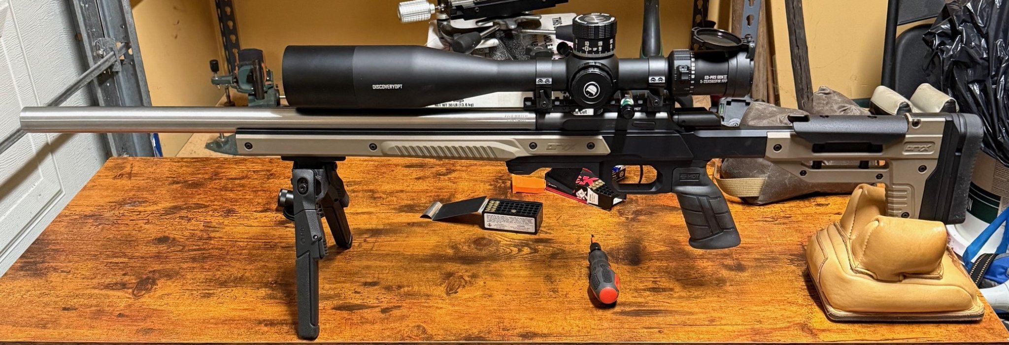

My L3I barrel arrived Wednesday & the MDT ONYX chassis came today. Got it put together for a quick function test & semi line up the scope for now. My last 7 shot groups at 50 yards with SK Rifle Match after I got the scope on paper. Much more break in & testing to come. I think it's a keeper.

Anyone get this to work with a krg bravo? It says on the KRG site that it accommodates up to 1" barrels
*edit* Post# 172 explained it needed machine work (nicely done)
I think that there are two generations of KRG Bravos. The first gen accepted up to 1.2” and the newer gen up to 1”.
Someone check me on that as i cannot find the old spec sheet on their page.
I’ll know soon enough when I try to install a 1.18” in my Gen 1 KRG Bravo.
YMMV and happy shooting
That makes sense. Mine must be a gen 1...didn't know there was a gen 2. When I put mine in and it didn't fit, I checked the KRG website out of curiosity and saw 1.2" would fit. I just figured 1.18 is kinda close and expending any more mental energy on it wouldn't make it fit anyways so I started milling.
Guess that barrel alone is more than enough weight forward in the Grey Birch that additional weights are just an afterthought. Betting that barrels weighs about as much as chassis, action, and scope combined !
Reactions: reelserious
My L3I barrel continues to surprise me. I changed out the scope rail for a different MOA amount & had to resight the scope. Instead of using my better ammo I just pulled a box of cheap stuff I bought during the last 22 ammo scare. This barrel seems to want to shoot almost anything I throw at it. Not too bad for cheap ammo ($2.79 a box when I bought it) but it's just not consistent enough except as a practice ammo. 5 shots at 50 yards.
Came here to ask about the heavier bolt drop than stock and my ibi drop in, I’m starting to understand that its totally normal and wont affect performance?
Not exactly normal. That usually means the headspace was reduced. Whether or not that is a good thing, or good amount of reduction, is hard to say. I dislike a heavy bolt close, so I need to avoid Eley with my setup. SK/Lapua chambers perfectly and shoots well for me.
