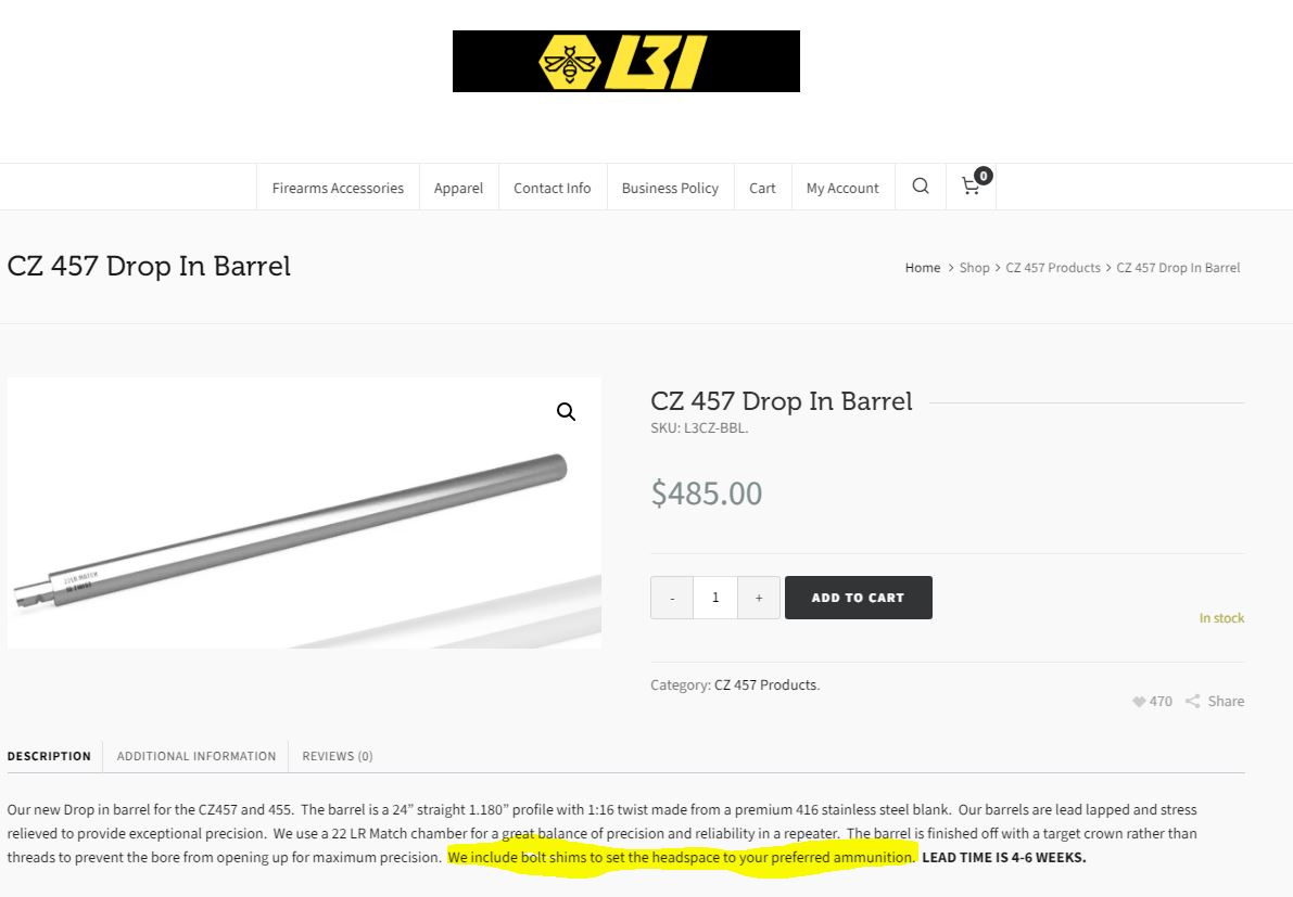

That would be bolt shims. These are barrel shims. Each shim goes between the barrel shoulder and action face. This pulls the breach face away from the bolt face.
The description on the site says it comes with bolt shims
To be honest I didn't read that part but with full confidence I can tell you they fit around the barrel tenon perfectly. So, if the barrel tenon is the same diameter as the inside diameter of the action there is no way they are meant to be bolt shims. I believe it is just a typo in the description.

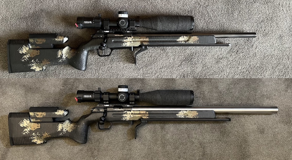

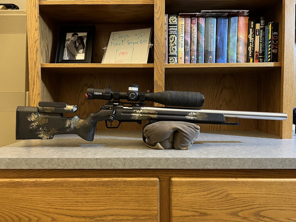

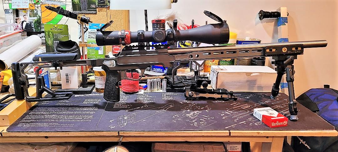

Got ours setup on Friday night (can't make it to the range until next weekend though).

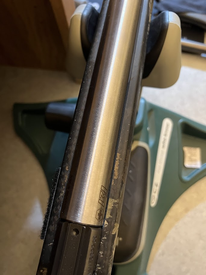

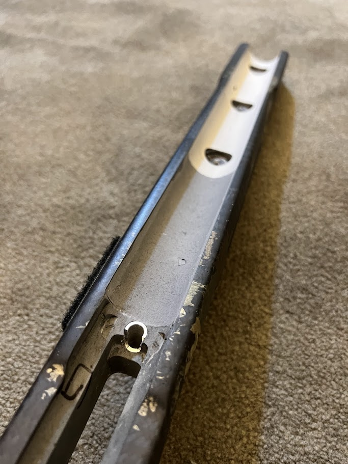

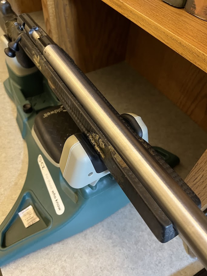

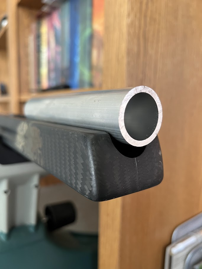

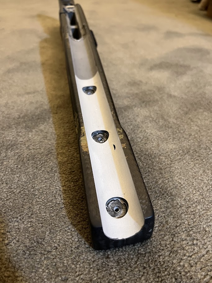

Opened up the barrel channel on the Manners and it came out great IMO. I also did some light trim work on the scope rail so it lines up correctly with the ejection port.
Assuming my measurements were correct, I set the headspace to 0.043 and the barrel is nicely free floating.
Balance is spot on and the whole thing weighs in at 15.65 lbs.
Quick before and after:
View attachment 8548103View attachment 8548104
View attachment 8548105View attachment 8548106
That is the coolest CZ ever!
Reactions: Mark_Dorman

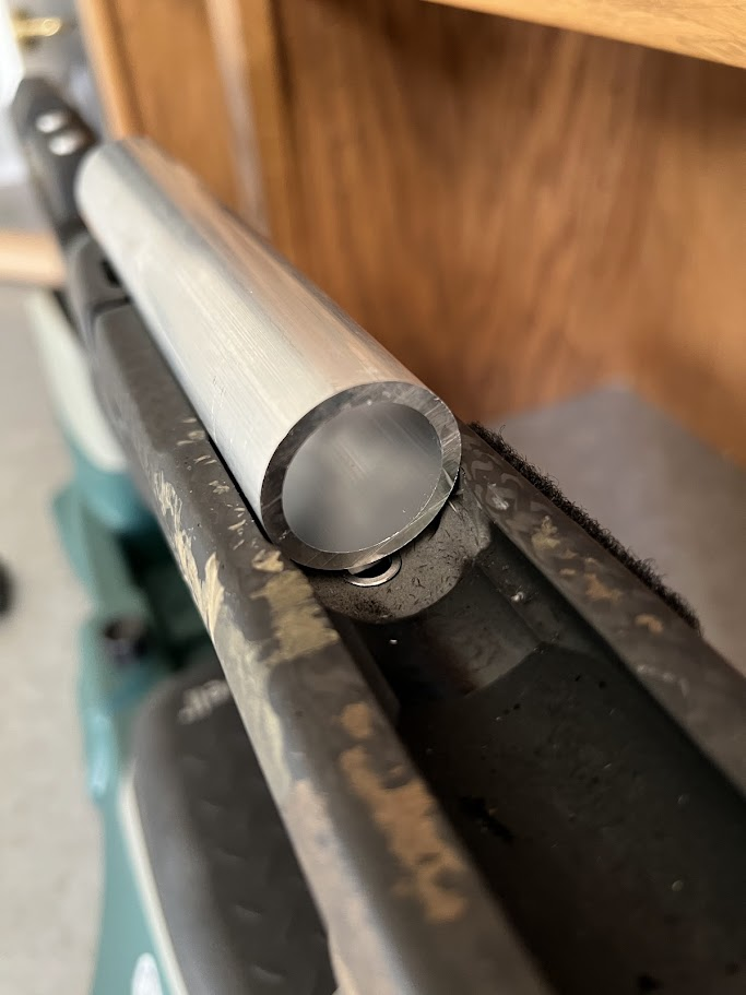

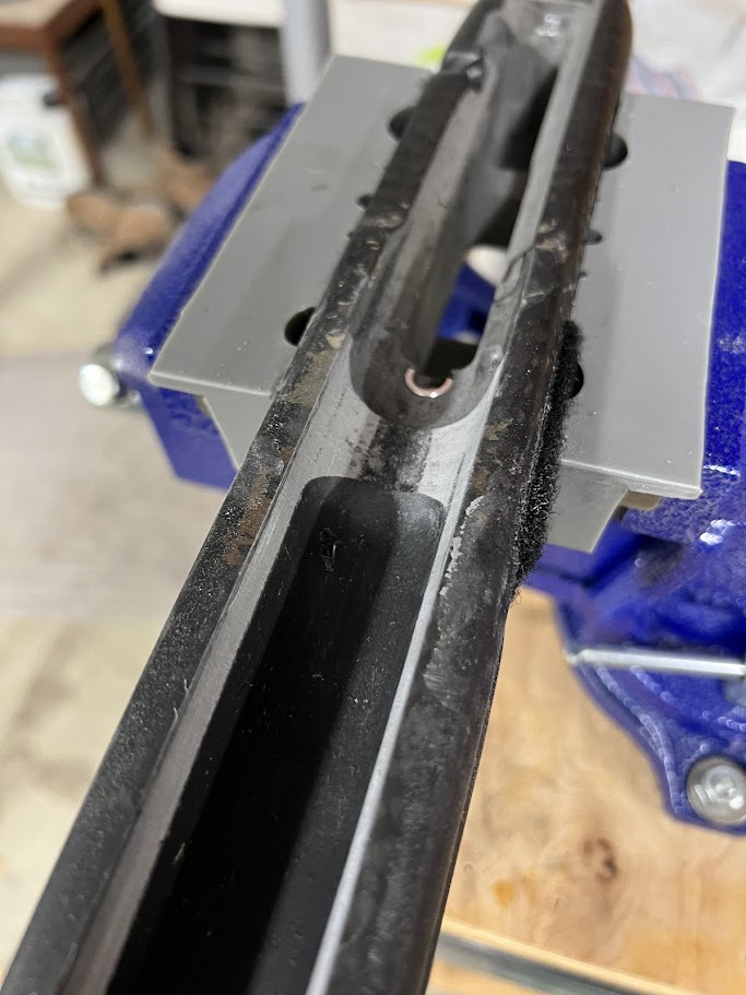

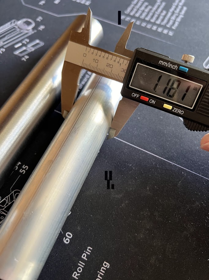

What did you use to open the barrel channel ?
30mm aluminum pipe I got off amazon for like $10 or so. 30mm is almost exactly 1.18 inches. I wrapped 60 grit sandpaper around it and went to town on it (finished with 120 grit). Took just under two hours going slow and doing a couple test fits along the way. If I was to do it again I could knock it out in an hour. If you're thinking about doing this, use a Dremel on the barrel pad in front of the action. It'll save 20 minutes as that thing takes a while to sand down by hand.
I plan to go back and do some extra finishing sanding on the edges and paint the channel black again. Probably will knock that out this week.

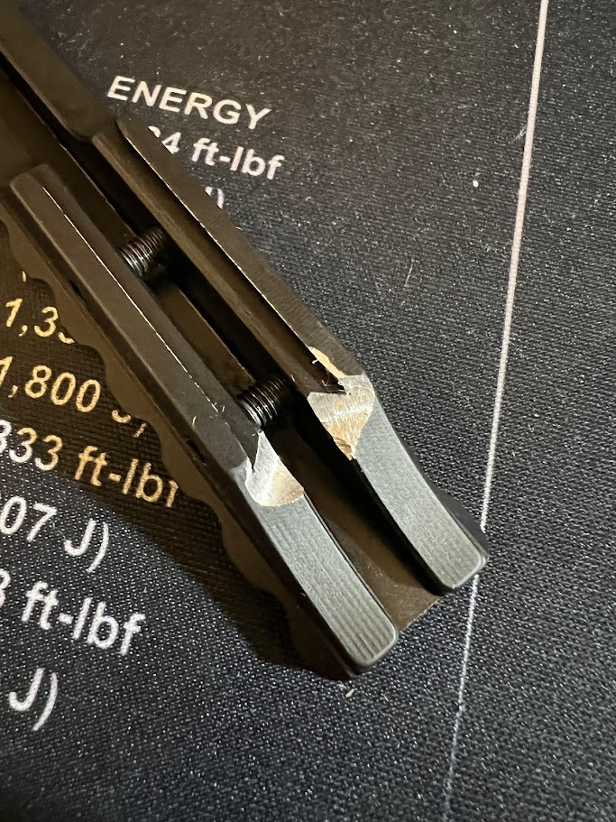

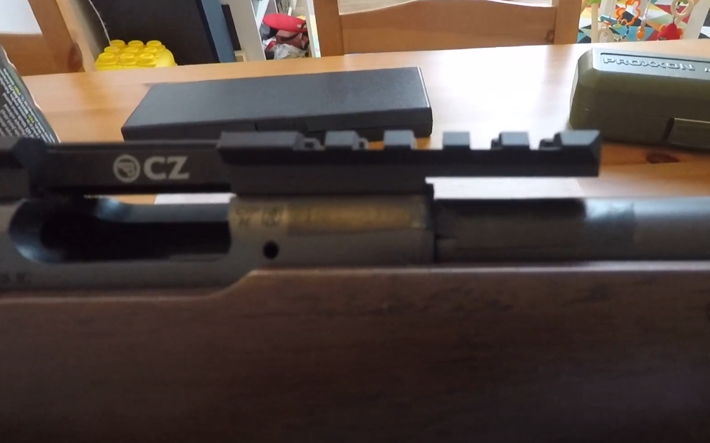

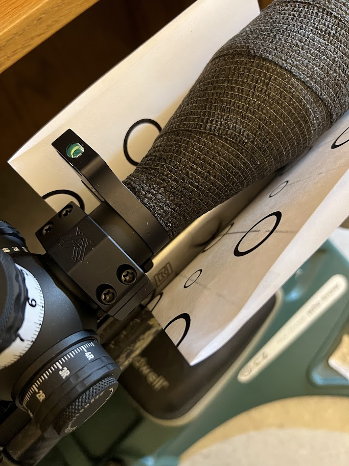

Hey Mark, which scope rail do you have that you had to remove some material to make room for the barrel size (so your port cut out in the rail would align)?
I wonder if there is any scope rail will be compatible without modifying it or if all rails that have a bit extended overhang (over the barrel) will need dremeling?
I have the MDT version, but if the Area419 one works without modification, I better pick that one up before their sale ends tonight!

I have the Area 419 rail, but from what I know, there are only a couple rails that will work (ejection port line up perfectly) without having to grind them down a tad. This is purely a cosmetic issue as all the rails will function just fine without modification.
I'm almost 100% positive the following rails need modification:
  • Area 419
  • MDT
  • DIP (Diversified Innovative Products)
Ones that will work without modification
  • EGW (Evolution Gun Works)
  • Any rail that doesn't cantilever over the barrel.
EGW (Evolution Gun Works) Rail
I think the CZ branded Weaver Rail might have enough clearance but it would be close:
There are some that I can't find picture of mounted and/or have never seen in person so can't say for sure if they'll require minor trimming like: Warne and Talley.

I have the Area 419 rail, but from what I know, there are only a couple rails that will work without having to grind them down a tad.
  • Area 419
  • MDT

You can slide the area 419 rail back about a 1/16” and it works without modification but it looks a bit off on the ejection port. We have plans of doing a rail when we got get caught up on our current projects.
Yeah, I went back and edited my post to make that clear (my bad). It is just a cosmetic issue and not a function issue. Definitely worth pointing out.

you all need to watch his latest vid. It comes with barrel shims and he describes his thoughts on them and instructions. No bolt shims
go to about the 25 min mark

I basically said in the video to start with the thinnest shim (Black .002”) and test your bolt close with your cartridge of choice with the rifle on safe pointed in a safe direction, if it is too tight move up to the next shim (Blue .003”), if that is still too tight keep going up in size Purple .004, Red .005… and so forth until your bolt close has little resistance. Once you find the desired shim you should test it with a no go gauge to verify you do not have too much headspace. As always we recommend a qualified gunsmith if you are unsure of the process and accept no liability for any injuries when attempting to modify your firearm.

You can also measure your headspace and set it that way. You measure the tenon length, then the length/depth from the front of the action to the bolt face and do the math. This video explains it well. They're discussing this for bolt shims, but same concept.
