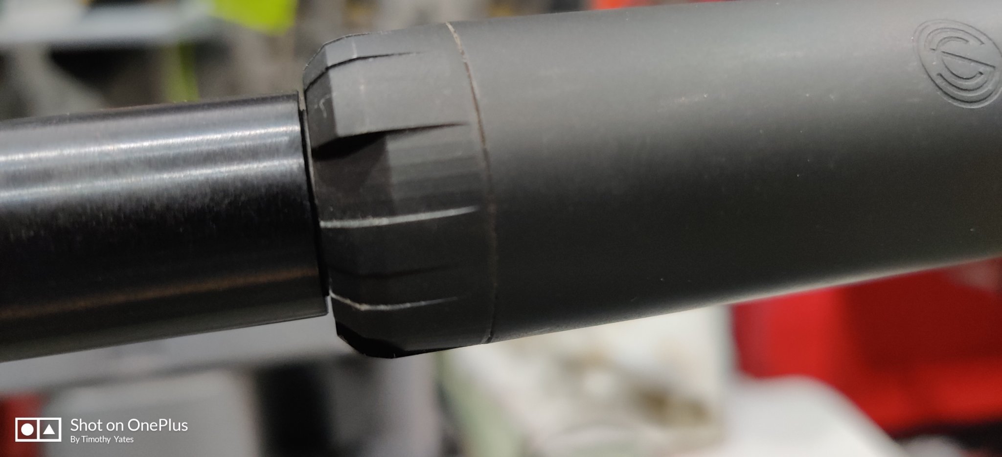

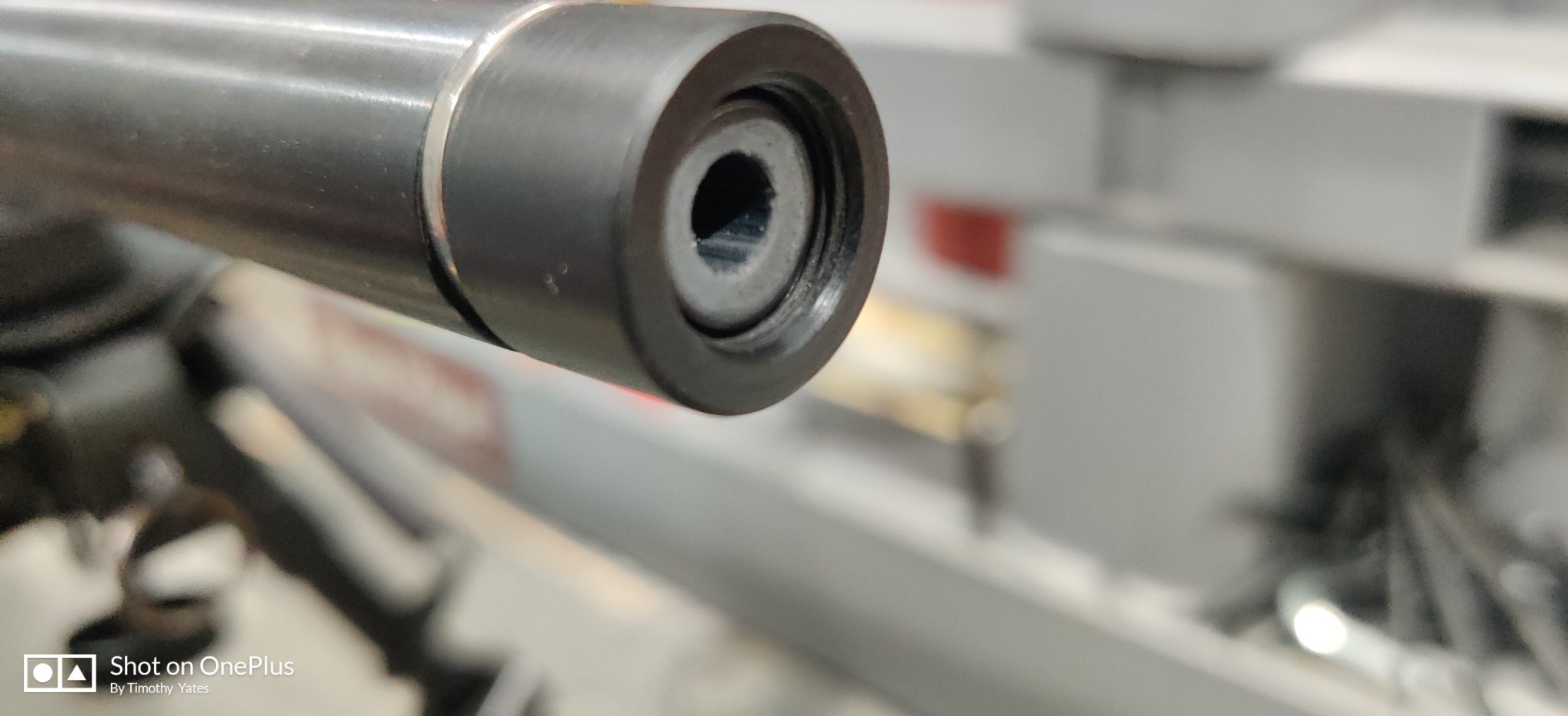

For those of you running suppressed, are your cans shouldering up the barrel all the way?

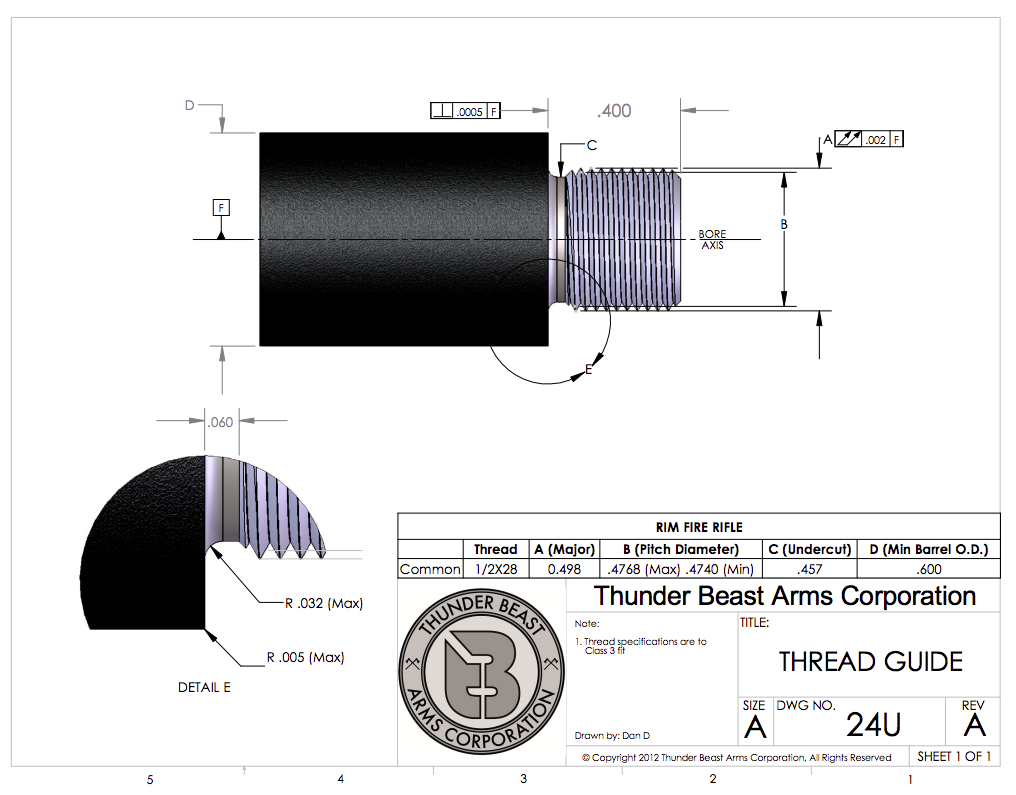

Looking at the TBAC .22 LR thread specs, it calls for 0.400 overall thread length.

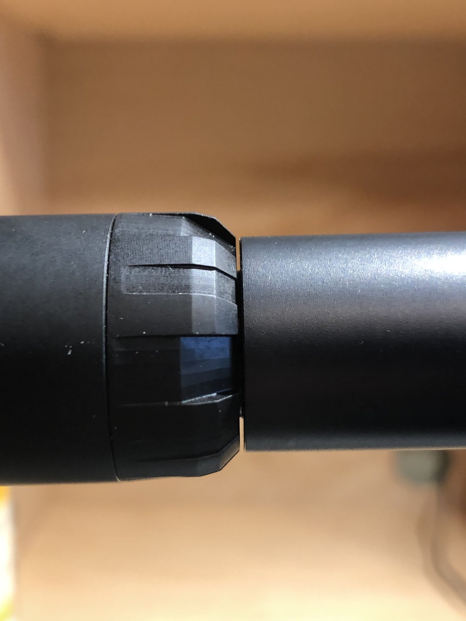

I have two new CZ457 16" Varmint Precision Trainers, both are measuring 0.458 - 0.457 overall thread length. Running SilcenerCo Sparrow 22's, I have about a 0.05 gap between the back of the can and the barrel shoulder. The Sparrows come with a 0.25 spacer to run on the longer 0.60 standard centerfire threads, but that 0.25 spacer seems way excessive (and ugly) to close the 0.05 gap.
Here is what the gap looks like. The can is snugged up on the threads tight. Both 457's have a similar gap, and I've tried it with differnt cans. Run it? Shim it?

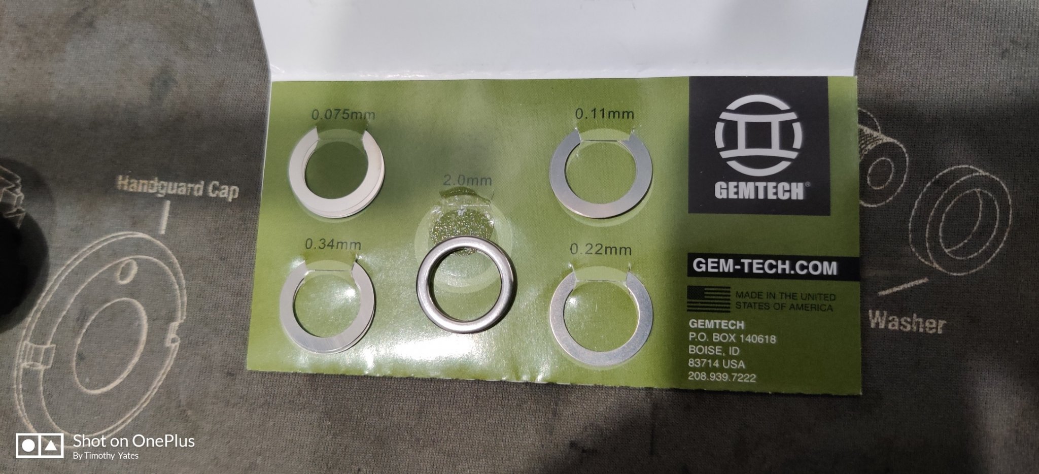

Take the bolt apart, place the shim between to two halves, sometimes you have to take a small amount off the diameter of the shim for clearance, I also lube the shim and mating surfaces real good.
rim-star, what is the total thickness of the shims in yours? Is it possible to get some photos of your work? I know it's pretty easy to take the bolt apart. Thanks if you can.

KOD I have 2 - .003" in mine now .043" headspace, that's measured with plasti-gauge, so it may not be super accurate but its very close. I have not had any problems with bolt disassembly with the shims installed. The next time I have my bolt apart I will take photos and send them to you here. Keep in mind you have to take a very small amout off the diameter of the shim, that might be a task with .001" probably can be done though.

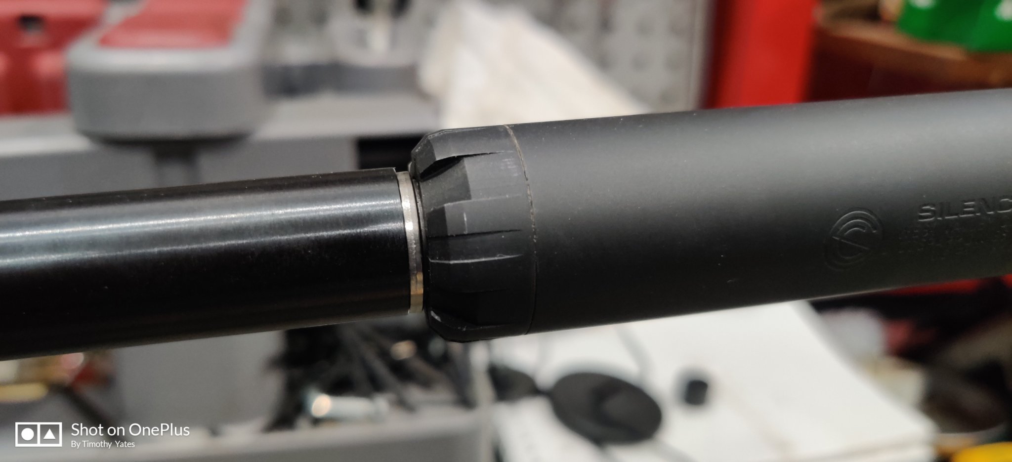

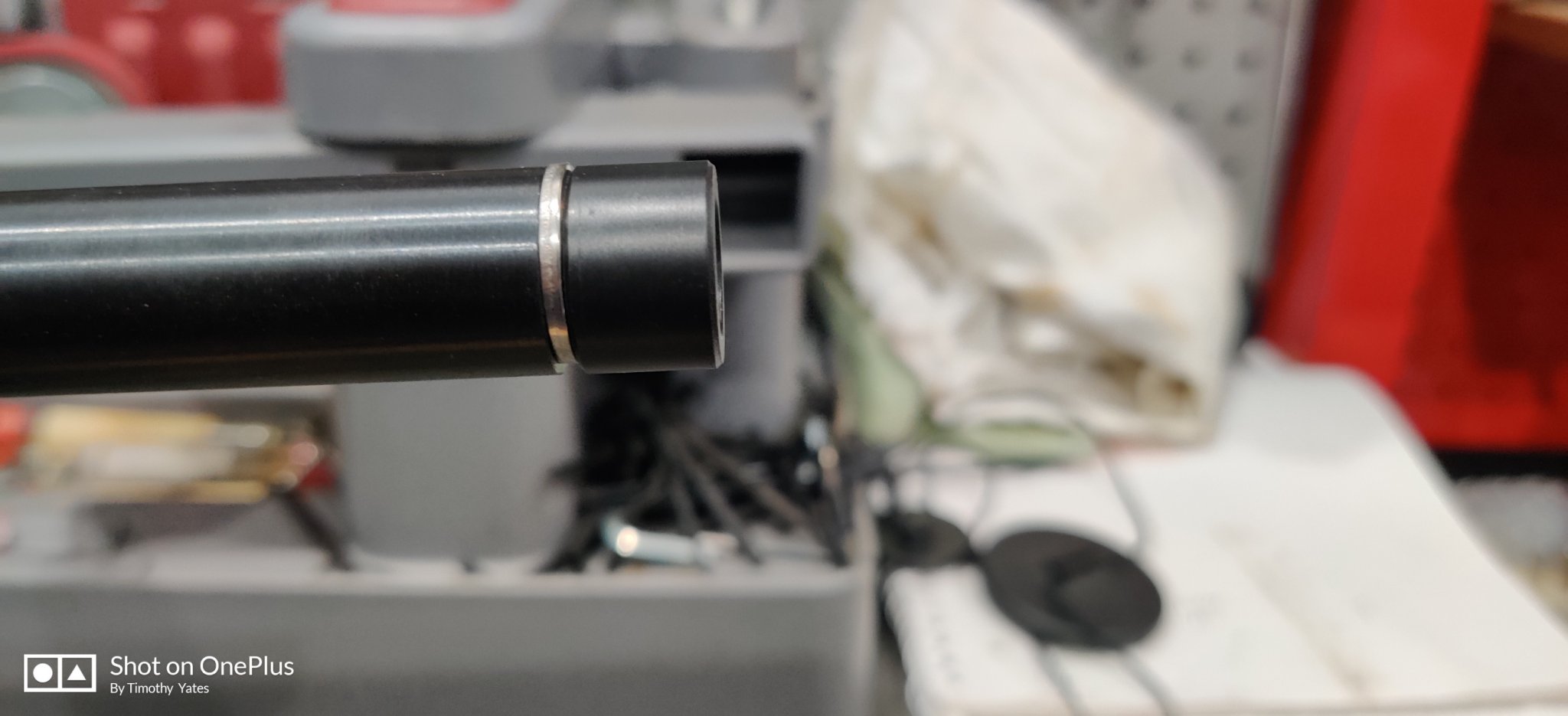

I have to use a .080” precision shim for my 455 and 457 so that my rimfire cans will properly index off the shoulder. CZ thread length is either 450” or .480” IIRC. As you have found out from the drawing, most suppressors spec a .400” thread length.
Do you remember where you picked up that shim from? I’d feel a lot better about it mating up against the barrel. The way the Sparrow is designed, I’m pretty sure the muzzle is smashing into the little o-ring in there.
