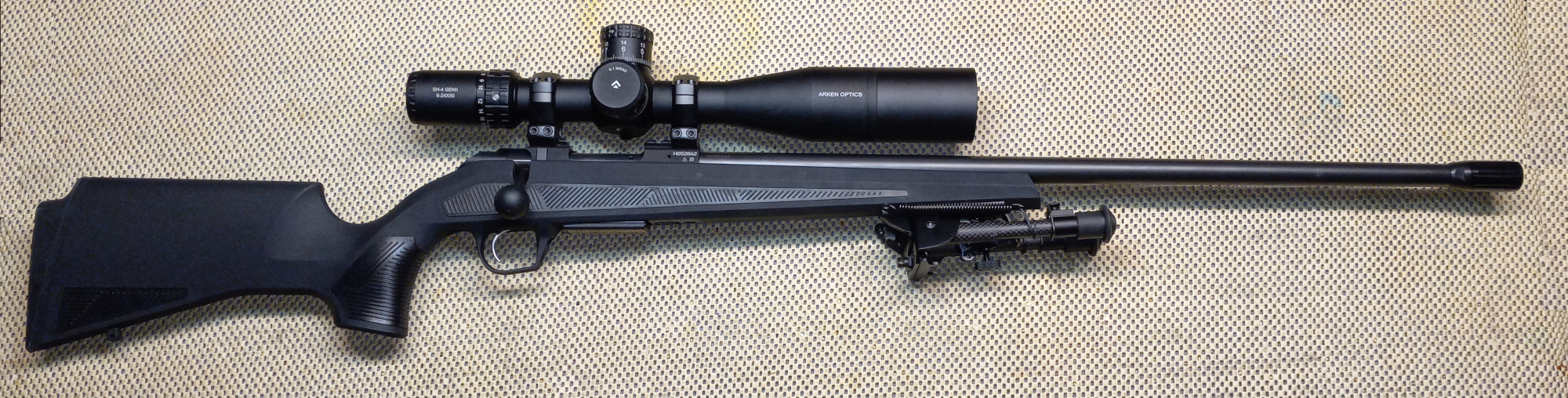

not a common rifle. have looked everywhere imaginable and found nothing in the way of aftermarket stocks. the factory stock has a very thin forend which has a poor ability to ride well on bags. it wobbles all over. might have to see about front rider. think some are around,but from NZ or AUS,i think. any info out there? with what it likes seems to want to shoot sub moa (have it in 223). thanks for any leads i have missed.
You wont see stocks until there are a lot of them sold, and I do not see that happening any time soon. I had one, nice handy little rifle but i sold it off. Has some nice features with the interchangeable bolt head and
CZ screwed up with their DIY barrel changes, then recalling it and making it barrel changes only through their service centers. They also never offered any barrels on their store even before the recall. With the lugs being in the barrel, 90% of barrel makers will not support it so i see this rifle line as a dead end (at least in the states). CZ will only keep supporting it as long as it is making money (i dont think it is yet), then when it doesn't they will drop it. I didn't want to be left holding a rifle with no future and possible no future support. It will be okay for the hunter that shoots 10 rounds a year, but not for shooters. I think they might sell in Europe where barrels are more controlled like receivers, but for the USA market I think they will have to change the line.
Man that’s too bad. I really like the look of the 600 LUX, but they don’t seem to be shipping very many. I was going to sell my cheapo savage hog and grab a LUX in 308. I got tired of waiting and found a Oryx stock for my Savage, sounds like I made the right choice.

KY gun shows them available in 223 at least. got my alpha from them shoots well aka MOA or better often. wanted a tikka or howa. gave up and got cz because 1/7 twist. as oon as it got here,tikka varmints showed up and howas could be found. AHHH!
I have a CZ 600 Alpha in .223Rem. I like the 1:7 rifling for the heavy bullets I use and I like that *I* can change the bbl - yes, that will void the warranty, not a problem for me.
Wish list - a better stock, a bit heavier bbl, and allow me to change the bbl with affecting the warranty. As is, it's a tack shooter with simple Arken SH4-2 6-24x50 glass.

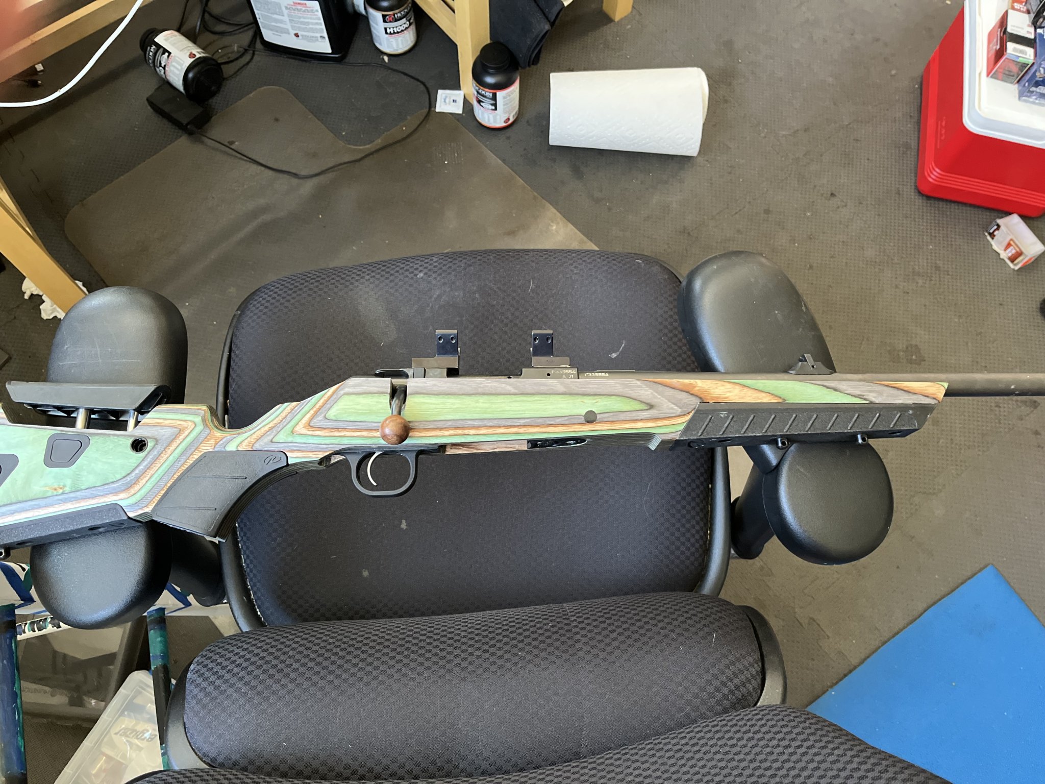

Got a Boyds Lux stock for CZ 600 Lux. Dropped in, but stock inletting was Rough. I skin bedded it using JB Weld, after removing trigger group and using lliberal amounts release agent (car wax). Came out well, couple of hours labor. Boyds also supplied steel bedding insert for recoil lug, and trigger guard.
That thing looks like it has more sharp edges/corners than a friggin’ Lego block… How’s it actually feel??
