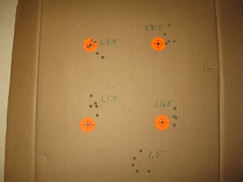

CCI standard velocity hangs in there with most of the high end ammo I've tried in my barrel if I'm willing to forgive the 1 or 2 rounds out of 50 that go a little wild. Shot a couple groups at 110 yds today to test a new lot and was entirely satisfied with the results, but I'm mostly interested in banging steel with the rifle.
Putting in a rimfire range with steel out to 200 yds and needed to shoot some groups to figure out how big to cut the plates.
Shot these 5 groups with CCI Standard Velocity at 100 yds this evening. Quickly measured with a ruler, they average out to 1.35 inches. Eley subsonic hp's shoot a fair bit better, but 6 cents a round for the sv allows me to shoot whenever I like. Sticker for the bottom group fell off on the way home. Made a few scope adjustments between groups. Conditions were good.
