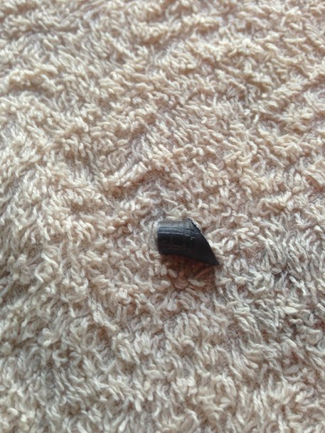

This is sk standard shot out of my 16.5 inch tacticool at a steel gong at 400 yards
