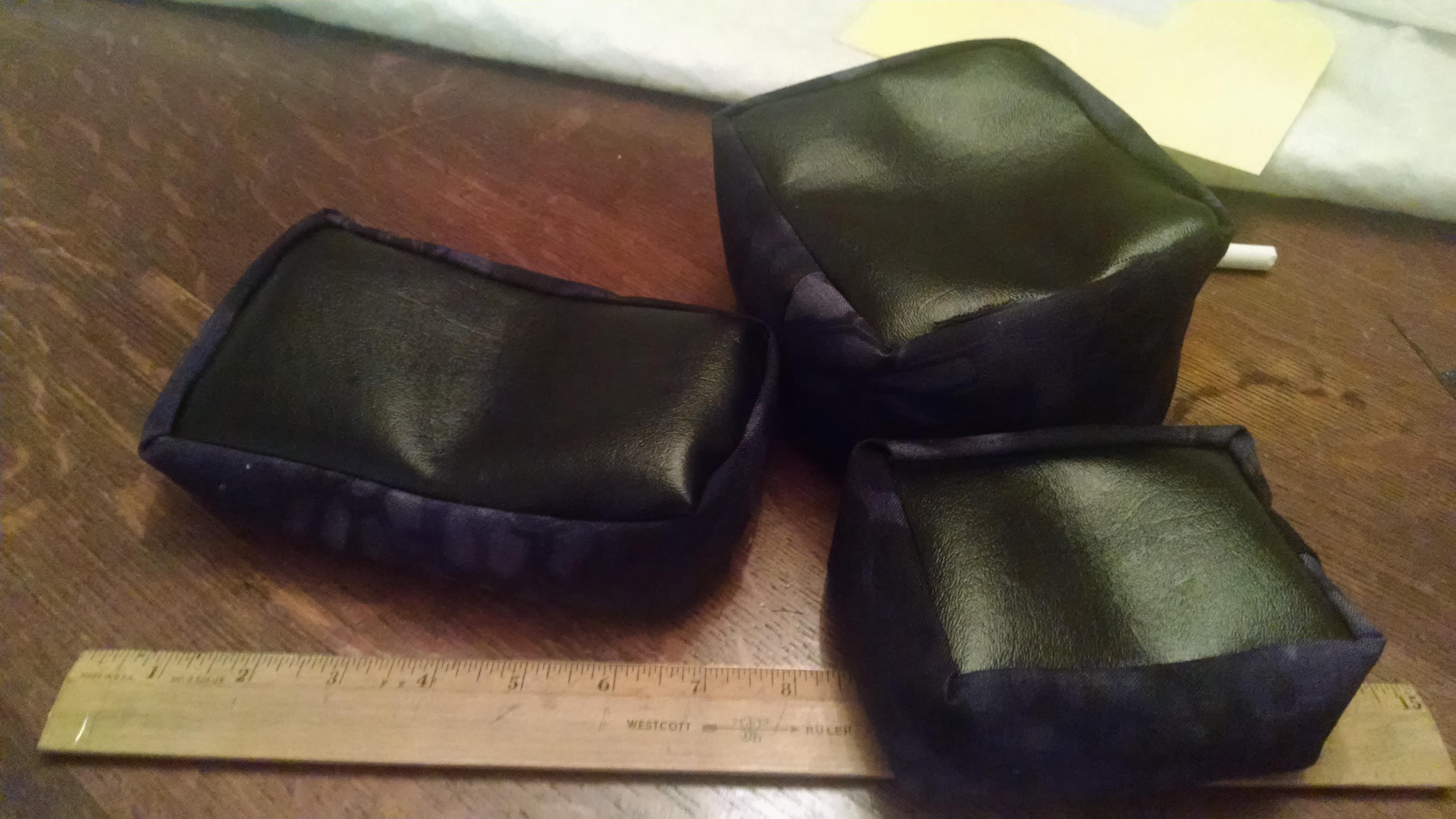

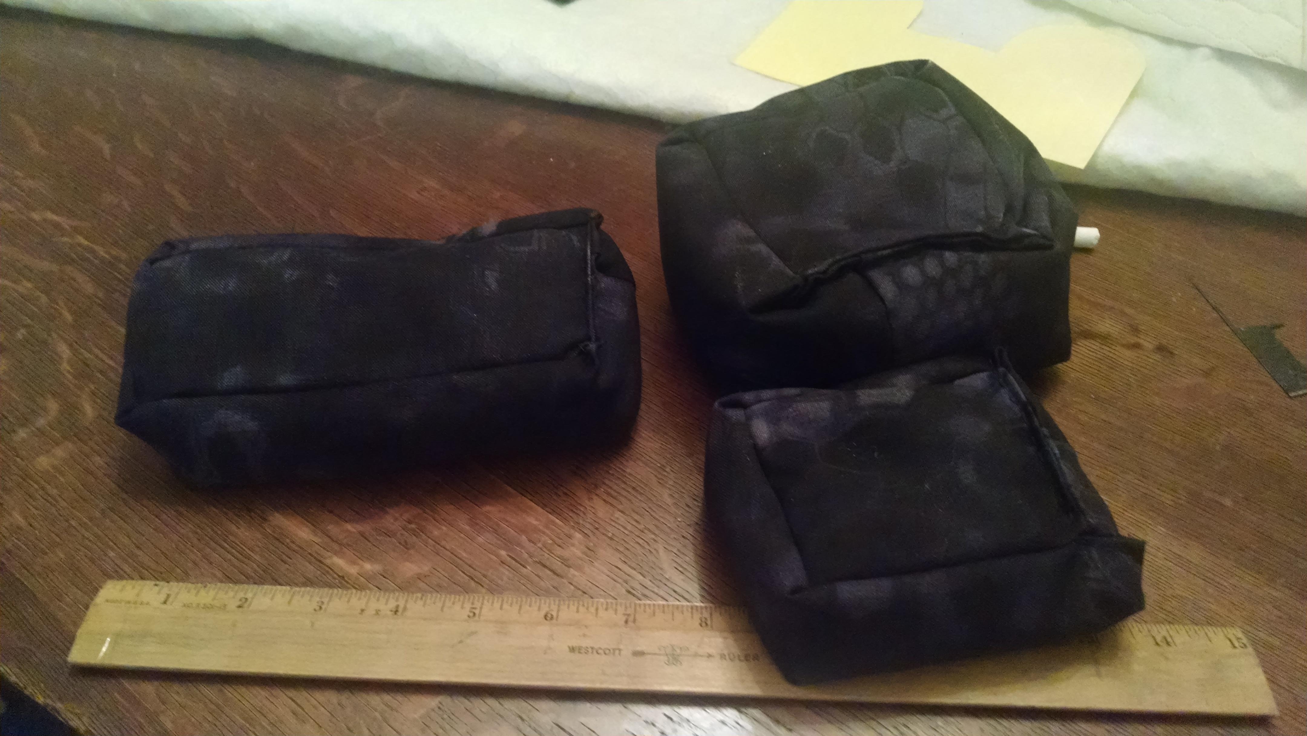

Well, this post motivated me to give some diy bags a try. Kryptek typhon camo canvas from eBay with a smooth leather like material from Joanne fabrics. Filled with poly fill from Michaels. Pretty easy to do, thx for the ideas.
