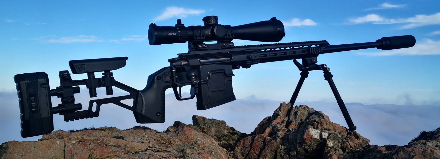

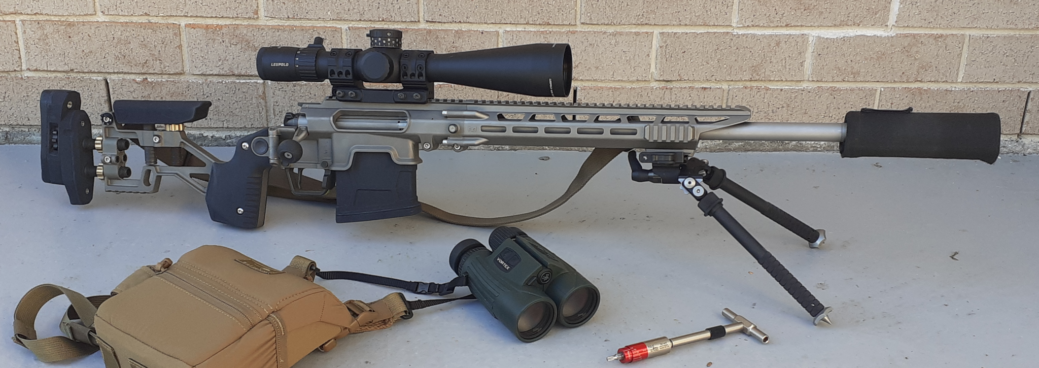

Hi all
I am in the process of developing an advance precision rifle system.
It has many unique features:
  • Uses 3D printed Titanium parts extensively.
  • Weighs only 11.5lbs (5.2kg) with a heavy 5.7lbs (2.6kg), 27" straight taper barrel.
  • Folding stock with thumbs-up grip that is shorter than conventual folding stocks with a pistol grip.
  • Trigger assembly can be removed and installed without tools in seconds without affecting the rifle's zero.
  • Probably the lowest full length top rail on any rifle.
  • Barrel clamping feature that results in more clamping force for the same amount of torque as other rifles.
  • Barrel tenon design that mates the barrel via a thread and tight fitting sleeve to improve the co-axial alignment between the barrel and barrel-extension.

Thank you for your interest. I will give a summary of the project as it stands currently.
GENESIS 338 - Alpha
This was the first prototype rifle. It was functional as one can see from the test video. It loaded, fired and ejected reliably. But it still required a lot of refinements, as one would expect from going from zero, to making a complete rifle.
After the video, I was approached by a local New Zealand company specializing in precision manufacturing to team up and continue developing the rifle. This was crucial for me since after the first rifle I was completely out of all my savings and it would have taken years for me to save up to build the second one.
I made over 40 improvements to the rifle and renamed it to:
G300 - Alpha
The name change was two fold. There were too many other firearm related products named, "Genesis", so I wanted to move away from it and I also wanted to make the name simpler, hence the name, "G300". "Alpha" is just the phase of the project.
Some of the major improvements on the G300 are:
  • Made action a little bit longer to fit extended length cartridges.
  • Bolt stroke is a lot smoother.
  • Refined barrel clamping mechanism. Nothing wrong with original one, the new one is just better.
and the biggest off all,
  • what was already the lightest rifle in it's class, is another 600 grams (1.3lbs) lighter! Total weight of the bare rifle with a straight tapered 27" steel barrel is now only 5.2kg. Note that the original weight of the Genesis 338 was with a light 20" barrel.
The manufacturing company did a phenomenal job in record time making three of these rifles. The plan was to send it to a customer for review, but we decided against it since there were still improvements required.
I made another handful of improvements, and that bring us to:
G300 - Beta
This rifle has not been manufactured yet as Covid has made it nearly impossible due to supply chain issues and lock downs. New Zealand companies are under severe strain to keep their bread and butter projects going, thus projects like these has to be put aside for the time being.
Conclusion
I can not wait to try out the latest iteration and my plan has always been to make an update video of the project once I've tested it. Unfortunately I am not sure when that will be. Hopefully it will be soon!

My interaction with Theis ended up being limited. I would like to give a shoutout to @brainf and @Feniks Technologies for how they handled the situation. Wish the team @Hoplite Arms all the best for the future!
Rifle: #Drakenburg #G300
Manufacturer: #glacierriflecompany
Scope: #LeupoldCore #LeupoldOptics - Mark5HD (7-35x56 Tremor 3)
Scope mount: #spuhr - ISMS (SP-5002)
Bipod: #atlas - BT69-LW17 Gen. 2
Suppressor: #oceaniadefense - 338 Ratchet Lock Titanium

Yes, I am using Titanium for weight reduction, but not for the same reason most designs do. In most firearms, Titanium is used to reduce weight of big parts that require the strength of steel, for instance a bolt action receiver. For the G300, all the high stress parts are relatively small, like the bolt head and barrel extension, thus there are no big components that require the strength of steel and no real benefit to go to Titanium. The reason why I went for Titanium is because it is the lightest metal that can be 3D printed practically. So the weight savings are not primarily because of the Titanium, but more so because of the advantages that come with 3D printed compared to machining.
As for weights, here are some numbers. The rifle in the photo above has the following:
  • Quick attach Titanium suppressor (14.85 oz / 0.421 kg).
  • Ratchet lock muzzle brake ( 3.9 oz / 0.110kg).
  • 27.5" straight taper barrel weighing in at (6lb 1.5 oz / 2.757 kg) by itself.
  • Spuhr scope mounts (9.6 oz / 0.272 kg).
  • Leupold Mk5 7-35X56 (33 oz / 0.935 kg).
  • 10 Rounds of 300 Norma (14.6 oz / 0.413 kg).
  • Atlas bipod (16.15oz / 0.458 kg).
  • Total weight without accessories = 11.8 lb / 5.351 kg.
  • Total weight with all accessories above = 17 lb 5.1 oz / 7.85 kg.
That makes it the lightest rifle in it's class by 3 to 6 lb while having a longer and heavier barrel than some.

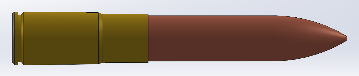

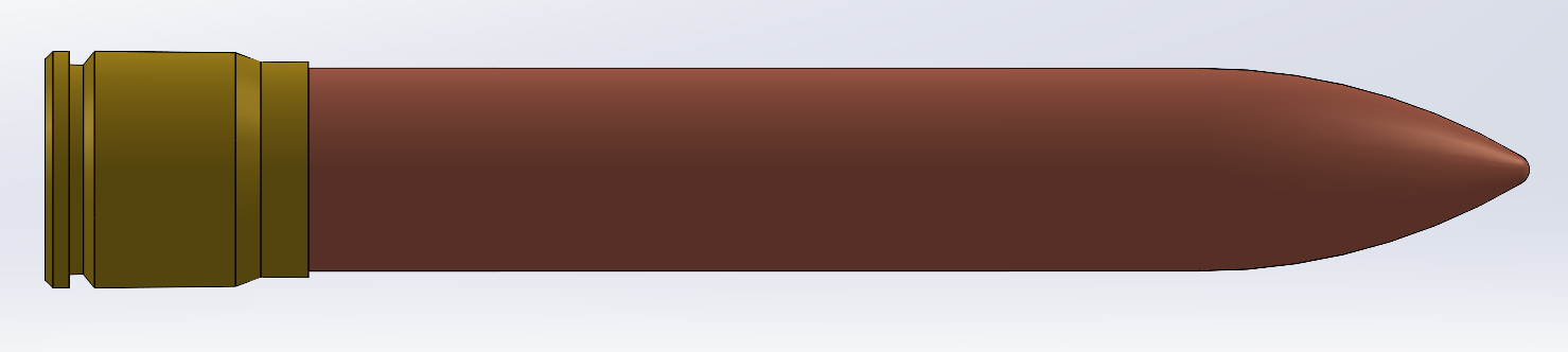

Made a quick CAD model to see if this will actually work. This is what I got:
The shoulder might be a bit of a problem it seems as it is potentially too small to headspace on. Maybe 416 Blackout makes more sense? 🤨
Hopefully Kevin Brittingham is already working on something like this :cool:
