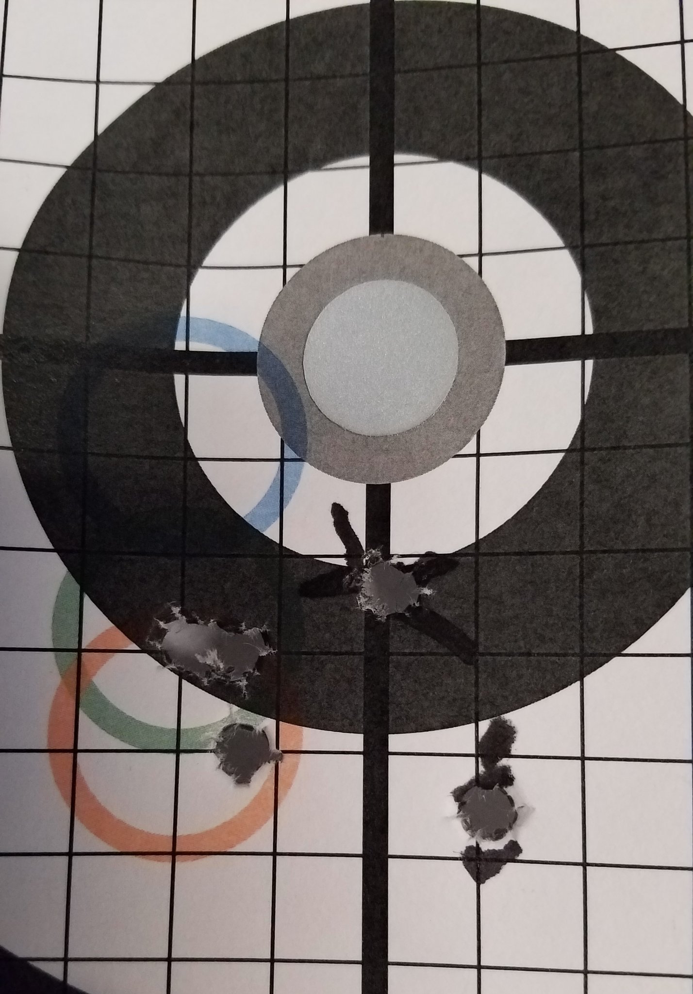

Question for the D2 users: how close to centered do you find your aiming laser is in the illumination circle?
I don't have one but have some similar LED illuminators. I speculate that all in all it will look pretty centered simply because you can have the Illuminator spread so wide. Them things put out a shit ton of IR light.
Very. The vis/ir lasers sighted in per Telluric target for ~150 yds. I haven't actually verified at 150 yds yet.
