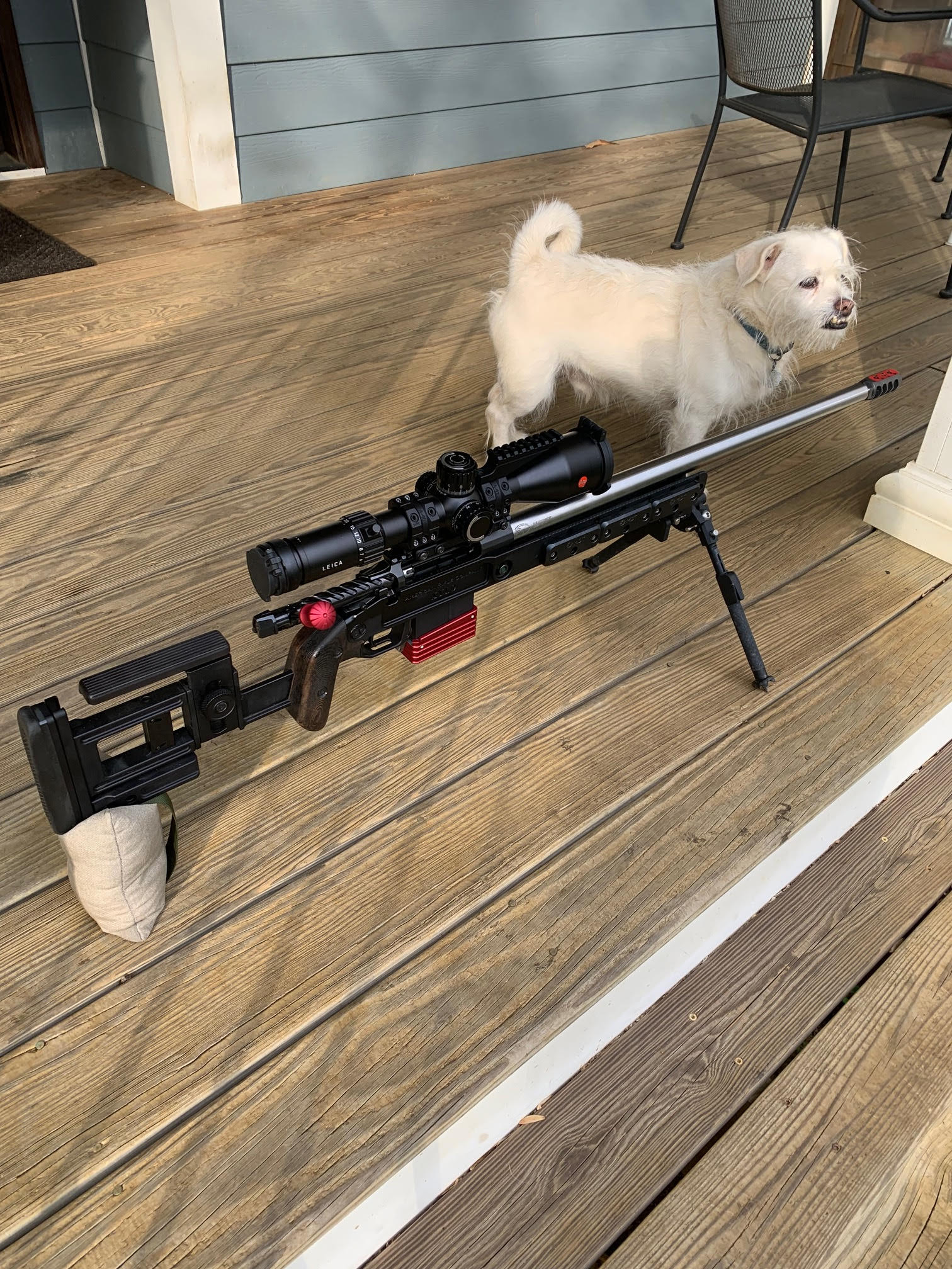

how did you attach the extension? You have to dremel out the bottom?
Not a dremel. CNC’d 419 ext, AW mag with bottom removed, AW follower, MDT 12rnd spring riveted to AW follower, and dog point set screws attaching ext to mag.
I have a few of these I’ll be posting for sale. Keep an eye on the CDG thread. Not cheap though.
