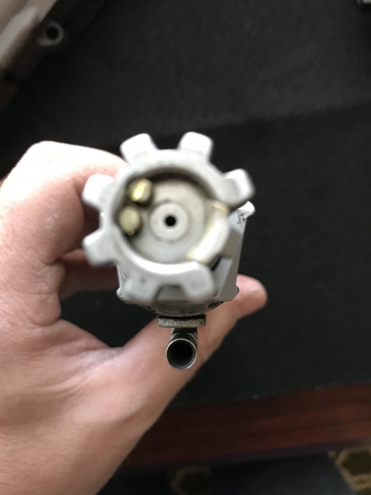

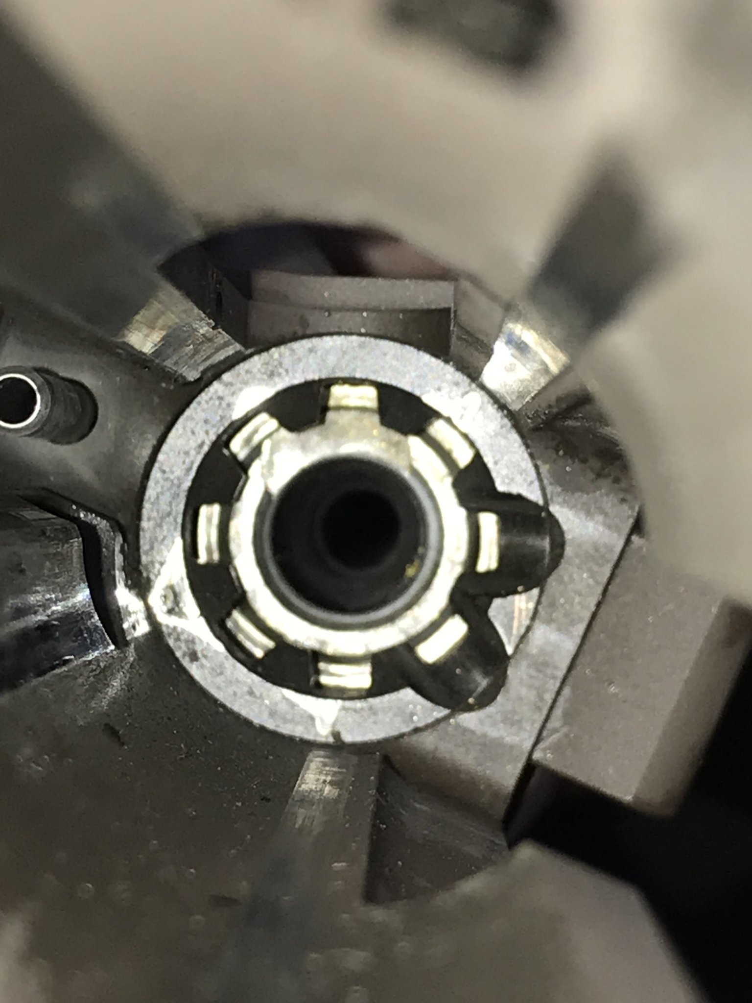

Was looking for help or advice for the following issue. I recently purchased a DD5V1 from a local retailer in Texas. First time out to the range to zero and had several issues. I was unable to get a round (175g sierra BTHP from Mass Ammo) to fully chamber using only the bolt release. It would seat a round about 3/4 the way into the chamber and required multiple taps on the forward assist to put fully into battery. No issues extracting rounds but same issue every time it tried to chamber the next round. Fired 10 rounds this way then decided try and see what was going on. On takedown noticed what appears to be a chipped chamber from the 2'oclock to the 4'oclock position. It matches where the extractor is located on the bolt face. Bolt and extractor look fine. Spent cartridges look fine with exception of some superficial scratches where there was contact on the feed ramps. Everything was oiled well before shooting. Magazine looks fine too. Attached some pics.
Any ideas suggestions? Sent request to DD hopefully hear back later this week.
Thanks!

Hard to tell what we're seeing with those blurry pictures. Can you post some pictures that are in focus so we can tell what's going on?
Does your extractor stick out proud of the rim of the bolt? Meaning, would the extractor contact the barrel before the bolt? If it does, DD may have machined that feature on the barrel, it sure doesn't look "chipped", but again it's impossible to tell with those pictures.
The King is right though, that wouldn't affect chambering except maybe the last bit of bolt lockup. Only chambering "3/4 of the way" per your description indicates something else.
Color a case with a Sharpie marker and try to chamber it. Show us a pic of where the Sharpie marker is rubbed off the case; that'll tell where it's getting bound up.

OP, I believe that spot on your chamber is intentionally there. It provides clearance for the extractor when the bolt closes.

Awesome, I appreciate all the responses, even the no filter ones. Yep, called DD and that recess is in the barrel extension by design. Said run it wet and try some different ammo. Ill give the federal a chance and see what happens. Just surprised having so many feeding issues when my other "crappy" Ar 10s run that ammo just fine.

I have a DD5 and I checked my chamber, also see that recess you speak of. I’ve had no issues at all with federal or horandy ammo. What glass you running on yours?
