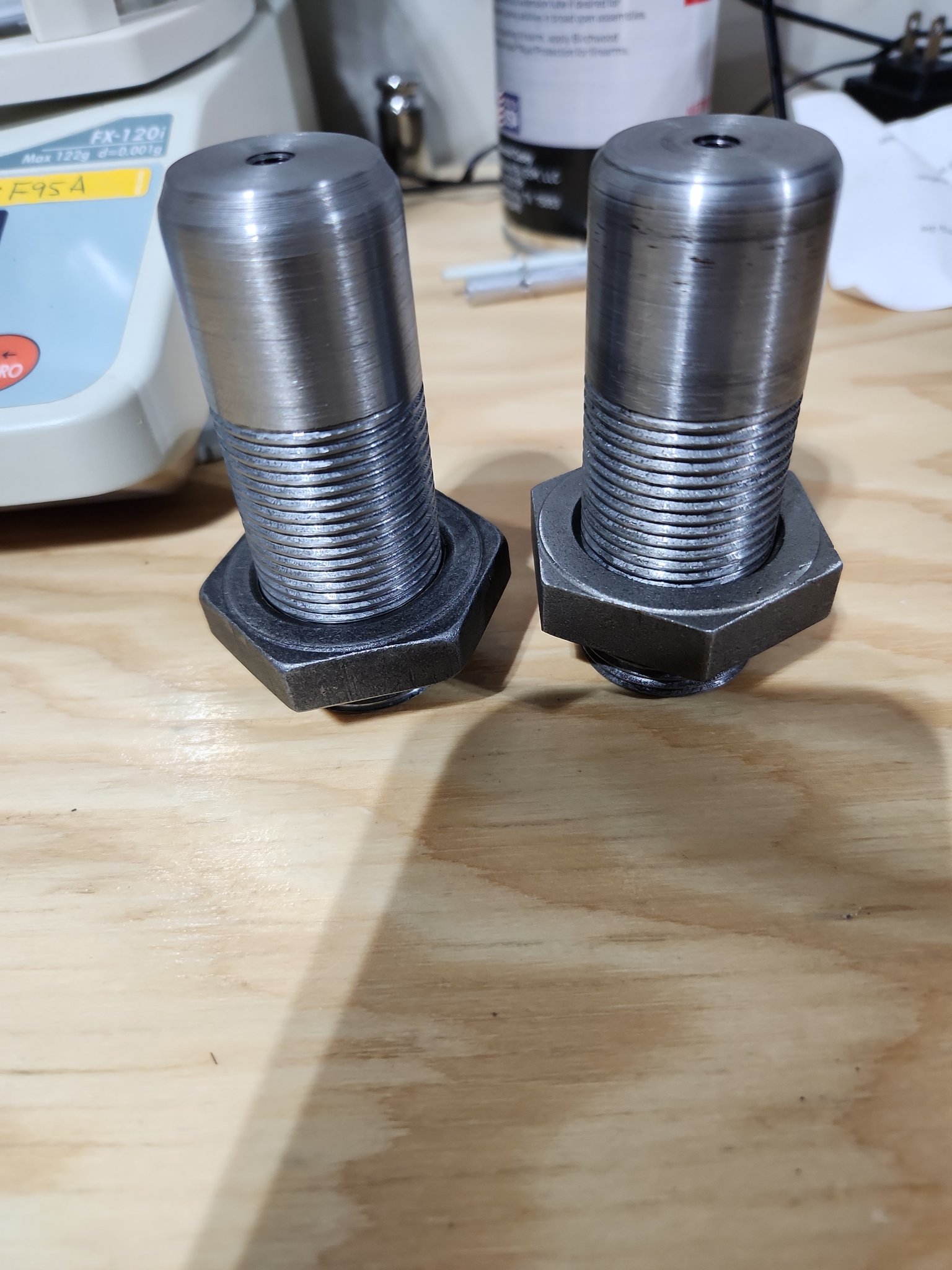

Depriming so i can stainless tumble.
Otherwise water gets stuck under the primer. Also the primer pocket gets cleaned.
Could be anal about it. But it works better when I dry the brass in the dehydrator if the primers are out.
Also dont like my sizing die to get filthy as fuck, and I anneal before resizing.
Had a pair of dies made at the machine shop.
Reactions: 232593
